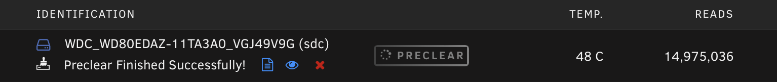

The pre-clear process of that HD 9V9G with all those CRC errors just ended.
1228818604_ScreenShot2022-01-24at7_28_29AM.thumb.png.dcf16723e6524e8dcfdfe12b26582f8b.png
I am thinking I need to give it another go. I've changed the Sata cable for this drive with a new one. This drive is connected directly on the motherboard..
Not sure I understand. Was that drive assigned as disk5? And then when it had connection issues you unassigned it from the array so you could preclear it?
No no. Sorry if I confused you there.
I had a 4TB which was not working properly and I changed it with a new 8TB I had spare.
When I tried to add the 8TB (9v9g) the first time I got 2000~ CRC errors. So I changed the Sata cable with a new one. And I did preclear of the disk before I add it to the array.
Now its rebuilding parity and I can't see any errors.. So I suppose problem seems to be solved :)

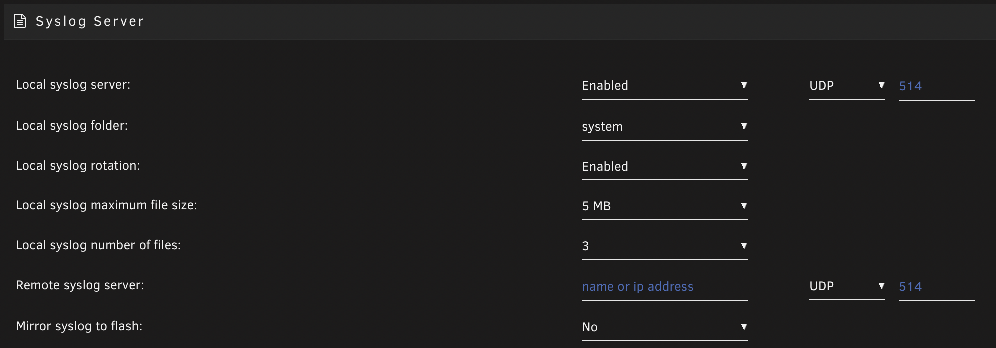

Ill enable syslog server and will see next time! Thank you!
It's ok this way?
2057651506_Screenshot2022-04-06at9_23_13PM.thumb.png.718c19425bc150121e7d9636fa4ff457.png
You have to specify the remote syslog server, which can be your Unraid server itself.
On the remote server field you mean?!
