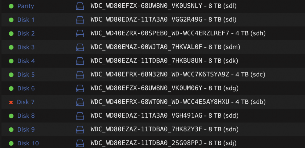

  • 6.9.2?   Your screenshot shows the array started with no disks missing. I think you must mean that disk8 is not assigned. A missing disk would be indicated by a red X and its contents would
  • What do you mean "fix Disk 8"? Since it isn't missing, do you just mean that you want some disk assigned as disk8 so there isn't a gap?
  • Try refreshing the page.

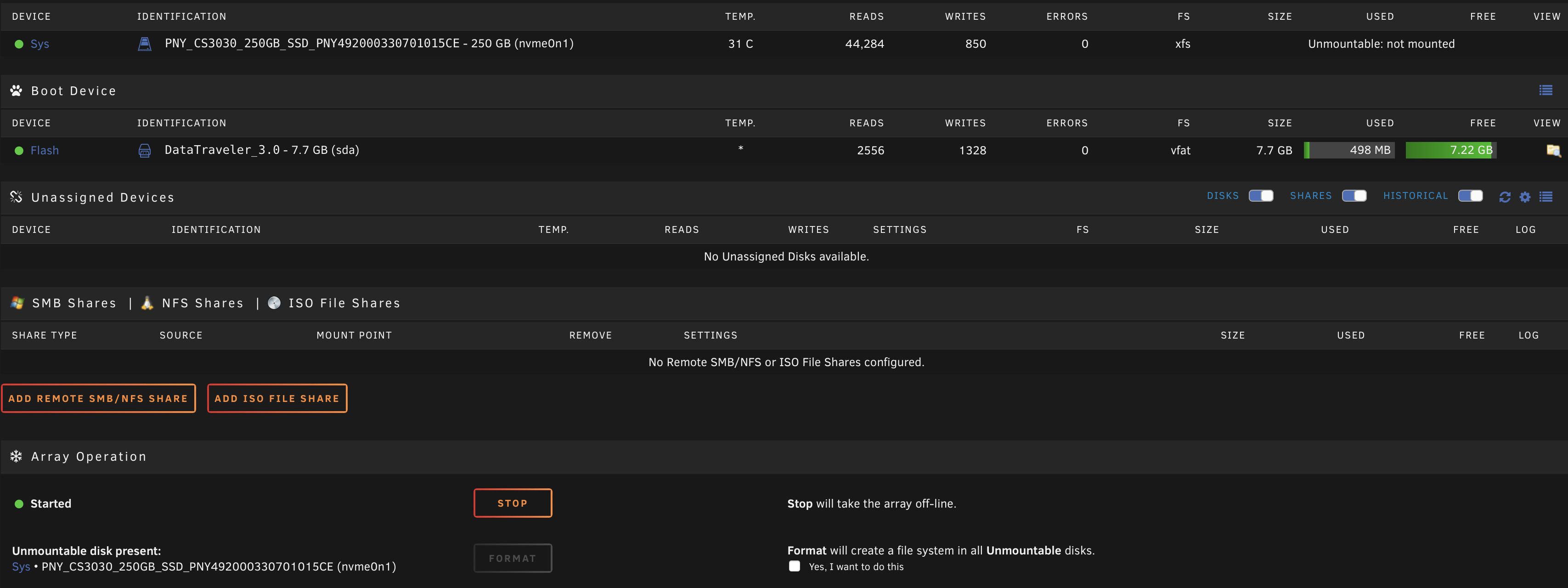

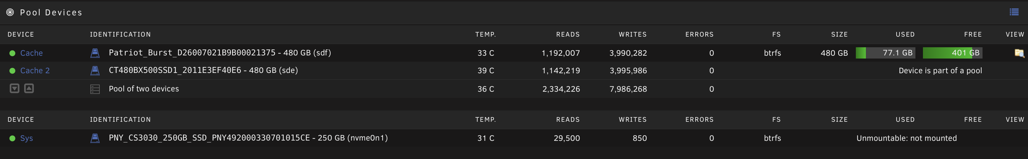

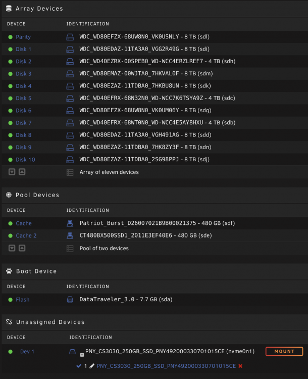

Sorry, I've done this. Nothing else except creating a new pool and adding the unassigned disk on it.. I suppose I needed to format it first..
1303168721_ScreenShot2021-11-21at1_37_04PM.thumb.png.04530fbdd6a9e231e0058d522e640dd3.png
Since it was in the array it is probably XFS, but Unraid is trying to mount it as btrfs. Stop the array, click on the disk to get to its page, and change it to XFS. Then start the array and report back.

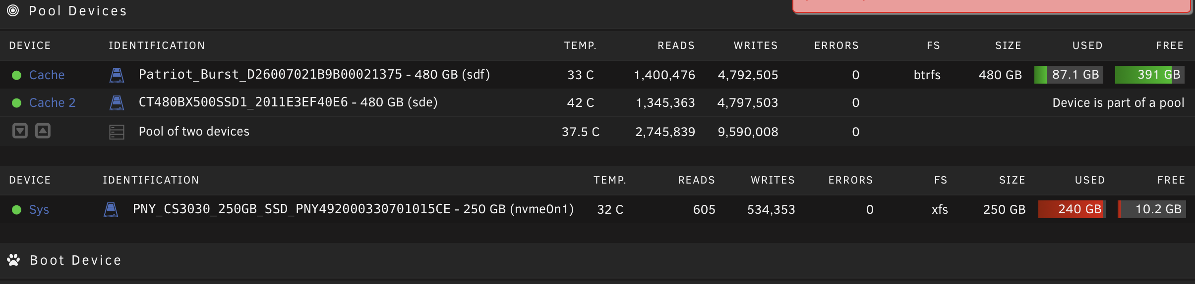

Okay, now it's xfs. Do I need to format it via this option?
782618364_ScreenShot2021-11-21at11_10_18PM.thumb.png.6f452d7501ddd95fb150720d9a80fbac.png

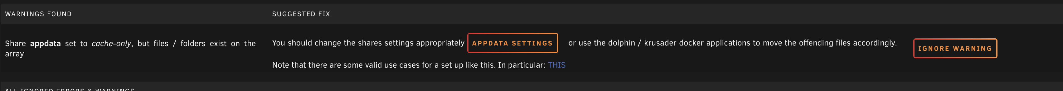

I expected it to mount. Your earlier diagnostics show it was XFS. Since you have the contents rebuilt to the disk assigned as disk8, you can format it and then get mover to move appdata and domains to that pool. You should also get system moved there and then cache would be just for caching, and nvme would be dockers/VMs.
Format the pool
Set appdata, domains, system shares to Use cache pool: Prefer and Select cache pool: sys
Run mover, wait for it to complete, then post new diagnostics.

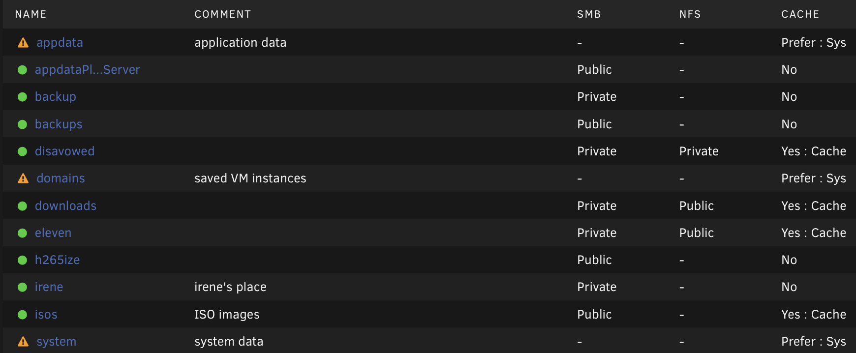

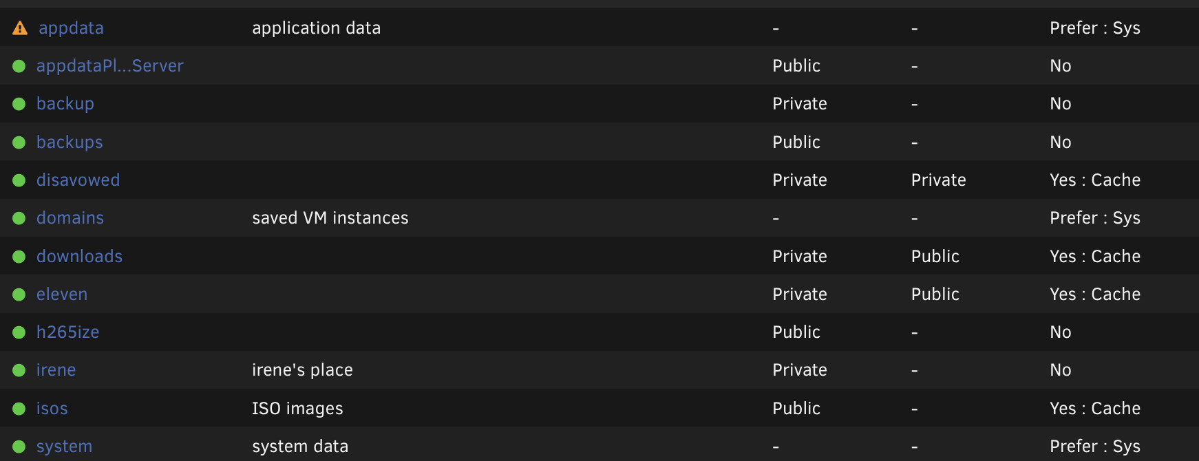

1595693129_ScreenShot2021-11-22at12_23_58AM.thumb.png.76b54e0cf021d7097fecf2d35a16225e.png
Those settings look correct, but doesn't look like you have run mover yet since domains and system are still showing they are on protected storage instead of being on the unprotected pool.

146112714_ScreenShot2021-11-22at6_35_41AM.thumb.png.ca9fa83470d9441b9324bfb683975f0f.png473897591_ScreenShot2021-11-22at6_36_10AM.thumb.png.7d9ac38a8757c40eb868699a3011a749.png

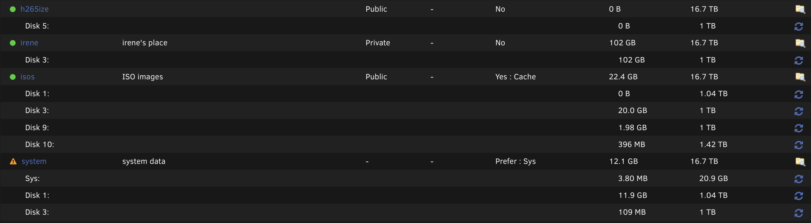

OK, that looks better, but only shows that the settings are correct, and that those shares have some files unprotected. Doesn't prove they have no files remaining on the array.

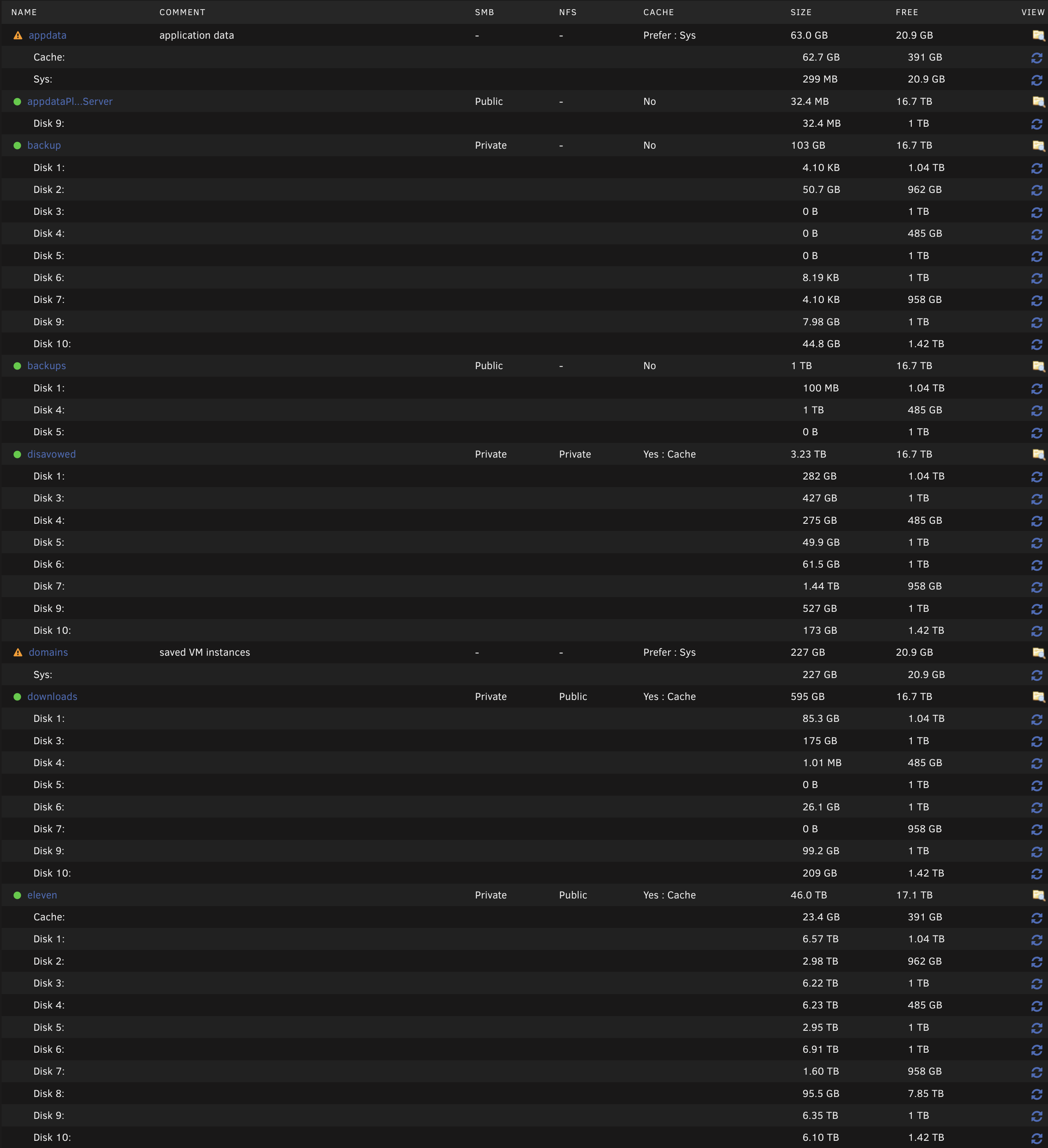

Compute... for each share will show you how much of each disk is used by each share, or use Compute All button.

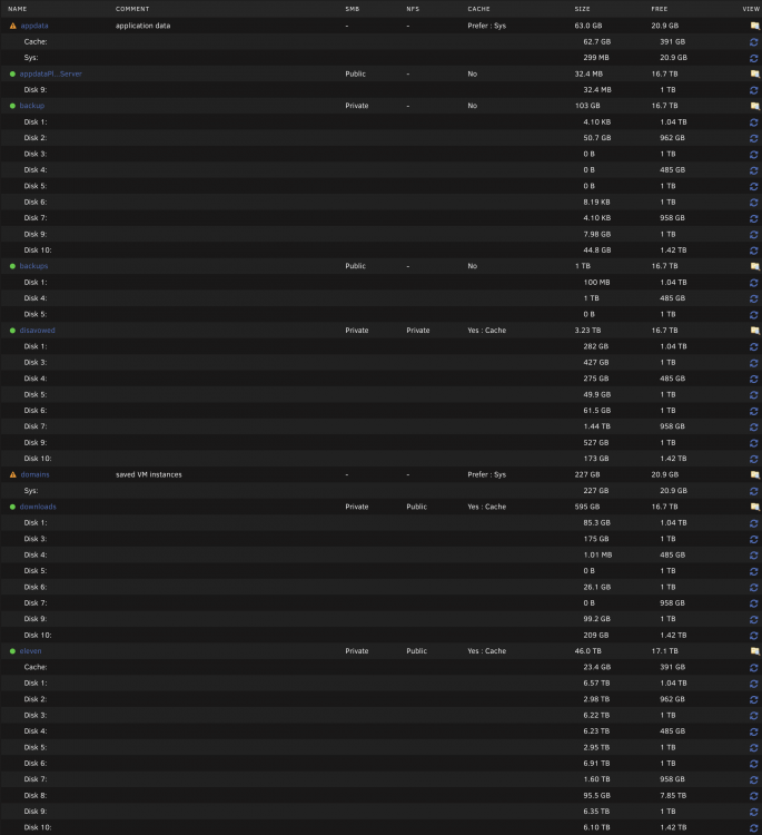

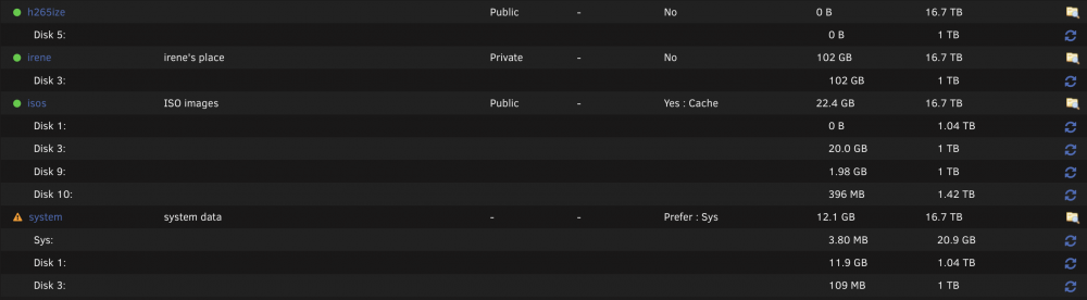

Yes of course.. sorry. Here is compute all
1533534655_ScreenShot2021-11-22at8_07_43AM.thumb.png.385e9d1ea3de321ba169ca232d511053.png
1272832277_ScreenShot2021-11-22at8_07_55AM.thumb.png.0a2d504d8e138d94c17906573a680cc6.png
Did you run mover? As you can see system share still has files on the array. Nothing can move open files, so if dockers/VMs are enabled those can't be moved. And mover won't move duplicates, so maybe that is why. If there are duplicates you will have to figure out which to keep and get those on sys pool and delete the others.
Also, appdata still has some files on cache pool. To get mover to move those you would have to make it move all of it to the array and then make it move all of it to sys pool. Mover won't move between pools.
And the separate appdata you have for plex is all on the array, we didn't really discuss what you want to do with that.
Simpler really to do some of this manually instead of trying to get mover to do it all. Do you know how to work with the files directly on the disks?

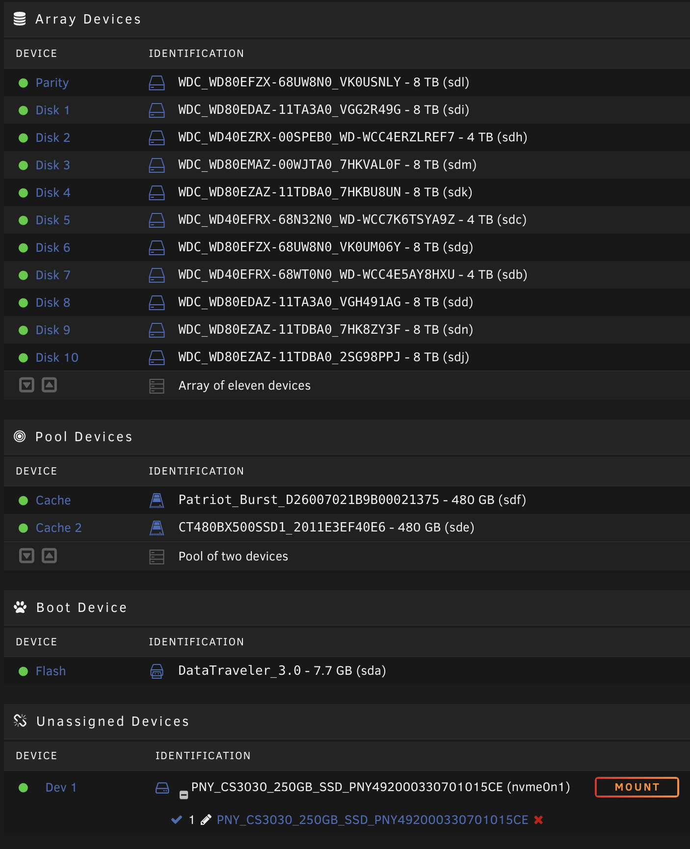

OK! I have finally the new M2 (500GB) can I use MC to move the files from the old (small one) to the new one?
My motherboard have 2 M2 ports so I guess I can do that and then remove the old one.. or another though is I could leave it for cache?
And something I just saw Disk 7 is now disabled..
I've attached my diagnostics too
1060541271_ScreenShot2021-11-29at5_39_52PM.thumb.png.5f1d6fc3e3e98de587c6f8be08d73994.png
eleven-diagnostics-20211129-1740.zip
Edited by piratx
I would keep both as separate pools. In addition to having appdata, domains, system on fast storage, it can be useful to have other shares on fast storage, such as for download post-processing. Depends on what you want to do.
It has disconnected.

The disk wasn't disconnected.. something else might happen.. maybe my PSU cant power all disks? :/
By disconnected, I mean Unraid lost its connection to the disk for some reason. Could be some connector, SATA or power, either end, including splitters, could be cable, could be power. You have to fix whatever caused that and rebuild the disk.
