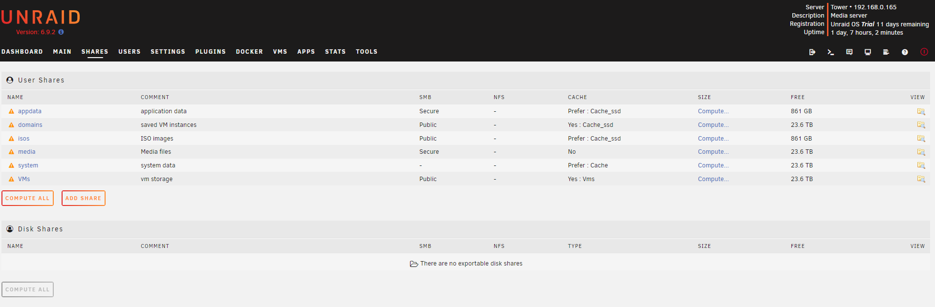

There shouldnt be active files on other than the cache_ssd pool, and the WS VM that is problematic, runs off of its own 240GB SSD on a second pool.
Or have i set it up incorrectly, according to my screenshot?
Not sure :(
It looks like you might have misunderstood the Prefer and Yes settings for the Use cache setting?
- Yes means write them to cache with overflow to array.  Later move any files on cache to the array
- Prefer means write them to cache, with overflow to array.  Later move any files on array to cache if sufficient free space.
You can see how much of each disk each user share is using by clicking Compute... for the share, or Compute All button.

You could be right about that, but i can see the vdisk files etc physically on the SSDs when i view the file system on them, also they are growing in size as i install stuff.
Tried downloading from a VM to the c-drive (vdisk), and i could see the writes on the SSD in the Main tab.
But i was under the impression that i could keep everything related to VMs solely on the SSDs by selecting Yes: cache_ssd/VMs.
How do i make sure that they are kept only on the SSDs then?

Use the ‘Only’ setting!
note you should only use this setting once there are no files currently on the array for the share as the ‘mover’ application ignores shares set to,’Only’.
