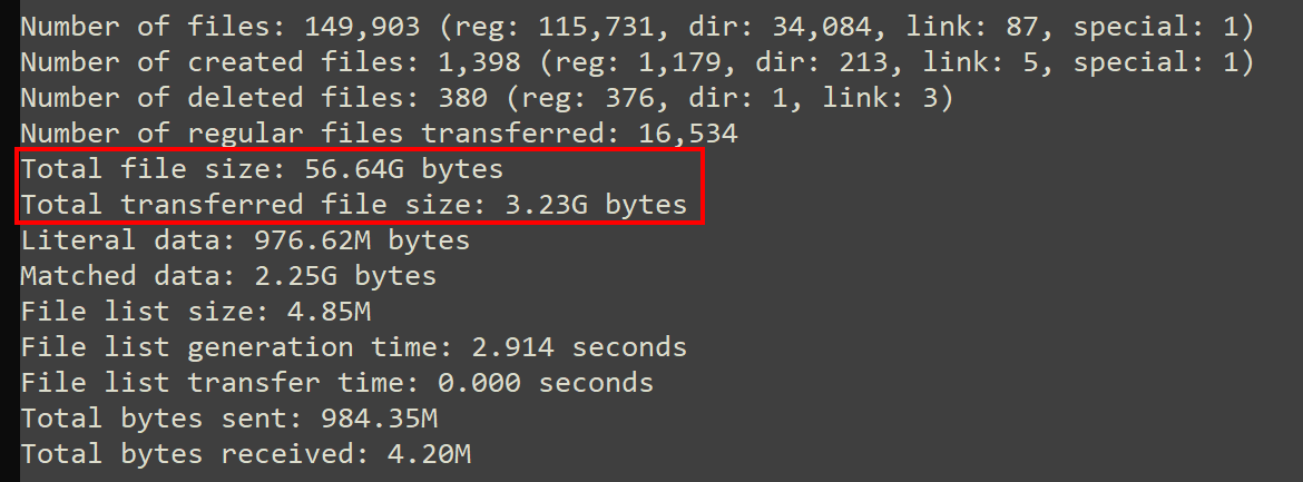

Anyone that uses a different way to backup to an external server? I do it manually now, but i want to automate it. The Backup PC turns on in the night, and I want to trigger the backup at that time too since it is quite an extensive copy.
The only thing I can think of is writing my own script that uses rsync to copy, but it was so nice that LuckyBackup does that for me. (Although it does have to recopy all the Appdata copies that I have new each day, it's technically still copying chunks of data every data instead of refreshing only what has changed.)
then there is also something wrong in your setup ... sample from appdata here

It  seems I failed to debug properly myself. A classic mistake I was hoping I could avoid. The log shows the error and Ive fixed all the automatic Starting of my Backup Server. I recently changed the Network Card and OS of my backup server. And Wake-on wasnt set to g for this interface. And also the IP changed of course. So double trouble and me being an idiot. Im sure it will work now.
