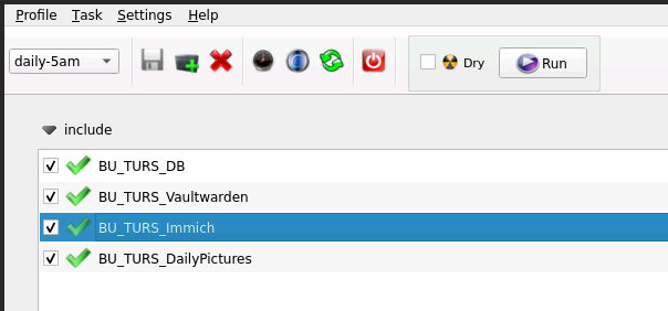

Profile is pretty simple:
Manual runs work fine. Just no schedule.
