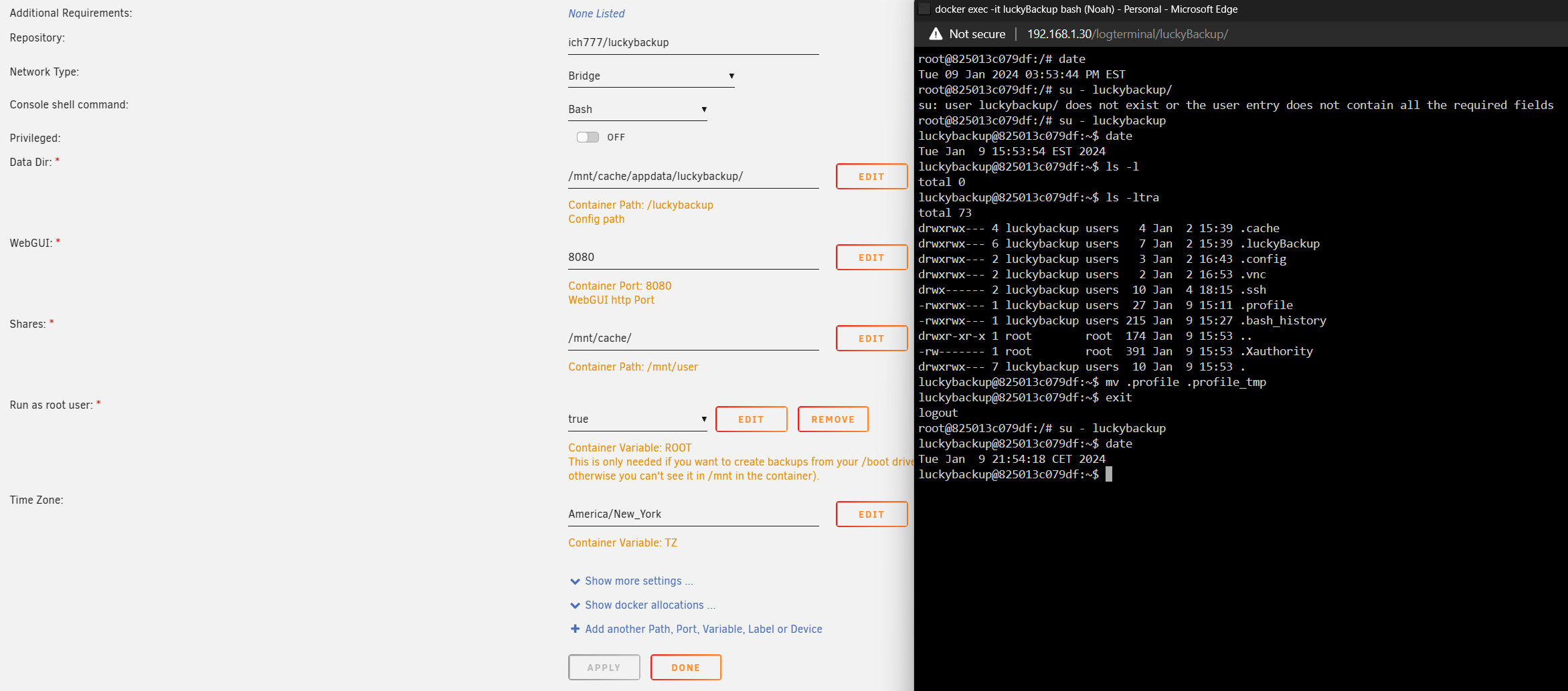

Log into docker console (you will be root), and execute:
su - luckybackup
touch .profile
echo "export TZ=America/New_York" > .profile
Then restart your container and check the "date" commands again. Then maybe test a simple scheulded backup and see if it kicks off when you want it to.
5 minutes ago, cybrnook said:
@Mattaton Try and and see if it works
su - luckybackup
touch .profile
I tried just adding a TZ var to the ENV settings. That did not work. Date command still returns in CET.
Created the .profile as you described and it returned the time in EST, albeit in a different format and in 24-hour syntax (as yours did).
root@d841cef0c6d7:/# date
Tue 09 Jan 2024 03:28:03 PM EST
root@d841cef0c6d7:/# su - luckybackup
luckybackup@d841cef0c6d7:~$ date
Tue Jan  9 15:28:12 EST 2024
Edited by Mattaton
1 minute ago, Mattaton said:
Created the .profile as you described and it returned the time in EST, albeit in a different format and in 24-hour syntax.
Good! Can you setup a simple backup job to run, say in 5 min and see if it kicks off correctly?
Just ran a test and it seems to be working!
Thanks for the help with this! And I would think anything in the luckybackup folder is persistent, correct?

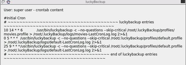

Update on the timezone scheduling...
I have the cron for my main profile (daily-5am) set to run at 5am, which it did NOT.
I checked the timezone and it still checks out as EST. So, we'll see if it runs at 11am and the 6-hour delay issue remains.
0 5 * * * /usr/bin/luckybackup -c --no-questions --skip-critical /root/.luckyBackup/profiles/
daily-5am.profile > /root/.luckyBackup/logs/daily-5am-LastCronLog.log 2>&1
Before yesterday, I had this cron job set to 0 0 * * * and it would run at 6am (6 hours later). With the timezone fix, I would think this should have run at 5am when set to 0 5 * * *. You guys see anything I'm doing wrong?

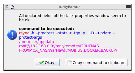

I have been using rsync to backup my audiobooks from my UnRaid box to a 2nd smaller TrueNAS Scale box...was thinking about this...saw the validate command on luckybackup to show
Would something like this as a cron?
rsync -aqu --protect-args -chown=warhawk:warhawk /mnt/user/appdata [email protected]:/mnt/optimus/NAS/WarHawk/MOBIUS.DOCKER.BACKUP
The -a is "archive mode" which is the command "equivalent" to -rlptgoD
The -q quiet (so it doesn't output anything)...just does it
The -u updates (allows rsync to skip files that are still new in the destination directory)
don't know what the --protect-args is...is that the same as -p or preserve permissions?
The -chown just makes sure it has the same permissions on my target drive as the "user:group" I am backing up to (otherwise my user has a directory with a bunch of "nobody:users" files/directories in them.
Of course I ran the first command like this the first time to watch all the awesome text go by to ensure it was actually going to the correct location.
rsync -avhP  /mnt/user/appdata [email protected]:/mnt/optimus/NAS/WarHawk/MOBIUS.DOCKER.BACKUP
Since I followed the howto and installed the /root/.ssh/id_rsa it allows passwordless SSH login and instant upload/backup to my 2nd box
Edited by WarHawk8080
Please don't, please use /luckybackup/.ssh/id_rsa
It should always point to /luckybackup and not to /root inside the container!
No, that is not the same, --protect-args is used when you have special characters or I think even spaces in your paths and you don't want the shell to mess with that when passed over to rsync.

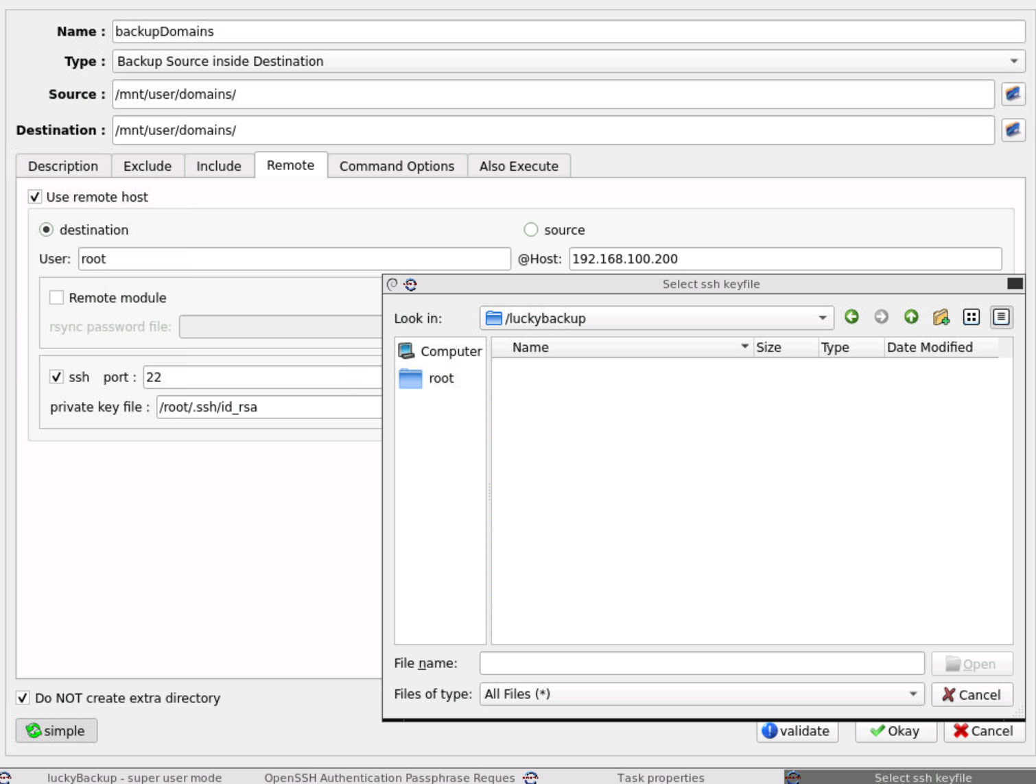

I followed the video guide posted at the top of this thread and it had the docker container running on the source machine.  Is a backup machine meant to be pulling from the source machine instead of the source machine pushing to the destination machine?  Does it matter?
Also why synchronize instead of backup?
Edited by DontWorryScro
On 3/17/2022 at 3:16 AM, ich777 said:
Please use the directory /luckybackup/.ssh/ for your id_rsa.
im not as adept as others. Can you tell me how to take the id_rsa from the root dir that was explained in the guide and copy/move it to where ever this is?  And how to adjust the path in luckybackup to find the new location
I rewatched the video and any instance of typing root in cli i replaced with luckybackup but all things being equal, in the end, i just saw this when i navigated to the newly created luckybackup directory for the key. Looks to be empty inside.  what i do wrong?
I was able to rightclick in the empty space to give me the option to show hidden files which did in fact reveal to me the id_rsa files i had created.  but selecting them and attempting the backup popped some weird password request window in the VNC.
You can do it either way and it doesn't matter much.
I'm more comfortable pulling it from the source machine to the destination since it feels a bit more safe to me since you can write a script that is running on server start that starts the backup, shuts down the machine automatically if needed and if this machine is only powered on for a backup.
Please don't use the root directory, you always have to use the id_rsa from the /luckybackup/.ssh directory not root because otherwise it will be wiped on a container update.

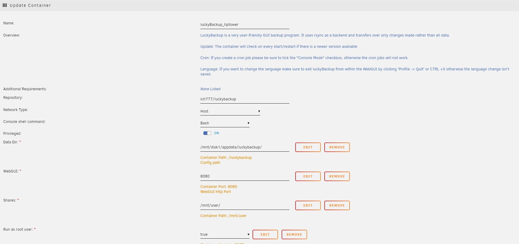

Please post a screenshot from your Docker template.
Then you selected the wrong keys.
BTW You don't have to create new keys, please use the existing ones which are located in /luckybackup/.ssh since they are individually created for each installation and as said above, please don't use the keys from /root/.ssh

Here is a screencap of my docker container config

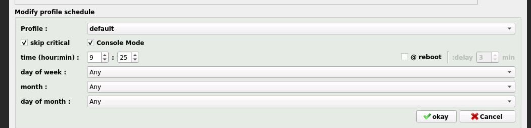

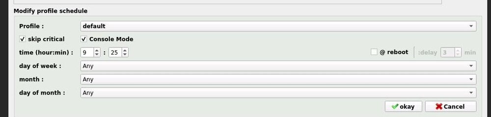

On 1/2/2024 at 4:36 AM, Mattaton said:
Thanks. I just turned that on. I'll see what happens tonight.

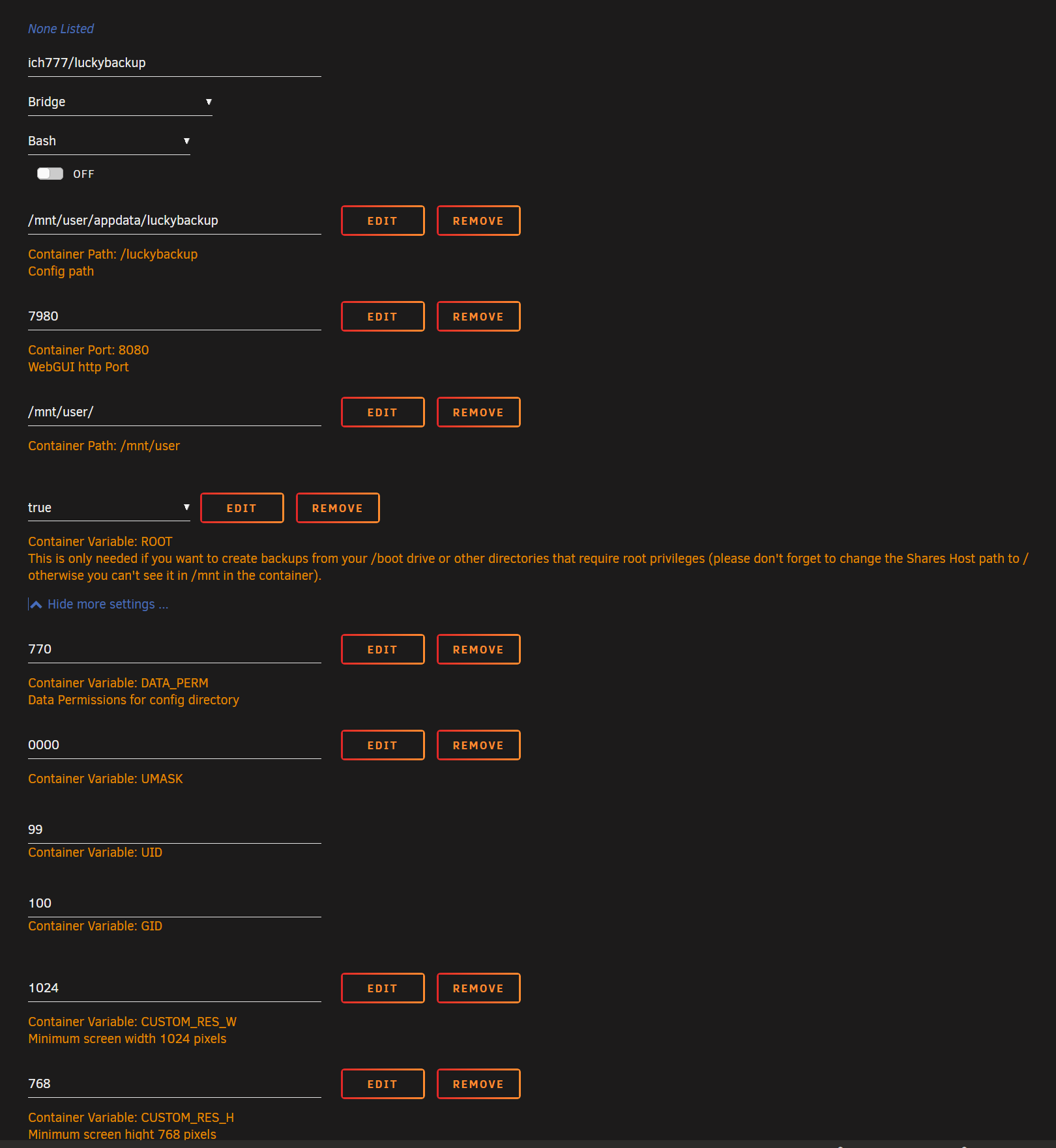

Did you ever get the schedule to work ? Manual works fine but I'm having similar problems with scheduler and going in circles trying to work out why it won't work.
My schedule is as follows:
And My docker setup as well:
Any pointers appreciated.
