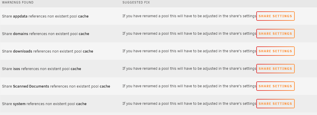

Share ... references non existent pool cache
I got these strange warnings from FCP, how do I fix it?
I have no cache pool and have never had one, don't know what caused the issue.
The settings for the shares are prefer: cache for some and yes: cache for others, but they worked for few years without problems (already set up for if I ever wanted to add cache).
Edited by Fedeöä
You fix this all on the Share Settings in question.  Your share's settings explictly refer to a pool named "cache" but you do not have a pool named "cache" (it is named something else).  This results in files winding up on the array when you don't actually want them to.

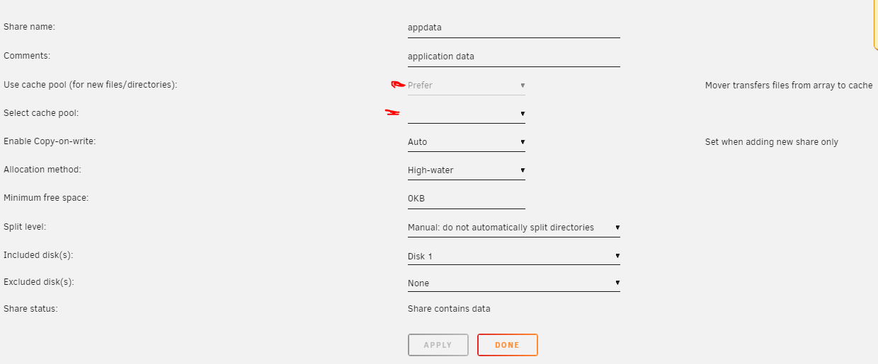

Thats what I thought, but I can't actually change anything.
The Use cache pool is greyed out and select cache pool is just an empty list, as I don't actually have a cache pool, and don't intend to have one atm.

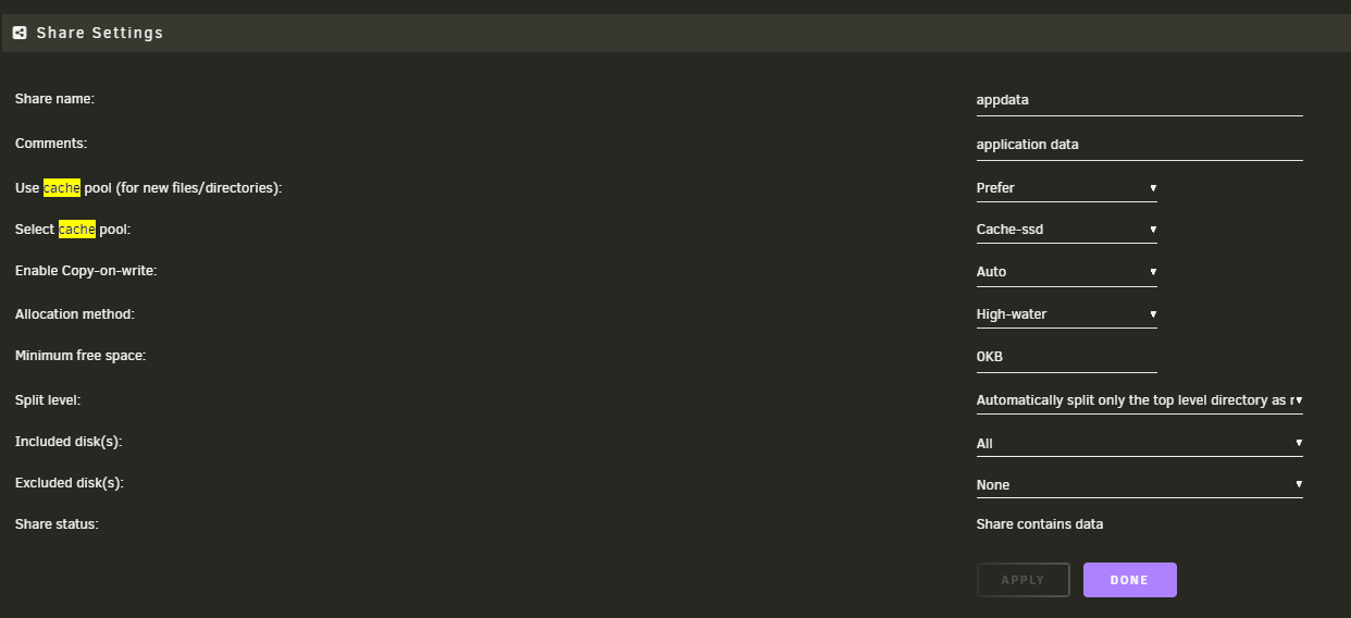

Example of the appdata share:
Be aware that the actual reference may be different, and the GUI in this case shows the first possible choice.
You can make a change in the settings (and revert) to force a update and ensure the correct reference is used.

Have you tried to set the share as Use cache to No, Apply.
Then set it back to Yes or Prefer depending on your use case, adjust the Pool if possible then Apply ?
Do that on one share, export new diagnostics and check the cfg file to see if it fixes the issue.
If you are not sure, you can check this new diag and tell us which share you changed.

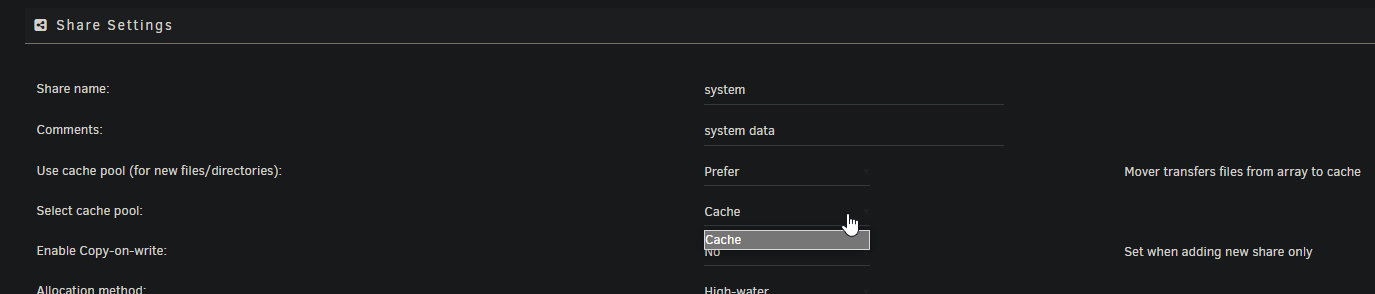

I noticed the same thing, the unraid UI showed that the cache pool was correct, and no other option existed in the dropdown. FCP stated I was using a different pool.
I just did something similar:
Change the "use cache pool" option to any other option, then back to what I had it set to. Did not save changes until it was set back to Prefer (setting I had initially). This made the "apply" button active.
After applying the settings I rescanned in FCP and boom, errors gone.
Essentially, make any change in the share settings that allows you to be able to click the Apply button and click apply. The UI showed these shares of mine as using the pool Cache but for some reason they weren't.
Here's my share showing only one cache pool -

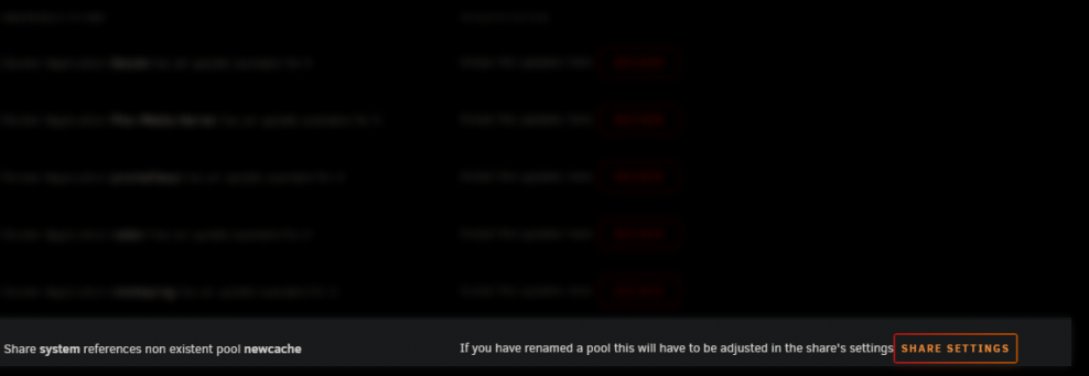

And FCP notifying me about how it's using a different pool -
