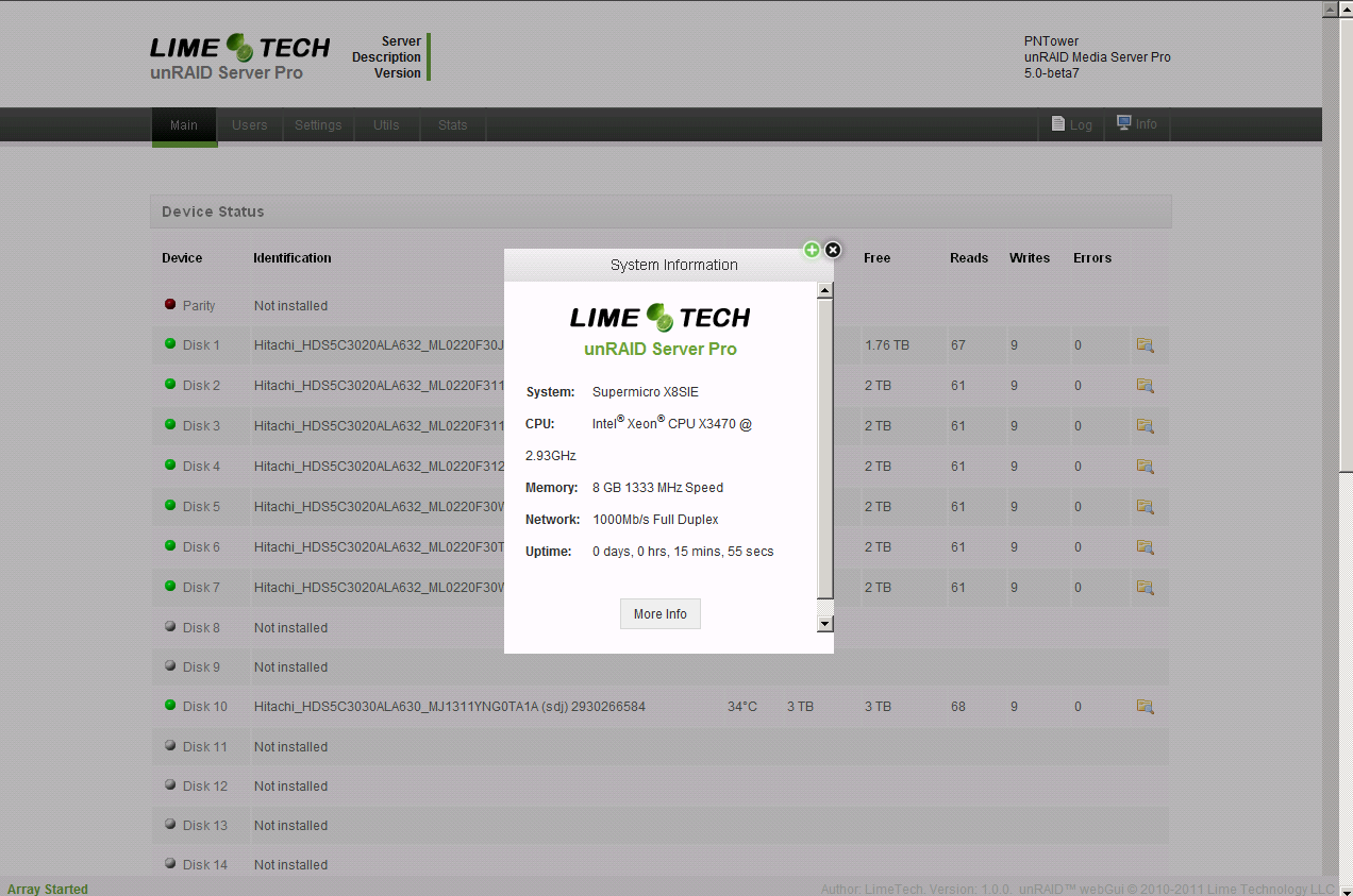

CPU: in sys info is wrapping, dont know if that's what you were expecting, screenshot attached for your review. My other suggestions still stand. I sent you a pm or 2 to offer assistance were I can, not sure if they reached you. Thanks for this update.
How about adding "overflow:hidden" to that <div> in the System Info, so that the scroll bar disappears? Will definitely clean that up--at least when the System Info is displayed. What does the green + show? Syslog, as madburg stated? At that point, yes, a scrollbar would be necessary, but is that space appropriate for logs?
Not sure what you mean, speeding_ant keep the same original view of the syslog he created, but added an addition (+) by clicking the (+) it closes that modal view and launches the syslog in a new browser window, just as Tom had, to be able to monitor the log while performing actions on the original browser page. My 2 Cents, well done.
Oh ok, no I just never used it before. So I wasn't aware of the functionality.
try it u might like it LOL
He knows better what he is writing/trying to achieve, but I agree no scroll bar would be nice and if possible (like I meantioned before) auto size the box, so no wrapping or scroll bar would be needed, would be cool. His "more info" may need to have a scroll bar once he is done depending on the amount of info he will be bringing back and the font size, I'm guessing.

In regards to overflow, it works on all current browsers. I'll find a decent solution :)  Modals don't easily resize HTML to fit, so I'll do my best.
