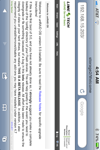

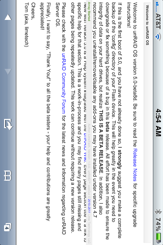

found a minor bug
The footer indicating "Array Started" on the iPhone in landscape does not stay at the bottom of the page when you scroll down.  It ends up in the middle of the page.  I'll attach some screenshots a little later.
J
edit: attached screenshots
