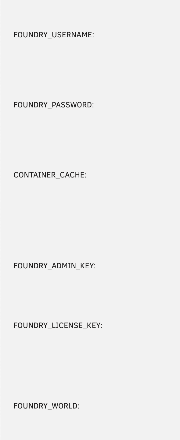

I was able to get this to work. What you need to do is delete the FOUNDRY VERSION variable and update it.
When the variable is present it is required but when removed it goes off the repository
I was also having problems with the username/password method, and specifying the foundry version is the only thing that worked for me as well.
i had the problem until I physically deleted the variable from the container. I didn't make it empty I actually deleted it so it wasn't possible to fill in.
Thanks for the info, I can confirm. Very useful!
@silmanwould it be possible to add instructions to your container with the steps i have above? it seems to be how it needs to be done with the new 11 version

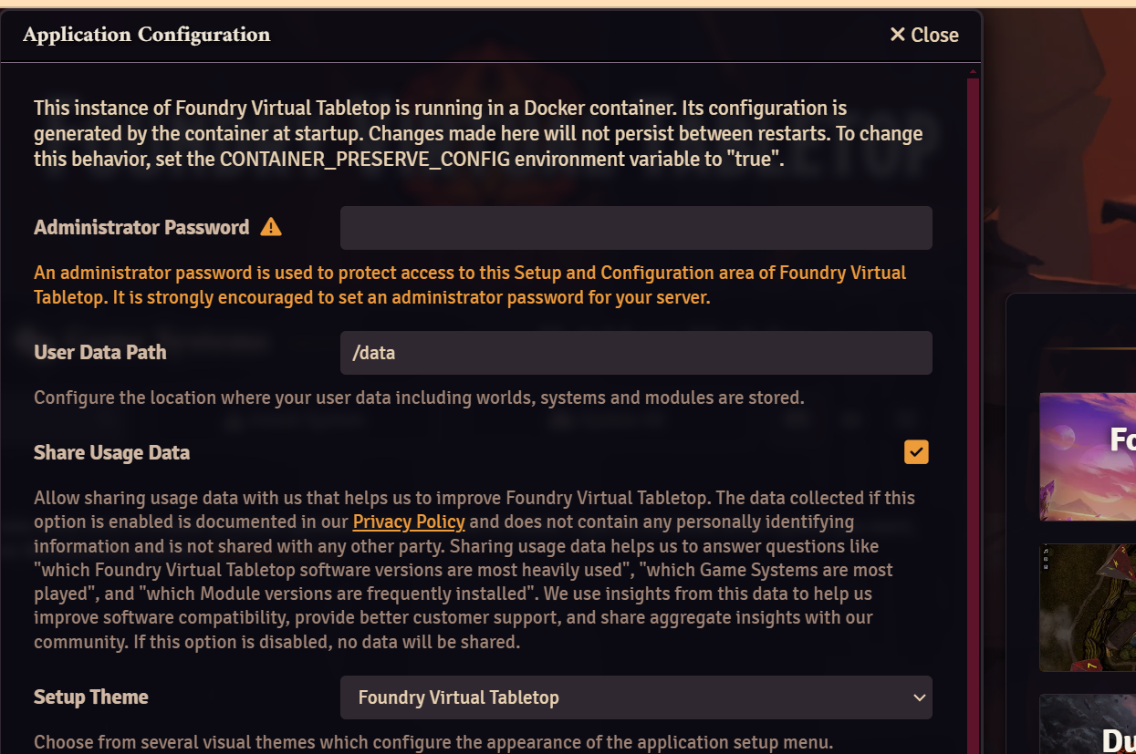

hello how do I fix this error I cant save any thing every time I reboot the docker I have to set my admin password and nothing will save only my key is saved thanks so much.
