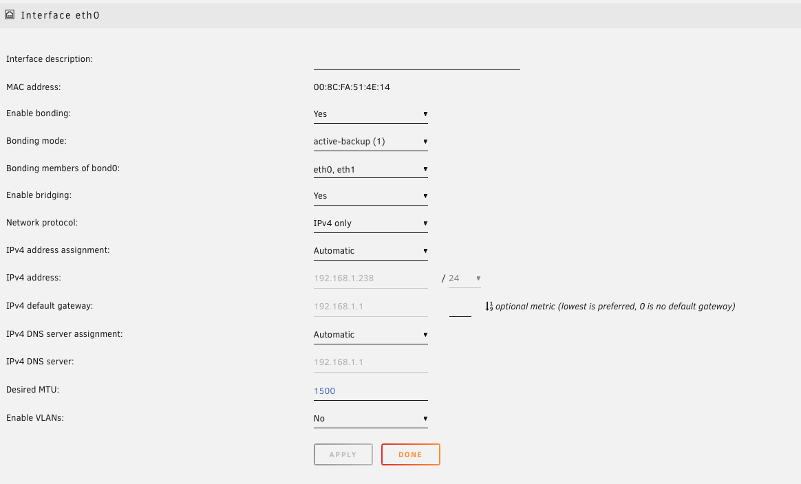

Can you tell me how can I stop bonding on the unpaid server since I am not using it
I think it is active in my settings for some reason. Please check my screenshot that I attached

checking you posts again, I found something strange:
Your syslog shows you have an 2 Port Intel IXGB (10Gbe) card, but your screenshot of the network config shows an interface from some unknown taiwan company

This is a bit confusing... is there a 3rd card in your server, that you did not show us for now (scroll down the page and take screenshots of the rest. There should be at least eth1 and a section where you can see/adjust, what mac address gets what interface name).
Your syslog shows that you get an address from the dhcp server, but when trying to see if this address is already in use elsewhere a device with the address
br0: 02:01:4e:36:f1:43(02:01:4e:36:f1:43) claims 192.168.1.200
(THIS is the intel card!)
and since your network uses a failover bonding (set to NO!!!), packets from the mystic card echo back to the intel which instantly pulls back her address.
Note this mystic device can also be a wild running docker pseudo card or something. Turn off dockers and see what happens.
(Dockers are shit anyway!)
there is another simple but effective possible error:
Your lan may contain a dead or not really functioning device like a not well connected lan. There are cases where the receive lines work (link is on), but sending lines are not (link only on one side).
Or a broken card, which can receive, but not send (NOT IN YOUR SERVER, BUT ELSEWHERE IN YOUR LAN!).
what happens then is really hard to describe and partly random. But you can think of it as "fighting for addresses". Both receivers take the new address and probes for "free" will fail, so the server assign the next address and the circle begins .
Try to find this 02:01:4e:36:f1:43 and eliminate it. Maybe it is even the router himself and he is broken? (look for addressen that start with 02:01:4e:)
