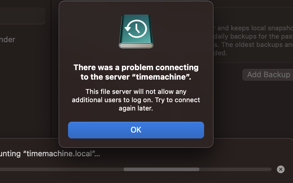

I'm getting this error - any suggestions?  I ran the permissions command.
I happen to have created the share /mnt/user/timemachine share before the docker connected to it - could that be an issue?
Edited by ryry
added info
Try deleting the share and restart the docker so that it will recreate it. Then run the sudo command again.
That worked - thank you.
