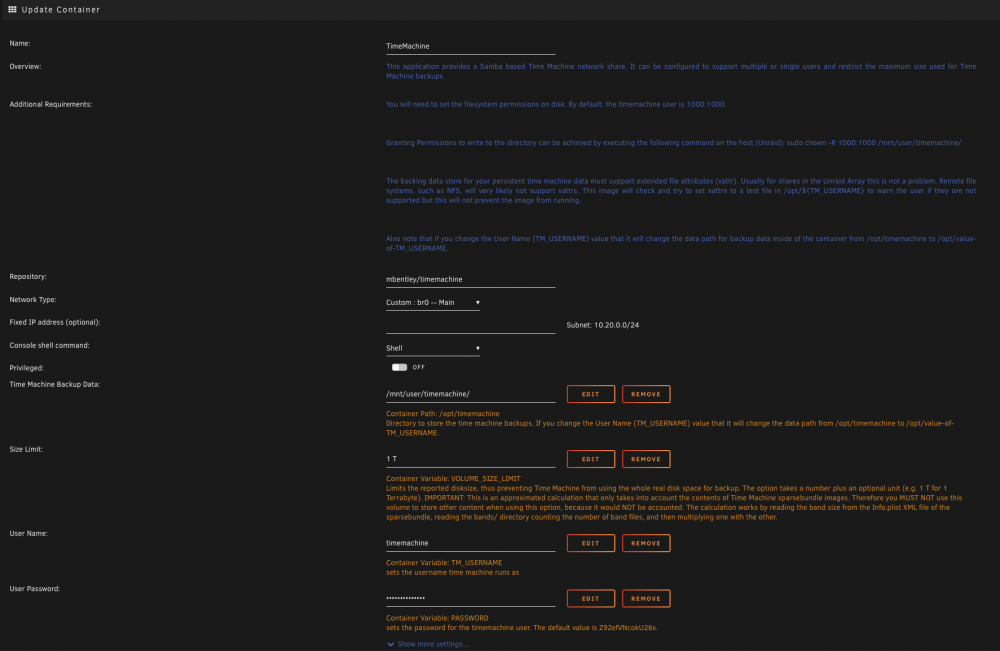

I cannot figure out what I'm doing wrong... I leave everything default (so the container creates the share required) and run the chown command, but timemachine still is writing to the docker image. I believe I've read everything in these two pages but haven't found anything I'm forgetting to do.
This usually means you’ve got a path configured wrong. Did you use the default user? If you changed it you must also change the container path for the backup location. If that’s not it post your docker run command in your next post. Be sure to redact passwords.

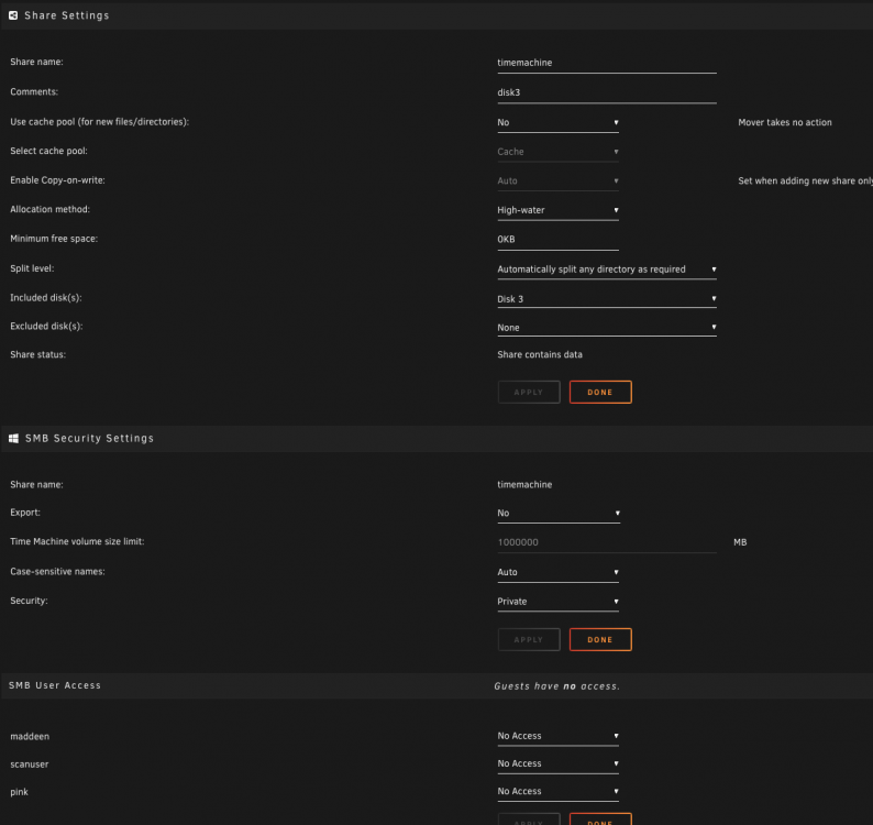

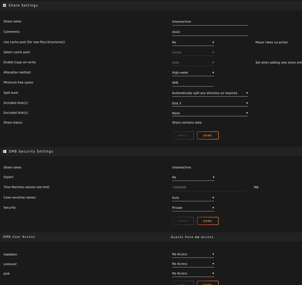

First I set up a share - see first screenshot - honestly 100% like @moritzf

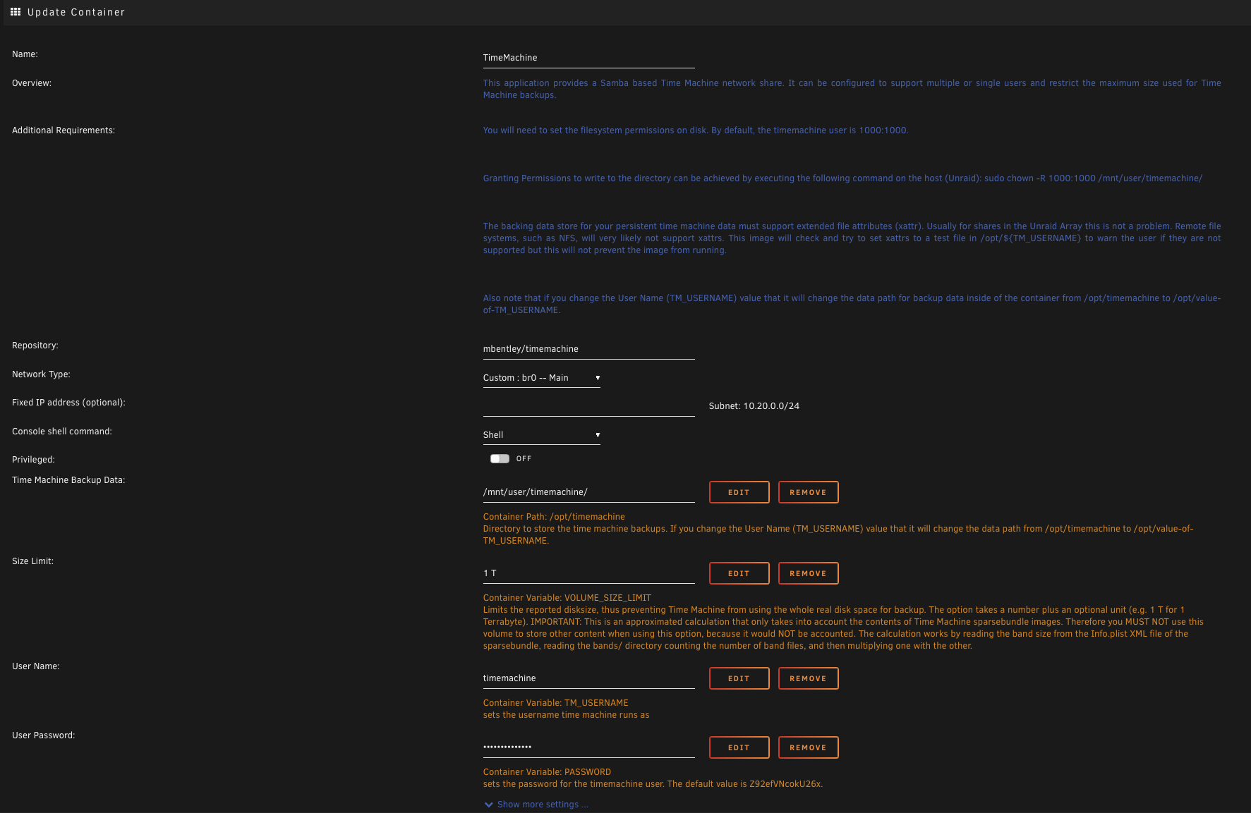

After that I installed the docker and left everything as default. See second screenshot.
Than I run the command as adviced: sudo chown -R 1000:1000 /mnt/user/timemachine/
Due to the fact that I got no error message this should worked ;)
Than - to make sure - I just restarted the docker.
But the Time Machine preferences still dont find a correct volume do choose for backup.
I also attached the docker_run.
Hopefully someone can help me out here. Thanks in advance

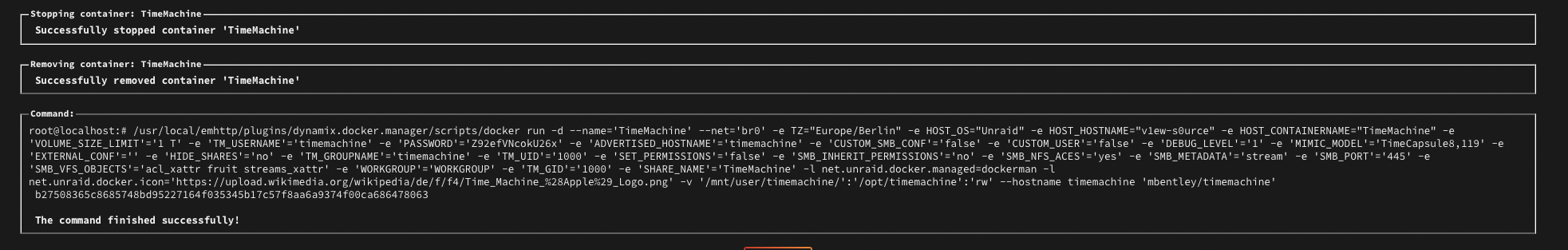

INFO: running test for xattr support on your time machine persistent storage location...
INFO: xattr test successful - your persistent data store supports xattrs
INFO: entrypoint complete; executing 's6-svscan /etc/s6'
nmbd version 4.15.7 started.
Copyright Andrew Tridgell and the Samba Team 1992-2021
smbd version 4.15.7 started.
INFO: Profiling support unavailable in this build.
Failed to fetch record!
Samba name server TIMEMACHINE is now a local master browser for workgroup WORKGROUP on subnet REDACTED

I tried to set this up after reading that it works (and 6.10 does not). I get the following errors:
error in mds_init_ctx for: /opt/timemachine
_mdssvc_open: Couldn't create policy handle for TimeMachine
talloc: access after free error - first free may be at ../../tevent_req.c:291
Bad talloc magic value - access after free
INTERNAL ERROR: Bad talloc magic value - access after free in pid 48 (4.15.7)
If you are running a recent Samba version, and if you think this problem is not yet fixed in the latest versions, please consider reporting this bug, see https://wiki.samba.org/index.php/Bug_Reporting
PANIC (pid 48): Bad talloc magic value - access after free in 4.15.7
unable to produce a stack trace on this platform
dumping core in /var/log/samba/cores/smbd
Does anyone have any advise as to how to resolve?
