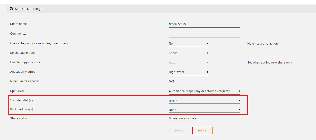

Thank you @moritzf for bringing this to Unraid! I've got it configured and working perfectly for a single user setup.
My one question is: when you're in the share settings should you leave the Included and Excluded disks as default (i.e. using all of them), or to force the share to just use one disk? I have read that in other Unraid Time Machine backup solutions it's best to keep the backup on a single disk. Is this the case for this docker?
This is how I have mine setup, and all is working well.
So, my question is, is it better that have the share set to one disk, or just to leave everything there as default and allow it to use all disks? I have checked through this thread and the original docker and github documentation but could not find any mention of this, so I thought I would ask here.

It's often recommend to keep time machine backups to a single disk. I'm not sure if it applies here, but it doesn't hurt.
The usual recommendation for "what size should my time machine backup be?" is 2 x your Mac's disk size. I have a 1TB disk, so I made it 2TB.
Hope that helps!
