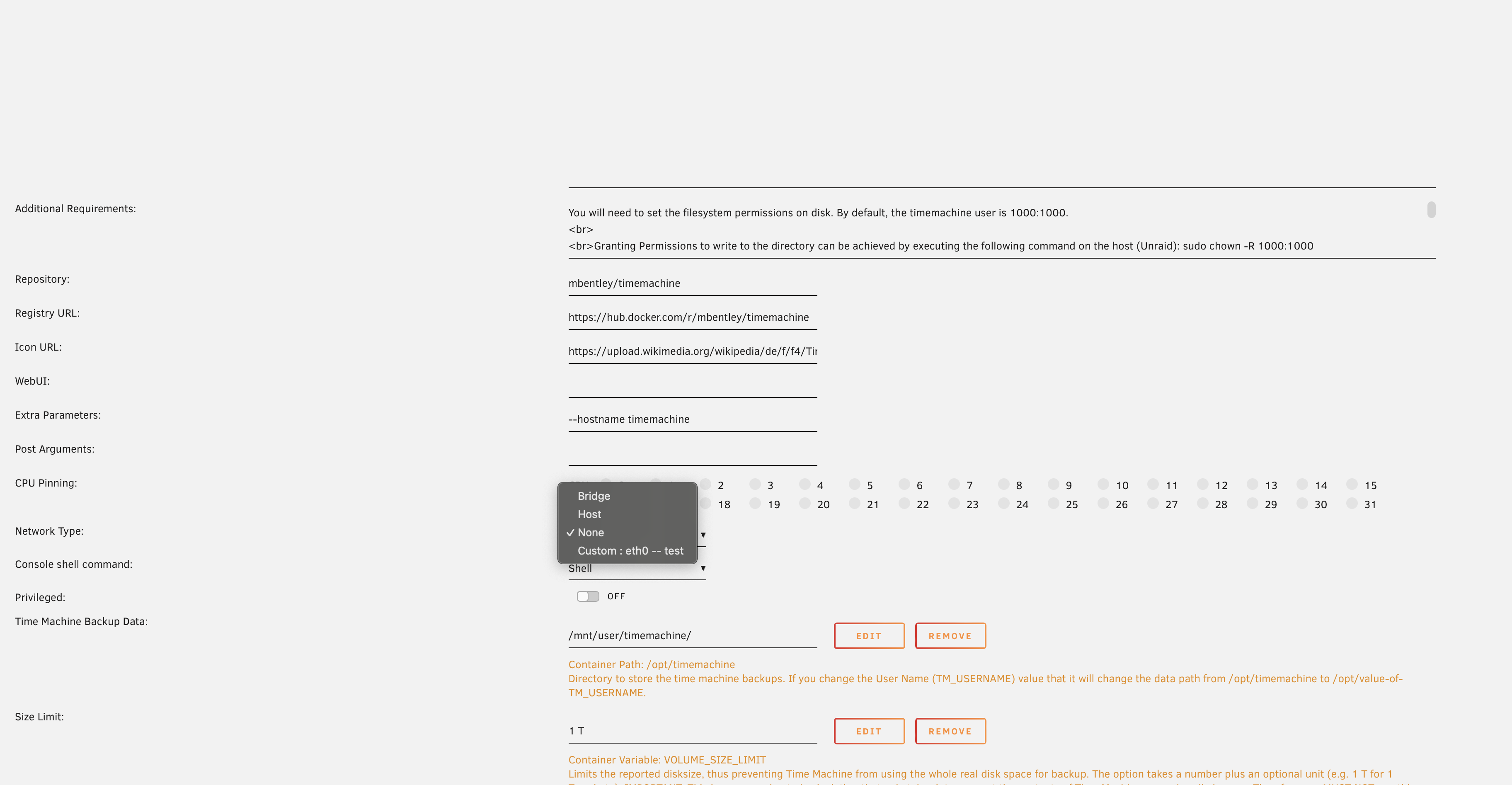

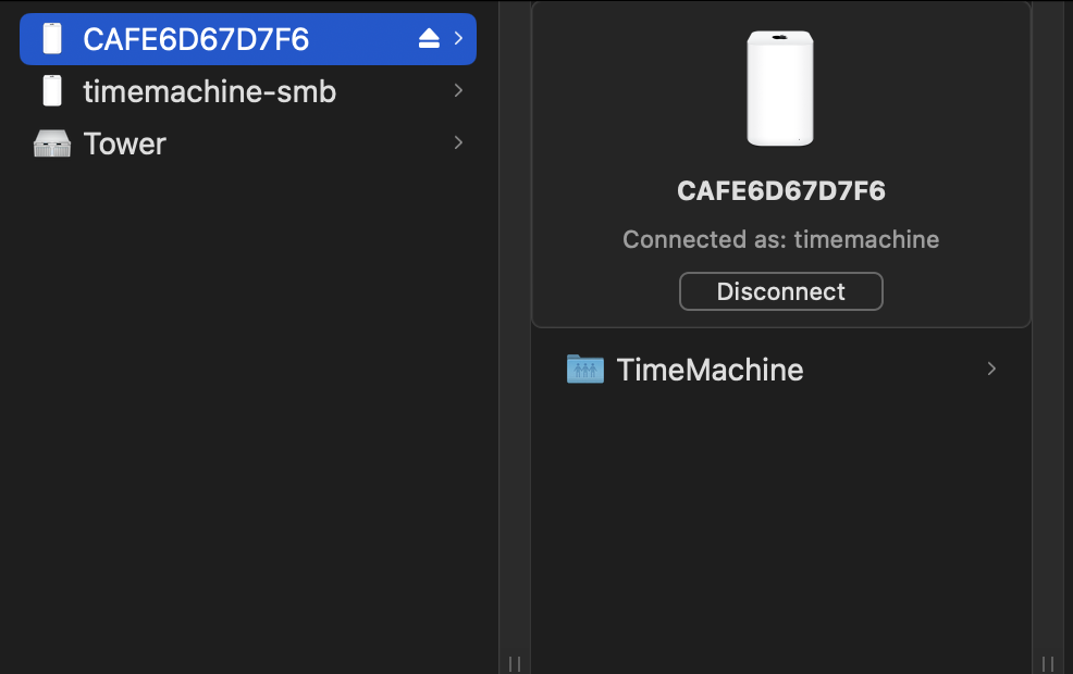

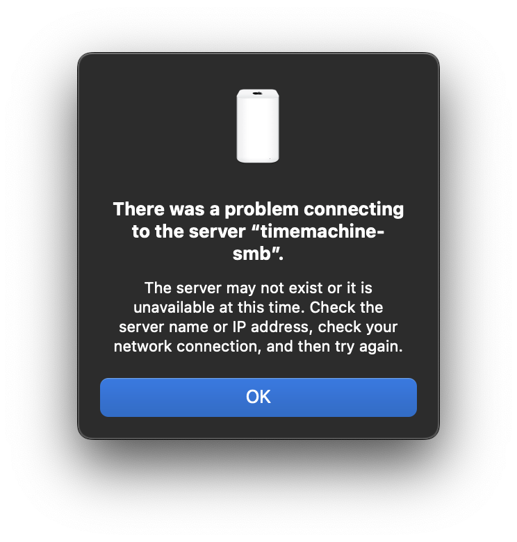

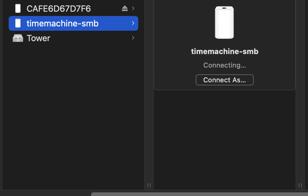

Question: what should be selected as network type? I tried leaving it default (none) and custom eth0. Neither of them work.525492742_Screenshot2023-09-06at01_05_17.thumb.png.713dd32c9632d8ca6fbf1137e81df93c.png
Usually the custom eth0 is the one to go for, because that allows the service to advertise itself on the network. What sort of not work are you getting?
Thanks for the response. Running with custom eth0 does seem better. At least I can connect to the drive. However, I'm getting "The backup disk image could not be created." when backing up on my Mac.
I checked log in my console and here are the log around that time filtered by "backup":

However, a few things are weird.
Successful TM Endpoint
Failed TM Endpoint:
Anyway to get it to not randomly generate a name like in the screenshot? CAFE6D6707F6, etc.?
I was hoping to use 'timemachine-smb', which is what Advertised Hostname is set to. Is that not correct? I'm not able to 'Connect As' for that endpoint, it just eventually times out with this error:
You should see TIMEMACHINE.local advertised. I asked a similar question when I first setup this docker but don’t think I ever got an answer. I know it’s TIMEMACHINE.local on my system even though the Advertised Hostname is timemachine-smb.
Did you input TIMEMACHINE.local anywhere, or did it just magically appear ?

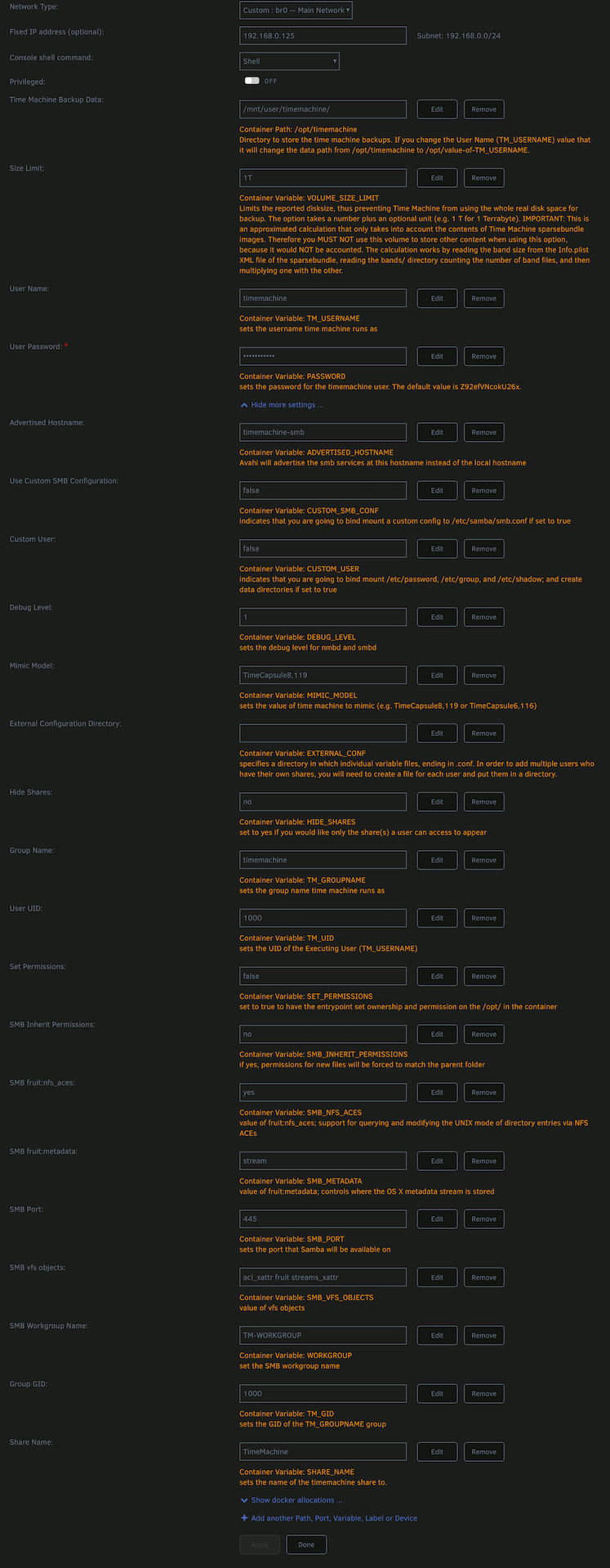

Here's my Container settings:
259547410_FireShotCapture002-Tower_UpdateContainer_-192-168-0-124.f74fb117d7d3d6a8e23e40b2de32df1c12740e8c.myunraid_net.thumb.png.be529529dfaa323332db3526feb04db0.png
Edited by defected07
Smaller screenshot

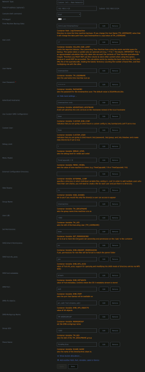

Ah I think I figured it out. If you toggle the switch at the top right for 'Advanced View', then you can specify the hostname of the container:
2054492768_Screenshot2023-10-06at2_55_54PM.thumb.png.bce7e1e1fc94495336600d3dd6f301b4.png
And I left "ADVERTISED_HOSTNAME" blank. But then I believe you lose Avahi broadcasting on the host, so I had to manually connect to my unRAID array -- it didn't show up under Network or on the left panel in Finder.

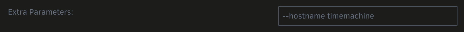

I set `extra parameters` to `--hostname timemachine` -- and that's how it appears in Finder.
I used `Custom: br0 -- Main Network`, set a fixed IP address, not sure what else, and I dont' remember how I came to this conclusion, think I took some pieces from one config and some from another from this plug-in's GitHub README

On 12/10/2023 at 1:46 PM, daNick73 said:
From default I only changed network from "none" to "bridge"
I believe this is the mistake. You should select the "custom" network that can be created in Unraid's Docker settings. This will allow the Time Machine container to have its own IP in and exchange multicast DNS/DNS Service Discovery messages with devices on your 192.168.178.0/24 network.
The "bridge" network will put Docker containers in a 172.17.0.0/16 (by default) internal network that you can think of as NAT-ed behind your Unraid server's IP. In most cases, this is fine and you just forward the appropriate ports through that NAT to a container*, but the mDNS and DNS-SD messages needed for clients to discover and communicate with the Time Machine service won't cross from one network to the other. Even if they did, the Time Machine container on a "bridge" network only knows its 172.17.0.0/16 address, which is no use to the machines on 192.168.178.0/24 that are looking to back up.
* In theory, you might be able to set Time Machine up like this - it's "just" an SMB server - but it would be more work to set up the clients and Time Machine is notoriously picky; without the multicast stuff it might decline to accept the server.
Edited by ScottAS2
I can confirm this solution. Yesterday I wanted to create a time machine backup, but when I tried to use network type: Host or Bridge my mac couldn't find any time machine device.
Only after I switched the network type to custom br0 I was able to find the time machine device in the mac time machine settings.
