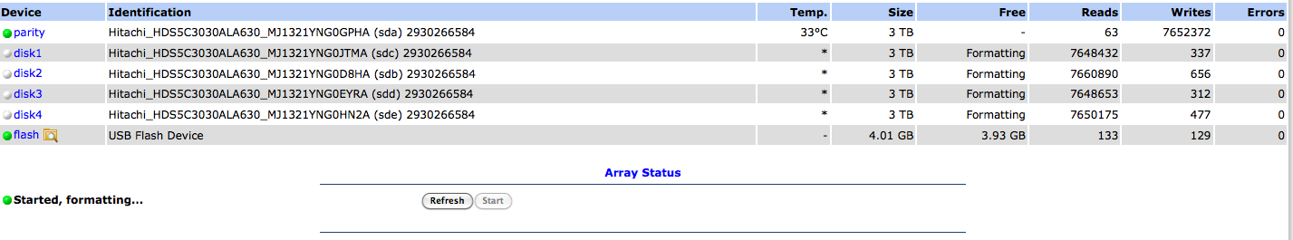

Hi
How long does it take to format the 4 disks?
Running 16 hours and still not ready.
I think it's running the reads are increasing.
But got an alert in the syslog
syslog2.doc
Update parity disk turns green and the 4 disks spin down but still the message formatting.
Rob
Click the refresh button :P
probably finished already
Thanks but did that a couple of times.
Can I shut it down safe?
Rob
You can try.  If possible, capture a syslog first.
Joe L.
Please post your syslogs in .txt format (as you did for the last one--file size will be smaller than .doc and opens quicker).
Also, I noticed your username as "Rob"--I think I recall reading somewhere to keep all usernames lower case. Not sure if that was a recommendation or a requirement, but I'd suggest making it "rob" instead, as I see it didn't like your username, and refers to it as "unknown" or invalid.

My noob fidings till now ,it's impossible to ad a 3TB disk to the array.
Precleard disks are not recognized and you get the blue bal the system start to clear the disk but that takes forever and never get finished.
Have to reboot then the bal is green and only have to format the disk.
Now parity is building.
Rob
You're too impatient. The adding of the 3TB does finish but it takes HOURS since it doesn't recognize the preclear of it.
Hi Brit
I wait about 15 Hours.
Maybe you are right but the disk where spin down and nothing hapend see my previous posts.
BJP999 I also looked at the disk.cfg file and all my disks look like this diskSpindownDelay.0="" and the spin down button doesn't work.
Rob
If your disks are being accessed they will not spin down. Setting the spindown delay to default ("-1") requires clicking the (upper) apply button on each disk's config screen.
I experienced most of the same problems you have found and they are scheduled to be fixed in beta8.
