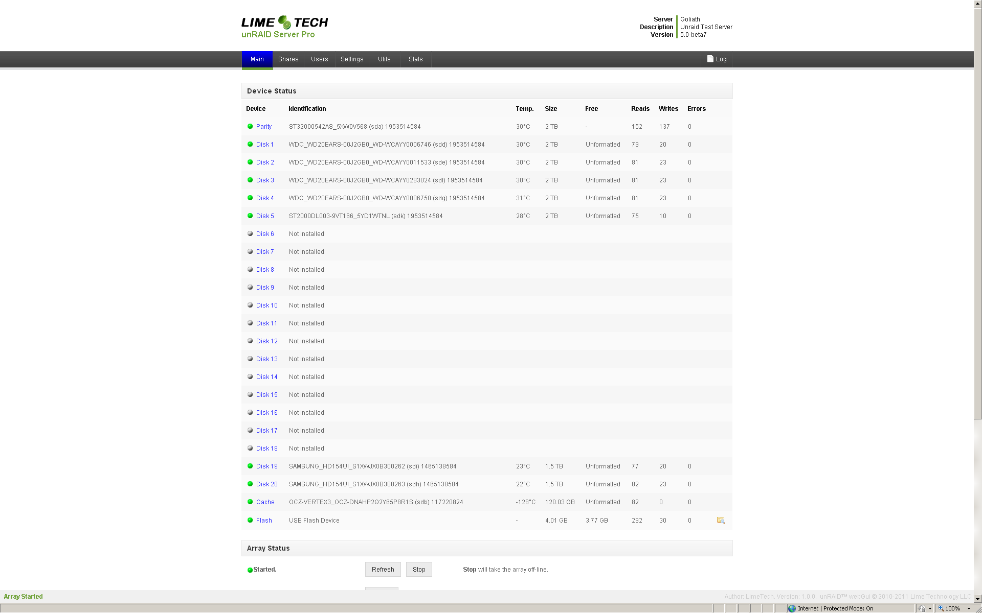

Problem:
after a reboot today, the array was stopped. as long as it was stopped i added a new cache drive and hit start.
it started up just fine. I saw the array and the correct disk usage. it also said the cache drive was unformated (it was).
I hit the "format all unformated drives" check/button combo.
"CRASH!" server just turned off! it was about the same as unpluging from the wall. no reboot.
On restart, all drives are showing as "unformated" and all data "looks" to be gone. I am guessing there is no syslog from that crash?
I'll include the first one from reboot. i doubt it helps  but just in case...
syslog-2011-07-10.zip
Ok,
I think I figured out why it shutdown. The server did email mail me.
"Emergency drive overtemp shutdown" it thought the SDD was at 128 deg.
It must have rebooted the second i joined it to the array as the cache drive.
