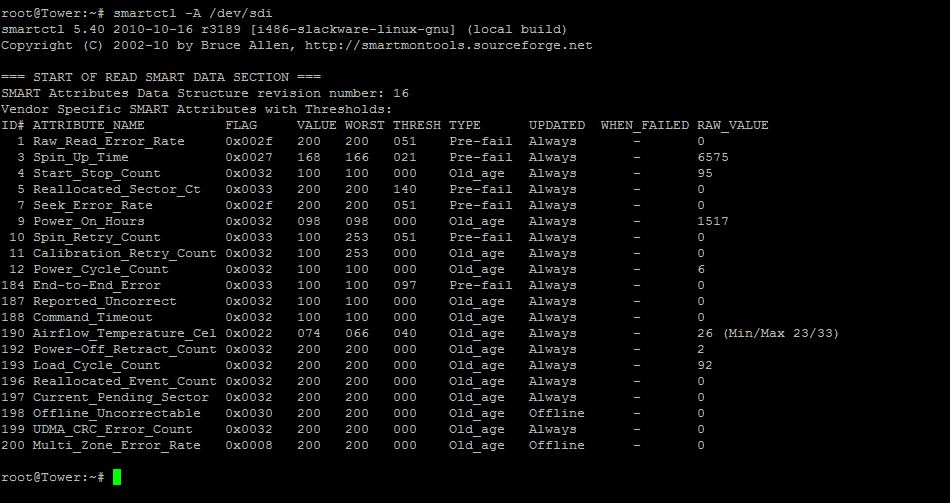

Here my screen dump of a WD20EARS showing no temps...
Bye.

Well.. i thought i was doing well.
After a reboot a drive redballed on me. it is my only gen 1 ears in the array. the array did auto start with the redball. i can also see all the data of i go to \servername\disk5. all drives except disk5 and cache spin.
I was not sure what to do, so downgraded back to 5.0 beta6a to see if was the driver.
After the drive went back to a green ball and array auto started online as OK.
I'm running  a smartcheck on the drive now.
Continued......
Ok... It passed smart.
The drive is not perfect, it has a few "issues". It has an excessive number of load counts and a "Multi_Zone_Error_Rate" of 1
It used to be in a WHSv1 server for a while. I'll assume that's what caused the high count rate. it was a known issue.
it also has a decent amount of relocated sectors. those have not changed in a while as i recall...

I'm sure this was not the intention, Beta7 now spinup/spindown the drives in VMWare ESXi using mapped raw disks, but temperatures still a non go. The tests were done using either LSI Logic SAS controller (mptsas driver) and Paravirtual controller (pvscsi driver with recompiled kernel).
If you, Tom, could fix this little temperature bug, we can dramatically improve the usability of unRAID, since the users could consolidate router / PVR / home automation / storage appliances into one physical machine.
For one of your drives that don't report temps, note what it's linux device identifier is, e.g., "sdc", and type this command from a telnet session:
smartctl -A /dev/sdc        <-- replace 'sdc' with correct device identifer
Then post the output here.
Bye.
I see the issue here, thanks!
