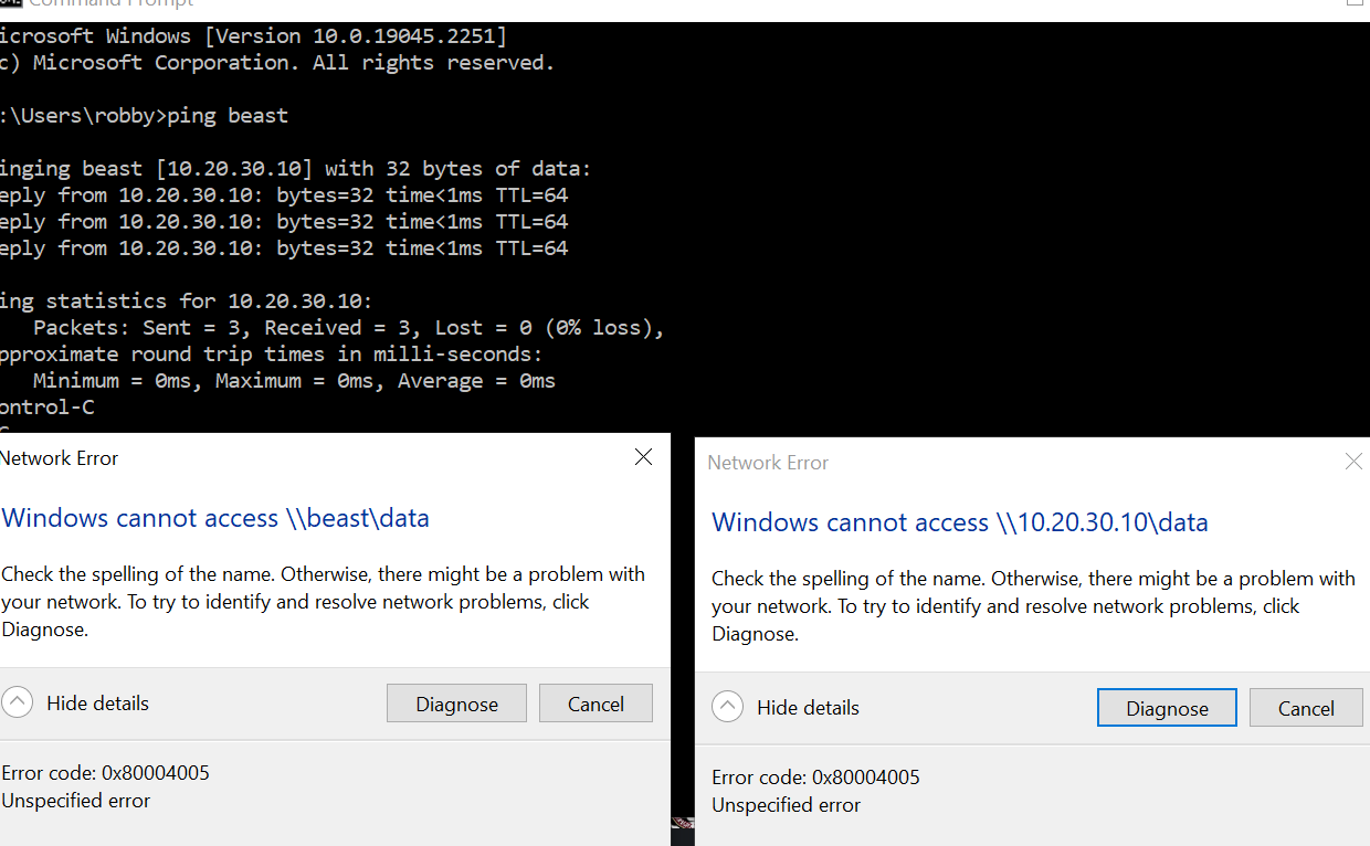

I'm having this same issue with the 6.11.3 upgrade.  I'm not using AD.

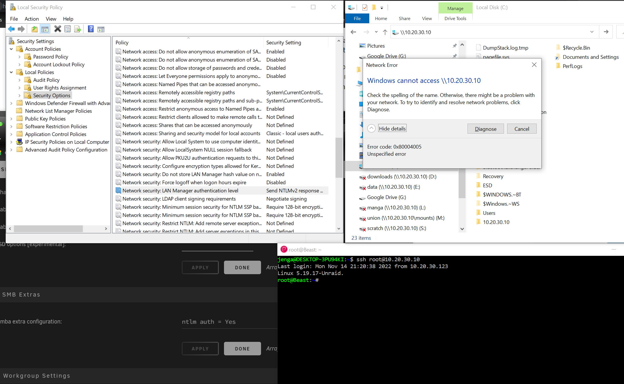

I've set "ntlm auth = Yes" in SMB Extras and set the network security GPO to NTLMv2 only (and combinations of either/or).
Are there any other diagnostics or solutions I could do to fix this issue?

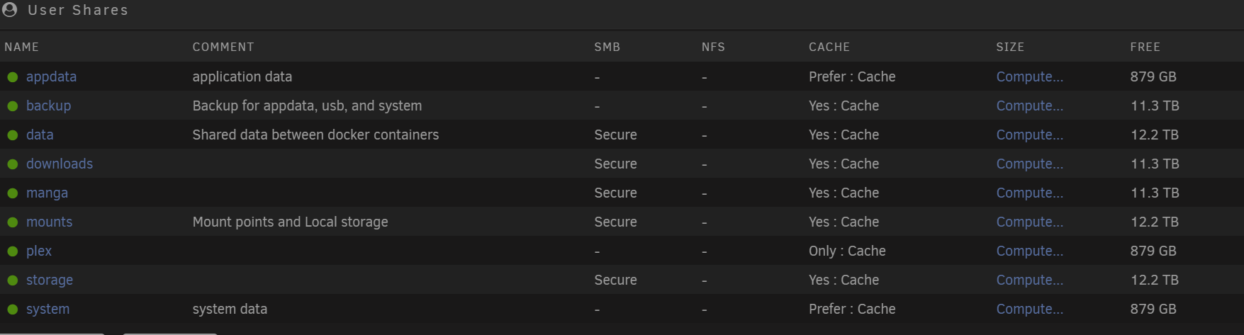

Why are you using thep ip address to referecne the server?  Use the name and see if that works.
It looks like all your shares are set up public.  Is that what you intended?
I wasn't aware accessing the shares using the IP was a problem.
None of my shares are public.
I can resolve the server name, but cannot access it through windows file explorer.  It's the same error using the name or ip.

Microsoft has changed the default and Windows 10/11 now refuse to connect to a server as a 'Guest'.  IF you insist on using a Guest login, I would suggest that you got to the first post in this thread and download the PDF file in that post.  Then read pages 15 and 16 about how to change that behavior.
    https://forums.unraid.net/topic/110580-security-is-not-a-dirty-word-unraid-windows-10-smb-setup/
