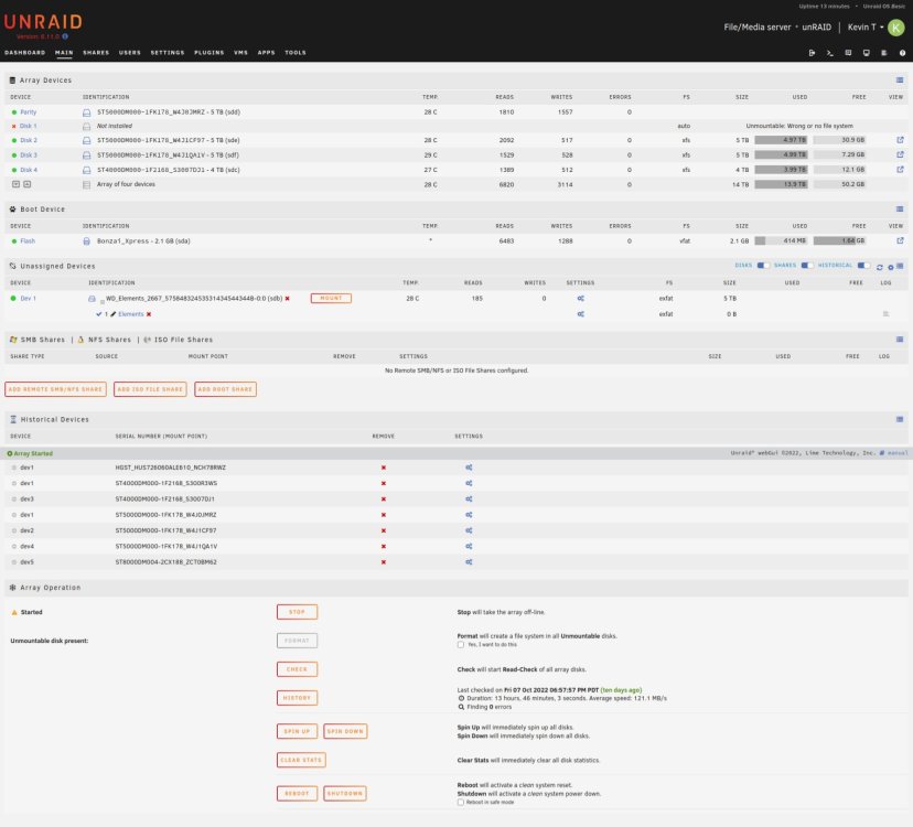

Here's the screenshot, I also ran fdisk if that helps at all.

You still haven't' posted the diags after array start.
This is why it's not working:
Oct 19 03:19:34 unRAID kernel: mount: attempt to access beyond end of device
It might work with a larger replacement device, of course it would require parity be upgraded first.
