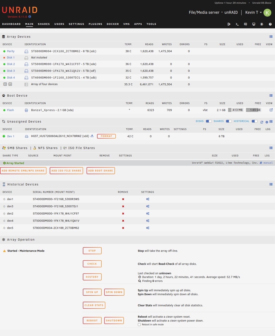

I guess with all the swapping of the Parity drives I swapped back to the newer Parity drive to do the xfs_repair and now none of the drives are showing as configured.  Sorry for the questions, but I want to be safe than sorry but since I have the option at the bottom Parity is already valid, do I have to still do a New Config again?  Also I noticed at the top right of the Parity drive it says "All existing data on this device will be OVERWRITTEN when array is Started", do I need to worry about that?  Screenshot is below.
You have to repeat the complete procedure again.

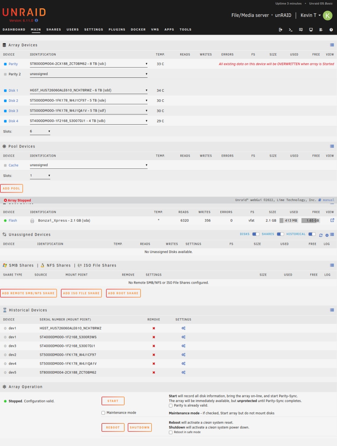

Do I have to worry about "All existing data on this device will be OVERWRITTEN when array is Started" at the top right of the Parity drive?
Edited by Kevin T
On 10/1/2022 at 11:43 AM, JorgeB said:
-IMPORTANT - Check both "parity is already valid" and "maintenance mode" and start the array (note that the GUI will still show that data on parity disk(s) will be overwritten, this is normal as it doesn't account for the checkbox, but it won't be as long as it's checked)
Oh ok, the wording was different.

And this is what I'm getting now with xfs_repair in Maintenance mode:
root@unRAID:~# xfs_repair -v /dev/md1
Phase 1 - find and verify superblock...
bad primary superblock - inconsistent filesystem geometry information !!!
attempting to find secondary superblock...
.found candidate secondary superblock...
verified secondary superblock...
writing modified primary superblock
        - block cache size set to 142328 entries
Phase 2 - using internal log
        - zero log...
zero_log: head block 181991 tail block 181938
ERROR: The filesystem has valuable metadata changes in a log which needs to
be replayed.  Mount the filesystem to replay the log, and unmount it before
re-running xfs_repair.  If you are unable to mount the filesystem, then use
the -L option to destroy the log and attempt a repair.
Note that destroying the log may cause corruption -- please attempt a mount
of the filesystem before doing this.
It's a good sign that it's finding something, run it again with -L.
It's saying to mount the filesystem but Maintenance mode doesn't mount so should I stop and restart the array regular or just remain in Maintenance mode as it is right now?  Also what's the exact commandline please, I don't want to screw anything up.
UPDATE: Running xfs_repair -L /dev/md1 -hopefully that is correct
Getting tons of messages and writes to the Parity drive
Alot of resetting inode and Metadata corruption detected messages.
Edited by Kevin T
The filesystem likely won't mount, so -L is the only option, but you should have already tried to mount it, it's part of the instructions, did you?

This is what it's showing now:
Edited by Kevin T
I mentioned before that you should repeat the complete procedure again, the end of that is this part:
-Start array (in normal mode now), ideally the emulated disk will now mount and contents look correct, if it doesn't you should run a filesystem check on the emulated disk
-If the emulated disk mounts and contents look correct you can access it or even rebuild, to rebuild stop the array
If you did not do that do it now first, disk likely won't mount but you should confirm.
It appears to be emulating Disk 1 (see below) but there is alot of free space and I believe the disk was pretty full before.  Weird it's showing the Disk 1 as 6TB but the original one was 5TB, is that because I originally assigned the new drive which is 6TB and removed it?
There's tons of folders/files in the lost+found directory on Disk 1 it's showing 29226 objects: 23985 directories, 5241 files (38.1 PB total)
Do you think that's the best I can do on recovery from this parity or are there other options?  Also should the files be okay that are still present and not in lost+found?
I'm thinking to still try the other parity when I get the additional drive in a couple of days and will probably just backup what is on here if I'm out of options with this parity.

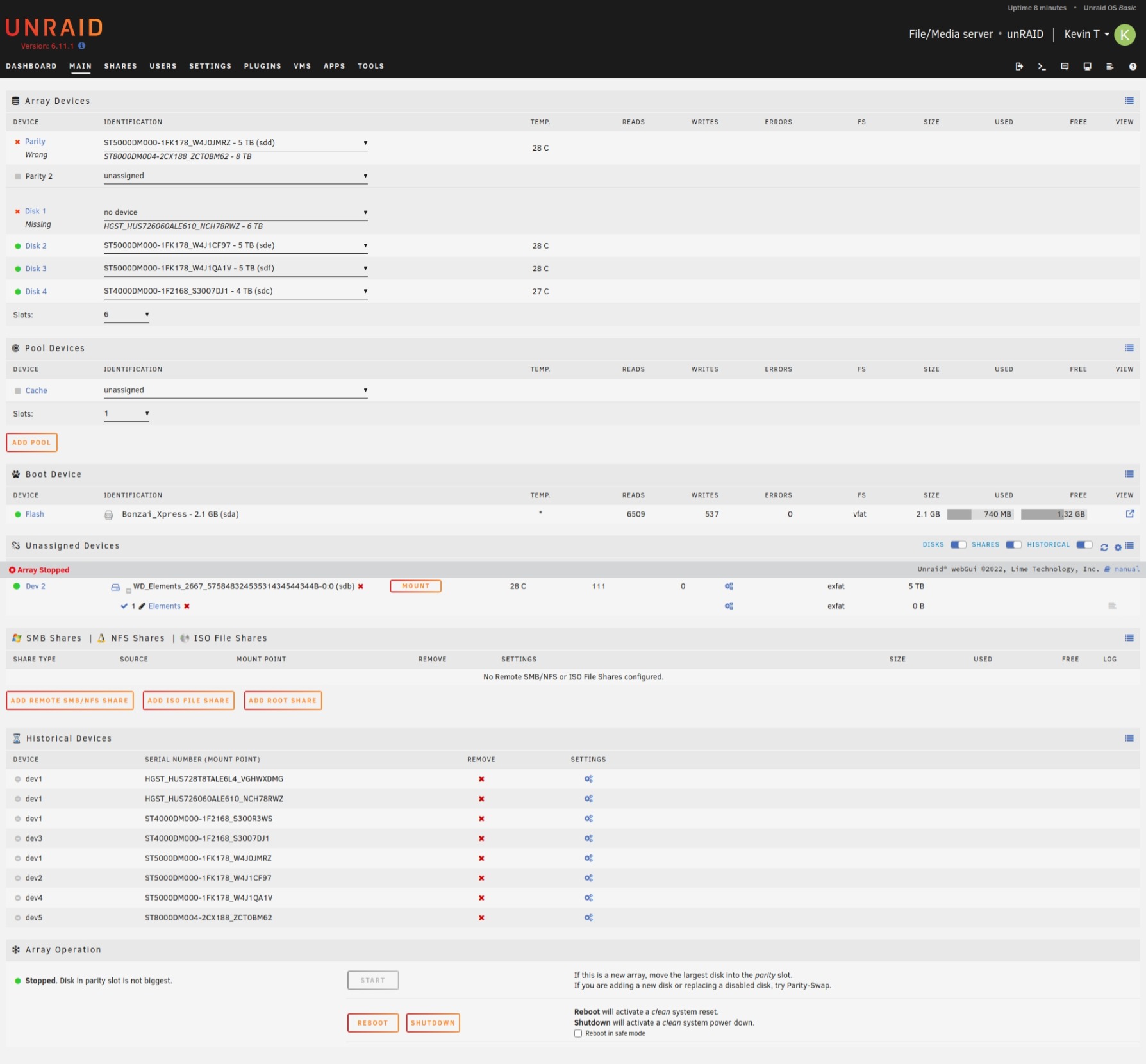

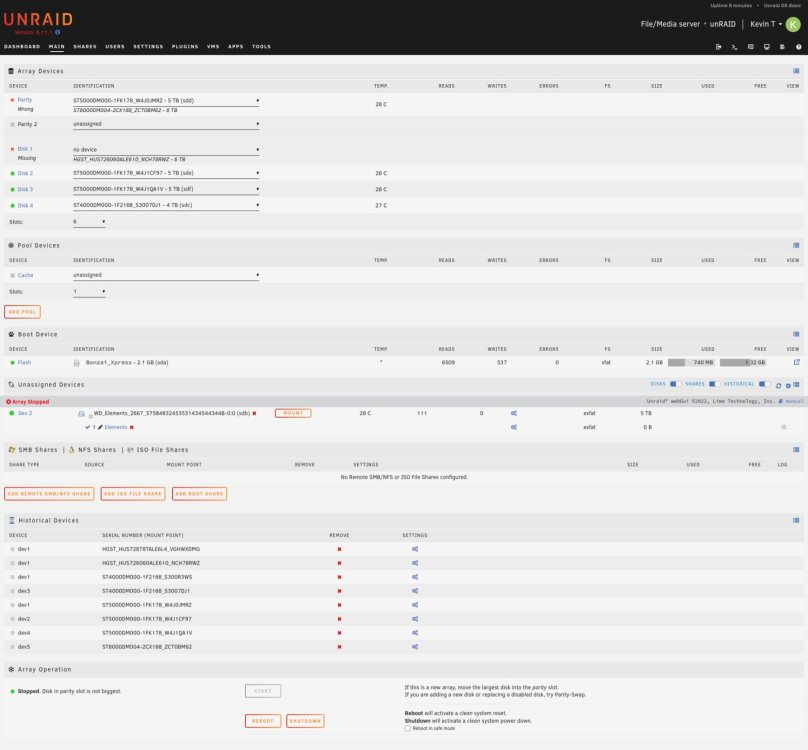

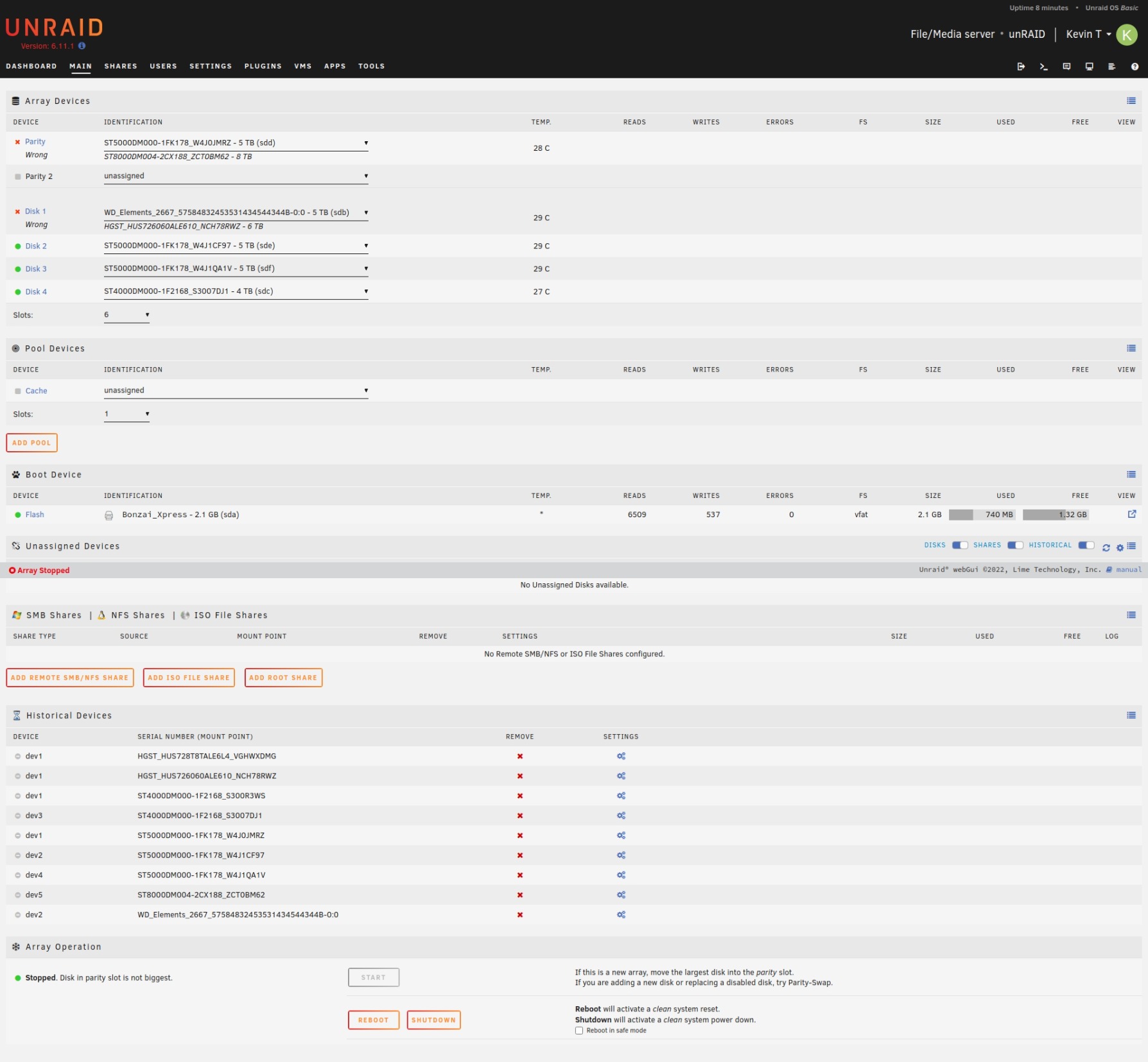

Hi, well now I'm completely confused, I got another 5TB drive as a Disk 1 placeholder so I can use my original Parity drive.  I put all my old original working drives back in (which are all the same models and sizes except the Disk 4), ran the New Config and now I'm getting this message:
"Disk in parity slot is not biggest"
It seems to be a bug.  I just upgraded to 6.11.1 from 6.11.0 earlier today so I thought it might be a bug in the new version, but downgrading didn't resolve it.  Here's all my screenshots of all my drives, the new 5TB is an external and it is showing a larger partition size, but even if I exclude it, I still get the same error.  I included screenshots of with it both included and excluded, with the same message, as well as the drive info on all the drives.
Any thoughts how to circumvent this?
Do a New Config again so it forgets any previously assigned disks
