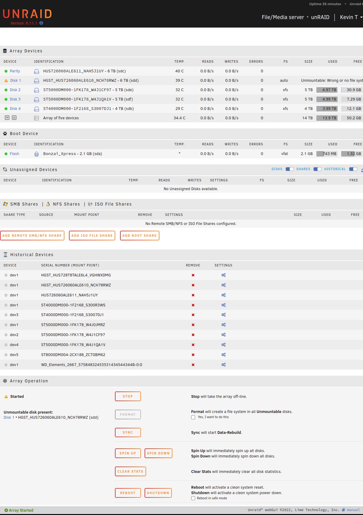

Ok I see what you're saying, it's weird why it would think it's larger when there was nothing wrong with this parity drive.
So if I try another 6TB disk for Disk 1 after the parity swap completes, do I just do the New Config process again?

Nope, you just replace disk1 with a 6TB, you could cancel the first rebuild to the old parity, replace it it with a 6TB disk, start the rebuild and cancel after a minute, and that would be enough to see if xfs_repair now works, if yes you can than complete the rebuild.

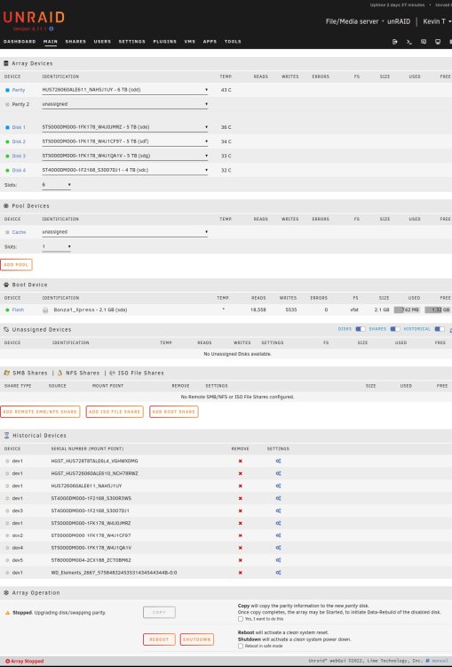

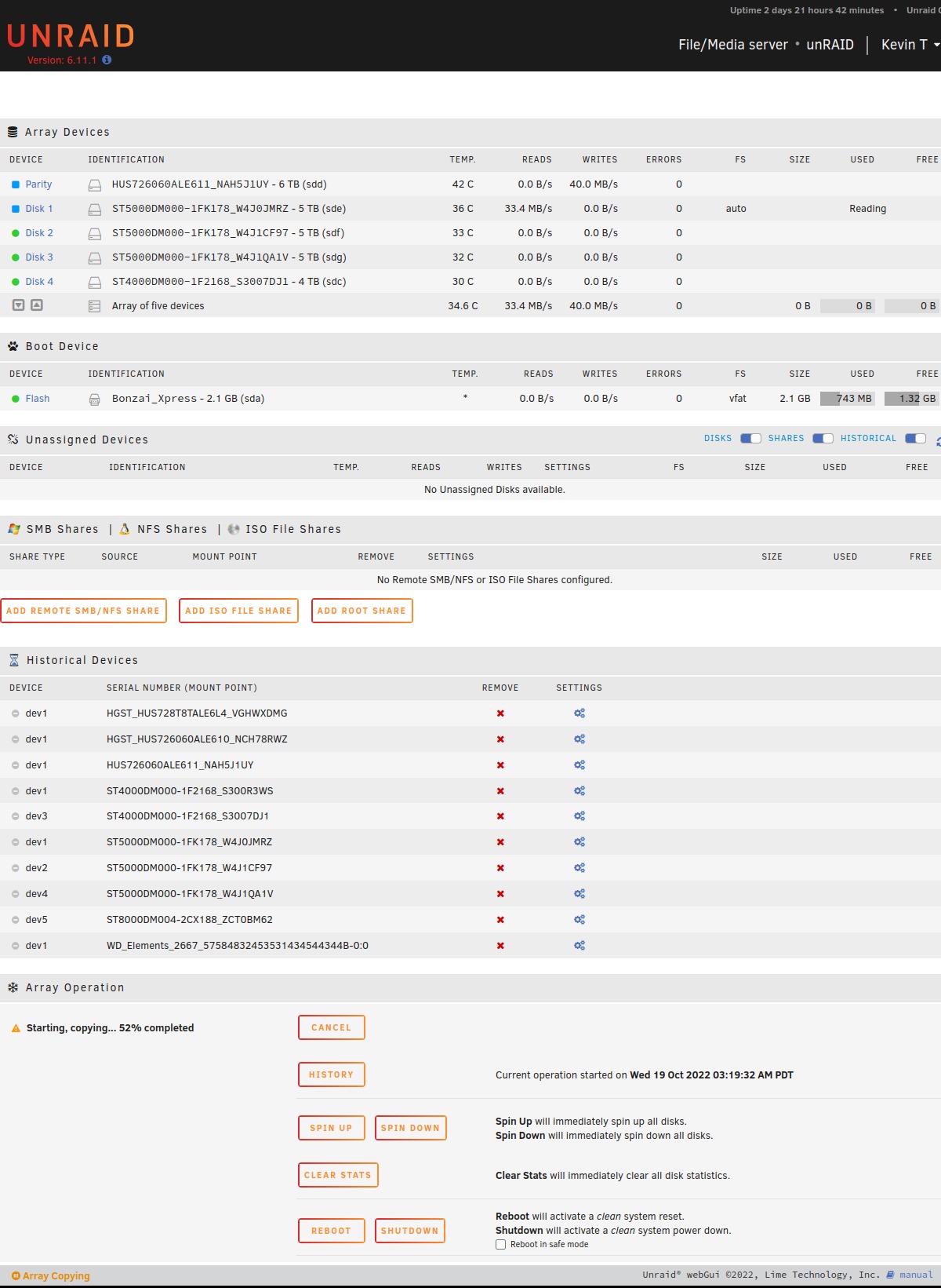

I was trying to follow the Parity Swap instructions but I preferred a Spaceinvader One video instead (https://www.youtube.com/watch?v=MMlR0TMeKsI) .  I let it run for about 1 1/2 days (it ran through the percentage over time) but what is weird is I saw it say Reading next to the old parity 5TB in Disk 1 but never saw it say Writing next to the newer 6TB parity as the video showed and now it is saying "Copy will copy the parity information to the new parity disk.  Once copy completes, the array may be Started, to initiate Data-Rebuild of the disabled disk."  So did it copy or do I have to do it again, it just has the option to select "Yes, I want to do this" and the button says Copy (and no Start button).
Edited by Kevin T
According to the screenshot copy didn't complete, also note that you cannot change anything once it's done (or reboot the server), just press start to begin the rebuild.

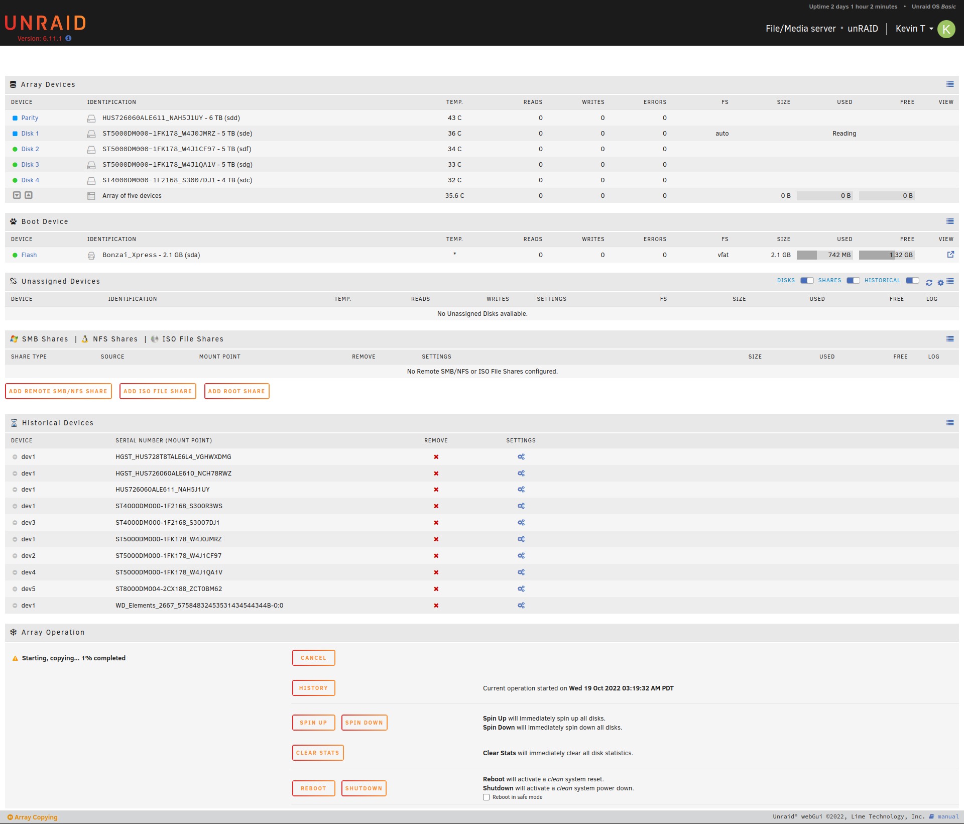

Ok I just started it again but notice how it says Reading but nothing about Writing?  It was like that before as well.  The video showed both and had Writing next to the Parity.
That should be just a GUI issue, you can also post the diags to see if it's going OK.

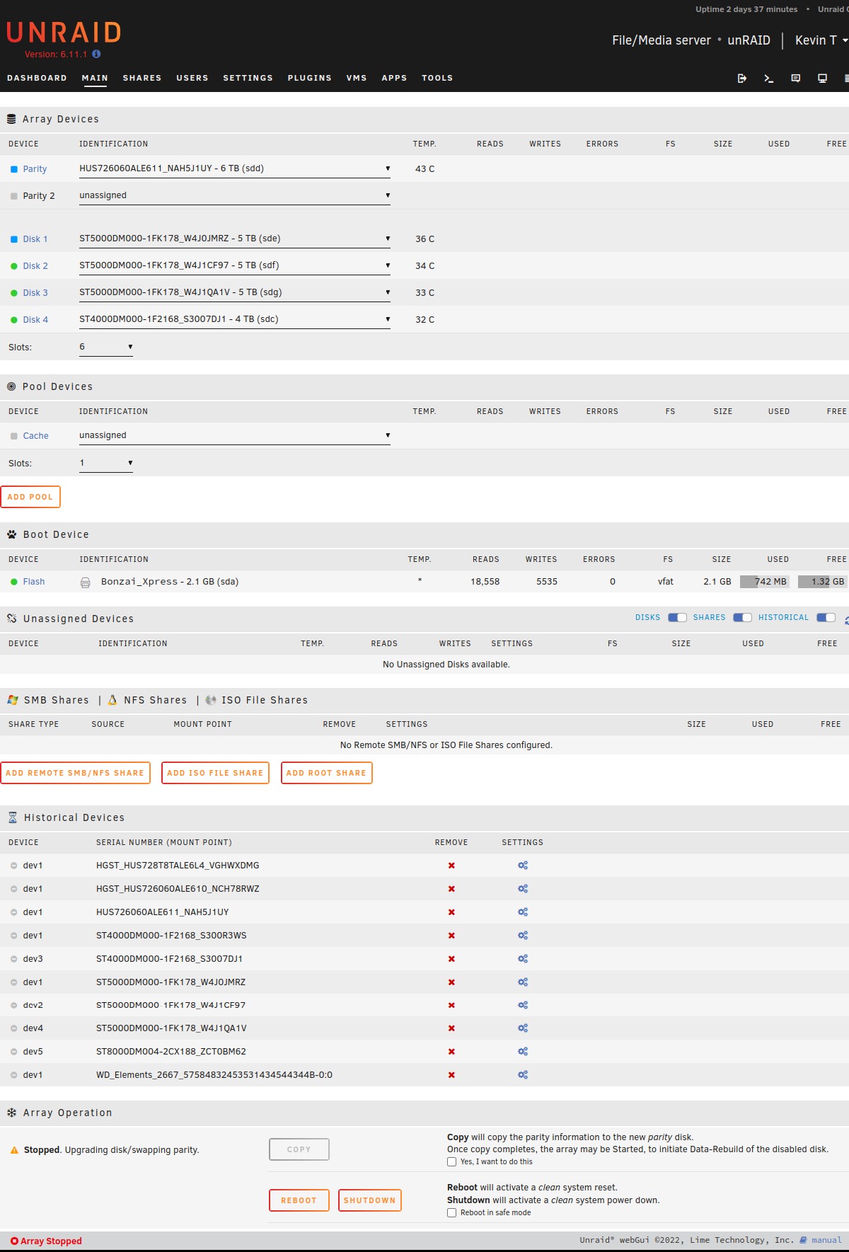

Here's an updated screenshot and current diagnostics, it's currently at 52% copying and I switched the view so it is showing writing throughput on the larger parity but still not saying Writing anywhere and just Reading next to Disk 1 (original parity).

It's a GUI issue, I can see in the diags that it's writing to parity, and nothing out of the ordinary logged so far.

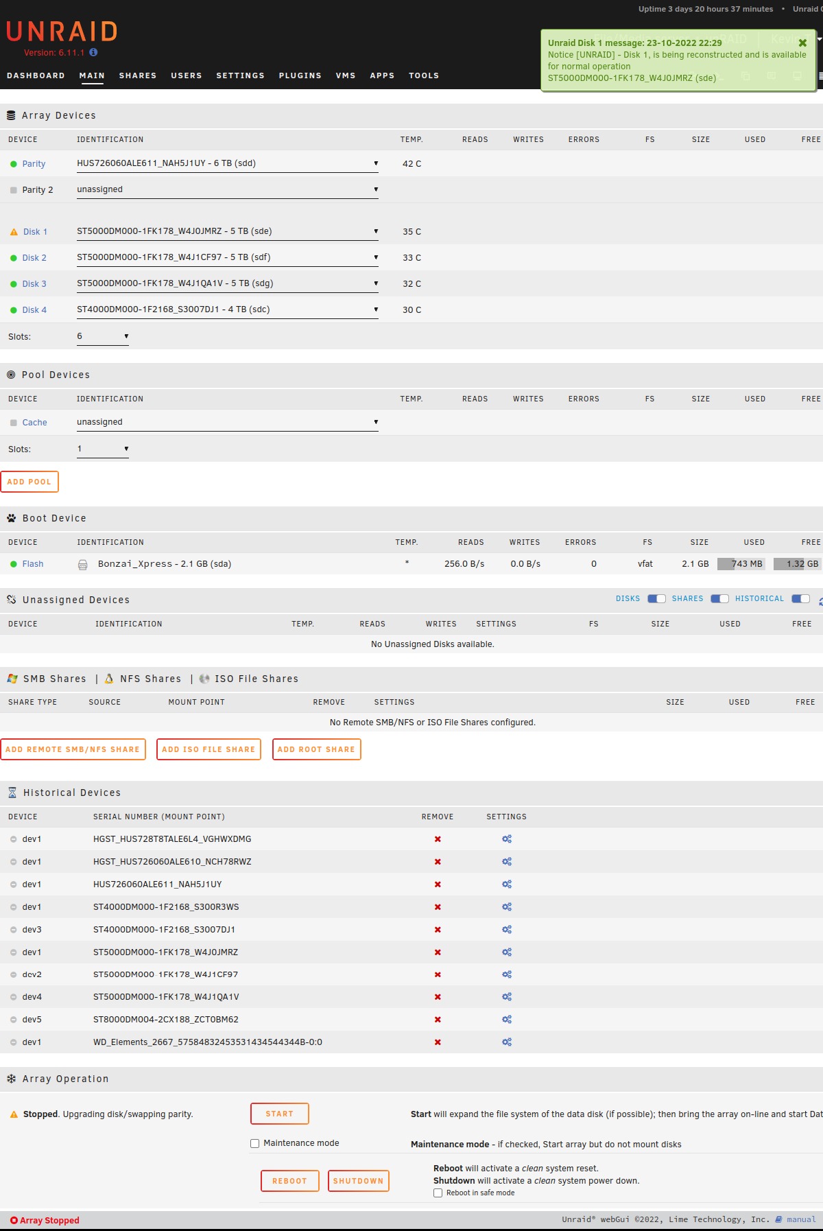

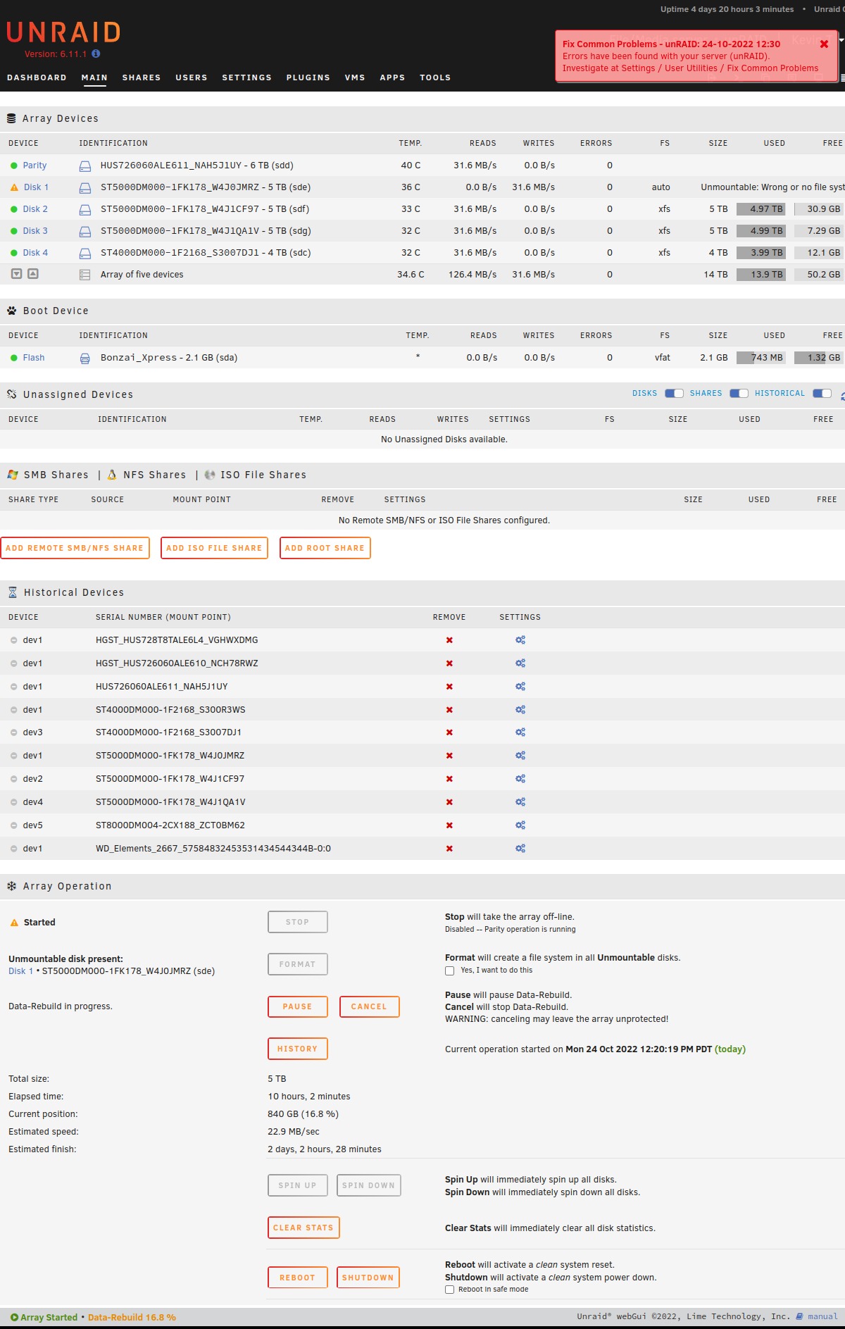

It got done copying the parity to the 6TB disk a few minutes ago, I attached a current screenshot, notice the message about Disk 1 being reconstructed and available for normal operation?  If I highlight over the triangle next to Disk 1 it says device contents emulated.
I'm just being cautious and again the original Disk 1 was the same made/model/size that is currently inserted for Disk 1 so do start the array as is and see what happens or do you think I have to use a 6TB for replacement for DIsk 1.  Do I need to run xfs_repair at any point to check?

Did you start the array to begin the rebuild after the copy finished?
No, not yet, that's what I was asking about if I should let it complete because I thought you said something about stopping it after it started and I wanted to make sure the best way to proceed.
After the parity copy completes you must start the array to begin the rebuild, without changing anything else, or will need to start over.

That's probably why I had to start over because I was unassigning disks.  It's saying Disk 1 is unmountable right now so do I just let it run completely?  There aren't any options other than to Pause or Cancel Data-Rebuild.

You just need to start it, you can now cancel and replace disk1 with a larger disk.
Ok I will cancel, I have to shutdown to replace disks so afterwards do I do New Config and check parity is valid or just replace Disk 1 and rebuild?
Just replace the disk, start the array to begin the rebuild, let it run for a couple of minutes, cancel the rebuild and run xfs_repair.

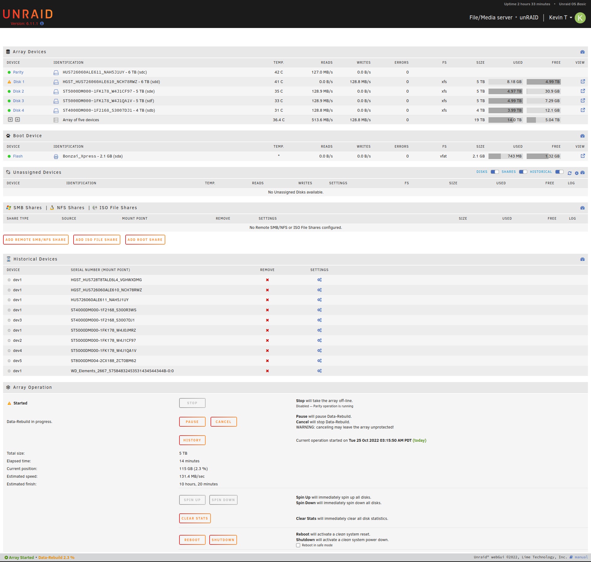

I ran it with -L, then after it completed, stopped the array and restarted it for data-rebuild which shows the drive at 5TB and the XFS filesystem but there is nothing on the drive other than a lost+found directory with hardly anything in it and an empty appdata directory, total space used is only 8.18GB with 4.99TB free, so practically everything is gone.
Any other options?  I really thought with this being the parity drive replaced before issues started that most of everything would be recovered, so I'm really shocked and upset that it was basically empty.

Assuming all was done correctly that suggests parity was far from valid with that config.
That's weird, it was working when it was pulled unless something went bad along the way, was my original 5TB shot during the parity copy?
