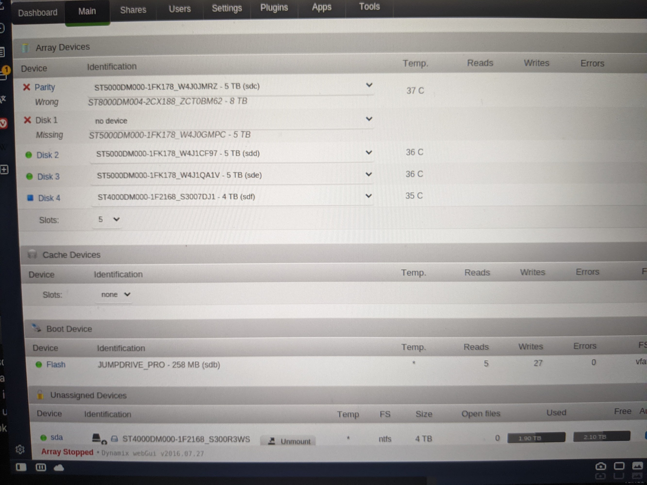

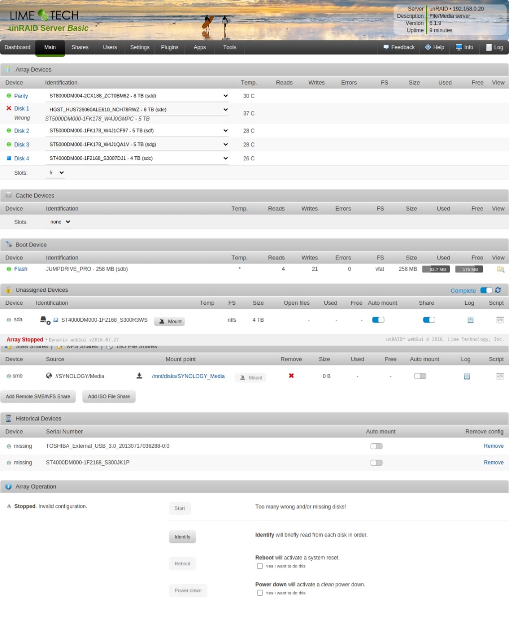

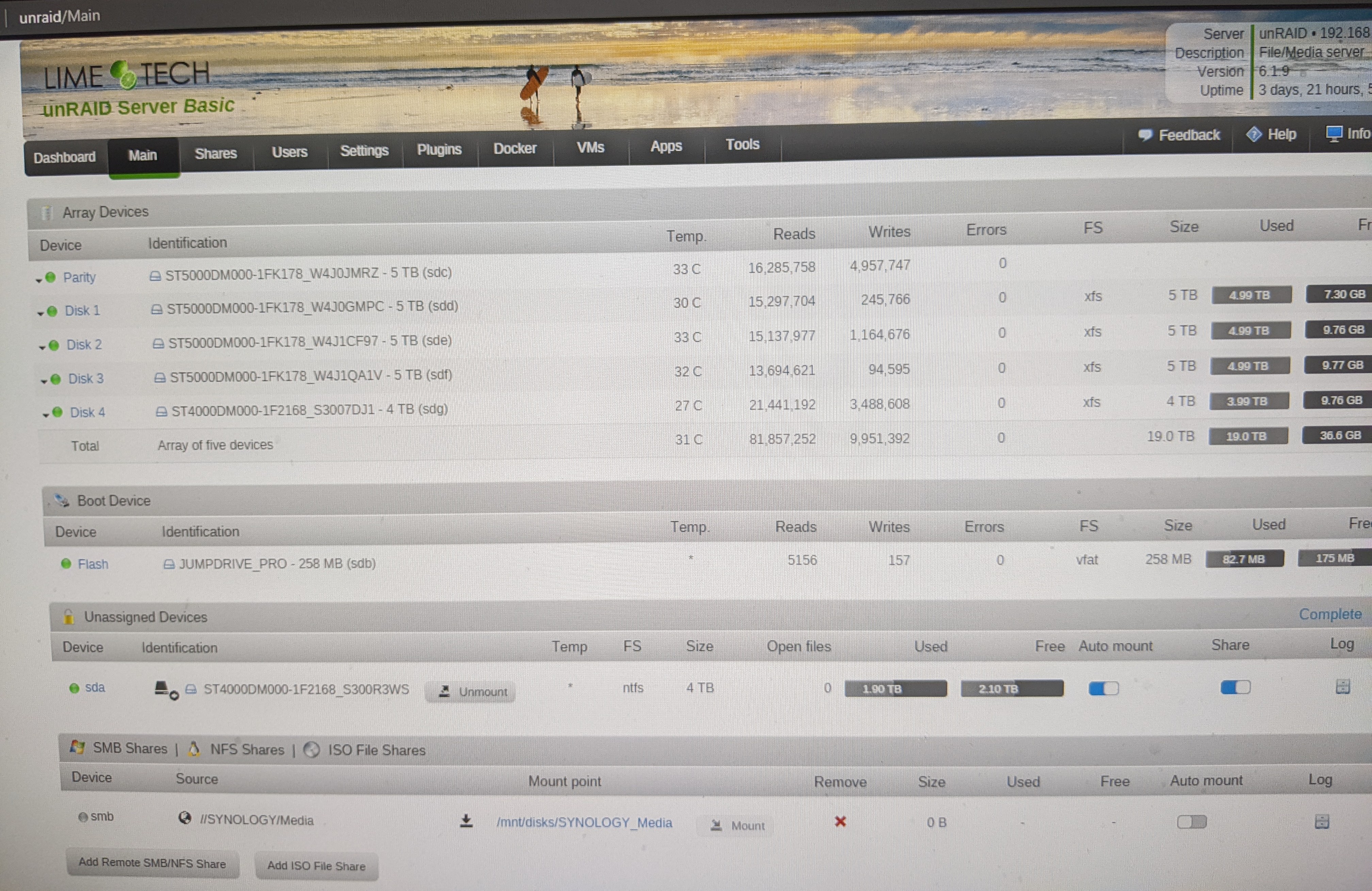

I attached a couple of pictures I took, before and after the issues, the first picture was taken before I started trying to upgrade the drives in November when everything was fine.  Disk 1 is the only that completely failed and is not recognized at all even though it is in place, I still have the original Parity 5TB and Disk 4 4TB which I put the Disk 4 back in since the one I did the upgrade also failed.  The newer Parity 8TB seemed to upgrade okay so I put that in as you suggested.

Why photos instead of screenshots? We may need to see more screenshots along the way as we proceed since what you are looking at is something we haven't seen in a few years.
That's all I had available, they were taken previously and they were for my own quick reference and I planned on deleting them afterwards, I had no idea I would have issues with it at the time.
Everything's shut off right now, if you want screenshots let me know what you want them of and I can turn it on , I just want to keep it to a minimum since I had 2 unexpected drive issues within a day's time and don't want another one.  I'm ready to do something on it now, I just need to know how to proceed.

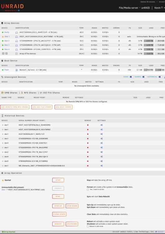

I have the new drive installed to replace Disk 1 (note it is now 6TB but was originally 5TB), screenshot shows all the correct drives (Disk 4 shows as new since the new one failed so I had to revert to the original one).  I also included a screenshot under New Config, I'm not sure if what is says is normal.

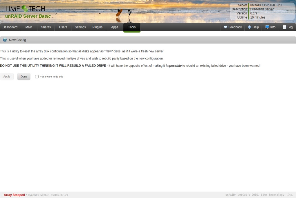

What about the message on the New Config page in the screenshot above that says "Do Not Use this Utility thinking it will rebuild a failed drive", it is safe to check the box and proceed?

The instructions should still work fine with v6.1.9.
Now that I think more about I'm not sure that the "parity is already valid" option worked with v6.1.x, I believe there was a bug with that, @Kevin Tmake sure you update first.

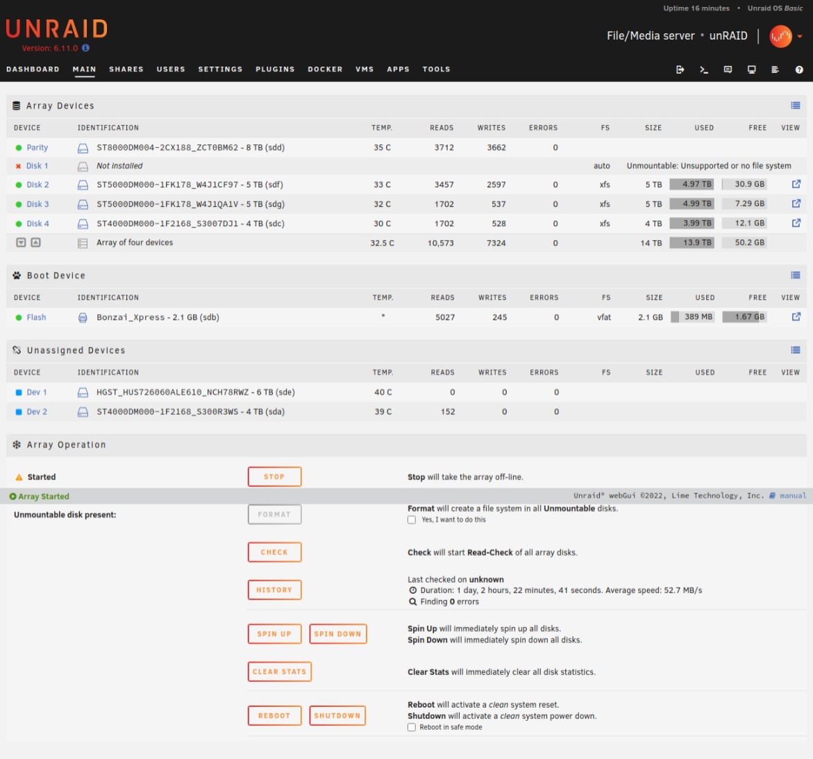

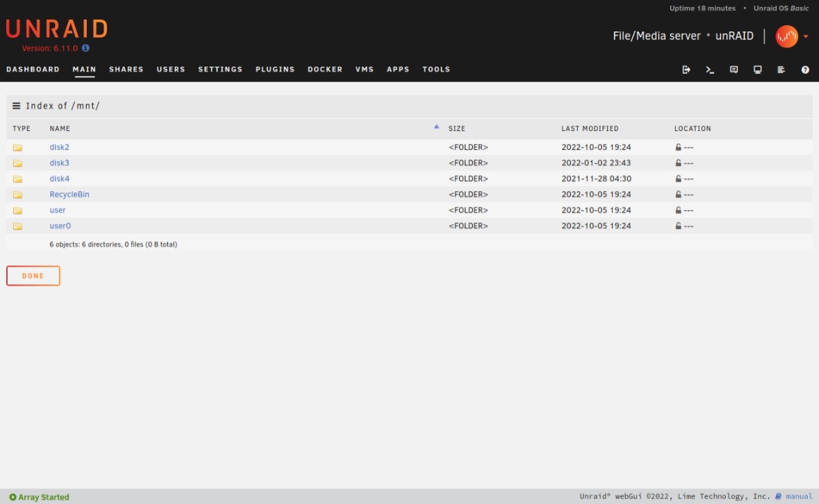

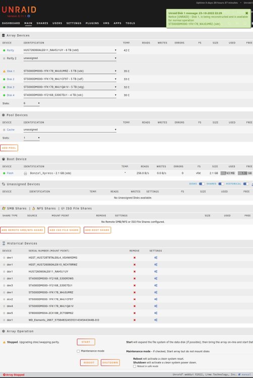

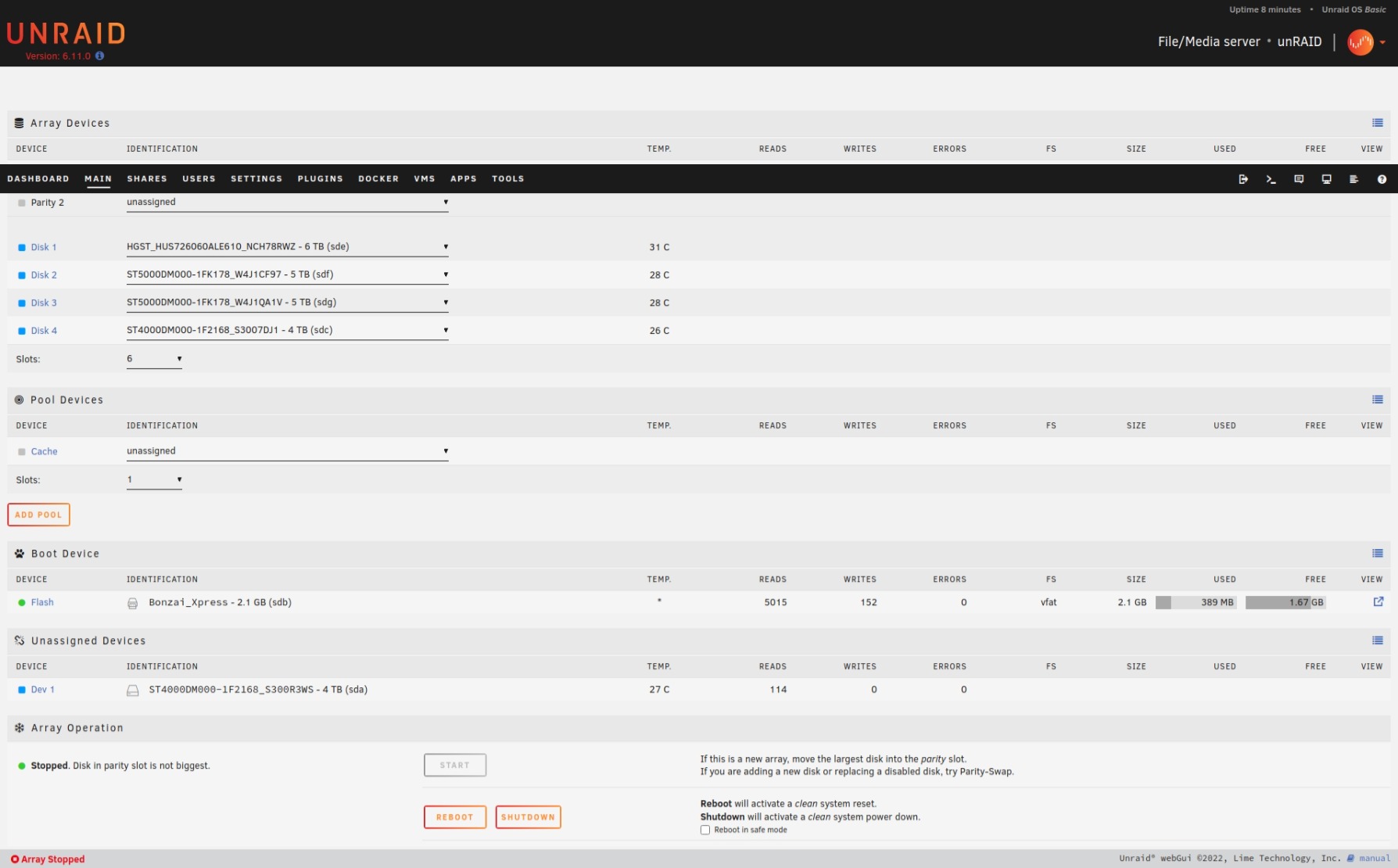

I upgraded to 6.11.0 and followed the steps above, but after I unassigned Disk 1 and restarted the array normally, below is what I got.  I don't think this is right so I just stopped the array and not sure what to do.  When browsing it appears Disk 1 is missing.
I do have another previous Parity drive prior to me trying to upgrade drives before everything went screwy if it helps at all.  The current Parity is throwing a SMART error.
I also added new Diagnostics if needed.
unraid-diagnostics-20221005-1956.zip
Edited by Kevin T
No valid filesystem in being detected on the emulated disk1, that suggests parity is not valid, are you sing new or old parity?
I was using the new Parity, but it is the one after I started having issues.
I was originally upgrading to larger drives, so I did the Parity first which was a 5TB to an 8TB, which was successful.  Then I did Disk 4 which the drive failed during the rebuild process and it won't recognize in BIOS (but I still have the original Disk 4 which I put back in and is fine).  While that one was failed and before I could do anything else on it, I just accessed Disk 1 to copy a small file locally and the whole server locked up.  Then Disk 1 wouldn't recognize either in BIOS.
So I'm not sure if those events affected the new Parity drive, which is the same one I tried (the 8TB).  I still have the original 5TB Parity untouched.  And again, both these Parity drives were within the same day so it's not like the old one was sitting around for months.
Edited by Kevin T
By your description parity should still be mostly valid, but at leas with the new one it's not, you can try repeating the procedure with the old parity.

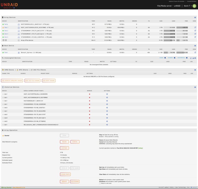

Ugh, with the old Parity drive it's giving me a "Disk in parity is not biggest" message, I guess because my new replacement Disk 1 is 6TB even though I wasn't using all of it and I don't have any more 5TB drives that work.  It also says "If you are adding a new disk or replacing a disabled disk, try Parity-Swap", not sure what parity swap is.
I'm trying to do the Disk 1 assignment then unassignment and I have one unassigned external 4TB drive in the system but it has data on it (it says "All existing data on this device will be OVERWRITTEN when array is Started" next to the Parity drive when I select this drive for Disk 1), is there anyway to use that (or another drive) as a placeholder?  I wasn't sure in that process if the same or larger sizing restriction applies.
Or I do have a new 8TB I was going to use as the future Parity drive, is there a way I can clone the 5TB Parity to my new 8TB so I could use it instead so I don't have a size issue?
Or any other ideas?  This is more frustrating than I thought it would be.
