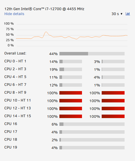

This works, the VM starts, but boy the CPU is not liking it, its constant 80 to 99%
Edited by VladoPortos
spelling
Link to comment

I would expect to see more load as the cpu is going to be emulated rather than passthru. But would need to test.
Link to comment
I'm not really seeing a difference. I also ran comparisons with Geekbench and the difference in performance seems like none. I got a lower score when using host passthrough rather than emulated which was probably just by chance. If I am correct maybe this can be something that can be added as an option in the GUI down the line. I have WSL working fine and my server is sitting at idle right now with the VM running in this configuration. I'm not home right now so it's got to be 80 degrees Farenheit in my apartment with the AC off and my CPU is sitting at 37 degrees celcius currently. From my testing I see no difference other than nested virtualization working. If there is anything I can do to help test performance let me know!
Edit: Perhaps if this is a viable solution it may be helpful to make a more visible thread to help other users. I've seen a bunch of threads on this issue and it may be helpful to consolidate the discussion into one place.

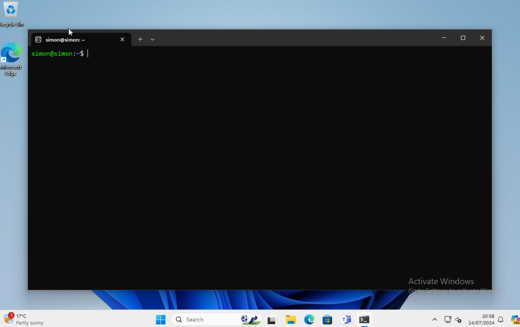

I recently got a Razer Blade (Razer Blade 17 _2022_ - RZ09-0423) which shipped with a 12th Gen Intel® Core™ i9-12900H × 20. Using
<model fallback='allow'>Skylake-Client-noTSX-IBRS</model>
was not going to work.
I ran
virsh capabilities
and learned that I have a
<model>Broadwell-noTSX-IBRS</model>
Before I installed my Windows 11 VM under KVM in Ubuntu 22.04.3, I edited the CPU XML configuration, and removed host-passthrough and manually used just this. Note: "cores=8" because the number of vCPUs allocated to my Windows 11 machine was 8. You will want these numbers to match, or Virtual Machine Manager will complain.
  <cpu mode="custom" match="exact" check="partial">
    <model fallback="allow">Broadwell-noTSX-IBRS</model>
    <topology sockets="1" dies="1" cores="8" threads="1"/>
    <feature policy="disable" name="hypervisor"/>
    <feature policy="require" name="vmx"/>
    <feature policy="disable" name="mpx"/>
  </cpu>
This worked with great success. Windows 11 installed successfully, and I got an Ubuntu WSL 2 instances running inside my WIndows 11 VM. Attempting to change the CPU XML configurations in Virtual Machine Manager AFTER installing Windows 11 was a fool's errand.
The performance hit may likely be remediated by appending the other CPU features as outlined in virsh capabilities.

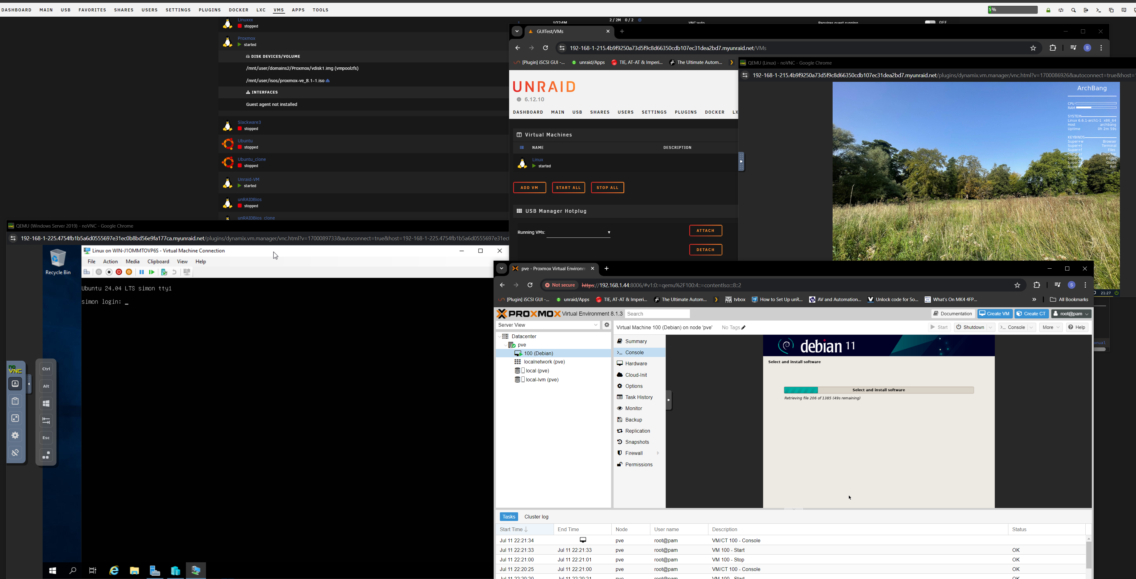

This fixed the VM not booting.
However I was attempting to do some nested virtualisation and it's just not possible.
I have the following I can run on my Dev/Test machine.
Unraid host
Unraid VM running a Linux ArchBang
Win 2k6 with Hyperv and Linux.
Prox with Linux
Also can run windows with WSL.
Do you have an Intel CPU? I've been trying to run WSL on a 12700k for so long now. Is this working now in 7.0.0 beta2?
Link to comment
Yes I have a 12600K in my test server, Was running before beta2 attached is the XML.

On 7/20/2024 at 4:51 AM, mackid1993 said:
I wonder if we could emulate a newer CPU. Emulating Skylake may cause issues with Windows 11.
Sadly this seems to be the case, as I'm having severe stability issues on the VM when gaming with this "custom" CPU passthrough method.
I'm not exactly sure why but after 20+ mins of solid gaming without any FPS drops / lagging the VM starts to lag hard, it never locks up totally but FPS drop to 10 FPS. Sometimes the VM recovers after 1min but it quickly drops to 10fps again, other times the FPS drop and then starts bouncing between 10 to 60fps ( have set a global limit of 60fps ) but it never fully recovers until a fully shutdown and reboot of the VM.
There seems to be no specific reason for it, as the VM was working absolutely perfectly with heavy loads before the FPS drops. Changing settings within the game has zero effect on this outcome or how the VM runs in general. I've mainly been using GTA5 to test but it doesn't matter the game at all.
I reverted back to the standard CPU passthrough mode applied by default in Unraid to test. I can see the moments where the VM starts to struggle but it always recovers quickly and FPS come back up, settings within the game most definitely have an effect on stability in this type of CPU passthrough.
It's almost as if certain features of the CPU are not being enabled correctly as @mackid1993 has pointed out, but I don't know how to go about proving that theory.
The only reason I'm using a custom CPU passthrough is because its the only thing that allows Roblox to be played within a VM as mentioned in my previous comment. Ive exhausted all other avenues to achieve this and I have no idea why the custom CPU passthrough allows Roblox to work but it does. Sadly that brings other no serious issues along with it.
Attached are both XMLs in .txt files
As always any advice or knowledge is much appreciated.
2024-07-20 - Windows 11 - Gaming VM - Custom CPU passthrough.txt 2024-07-27 - Windows 11 - Gaming VM - XML - Default CPU passthrough.txt
