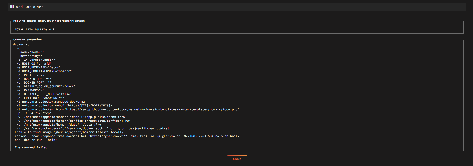

I'm trying to install homarr and get this error:homarr_install_error.thumb.PNG.4ebb1278ca0014b18317068bf5caecd6.PNG
Is this a known issue? Any help?
Thanks
