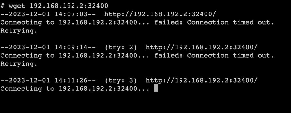

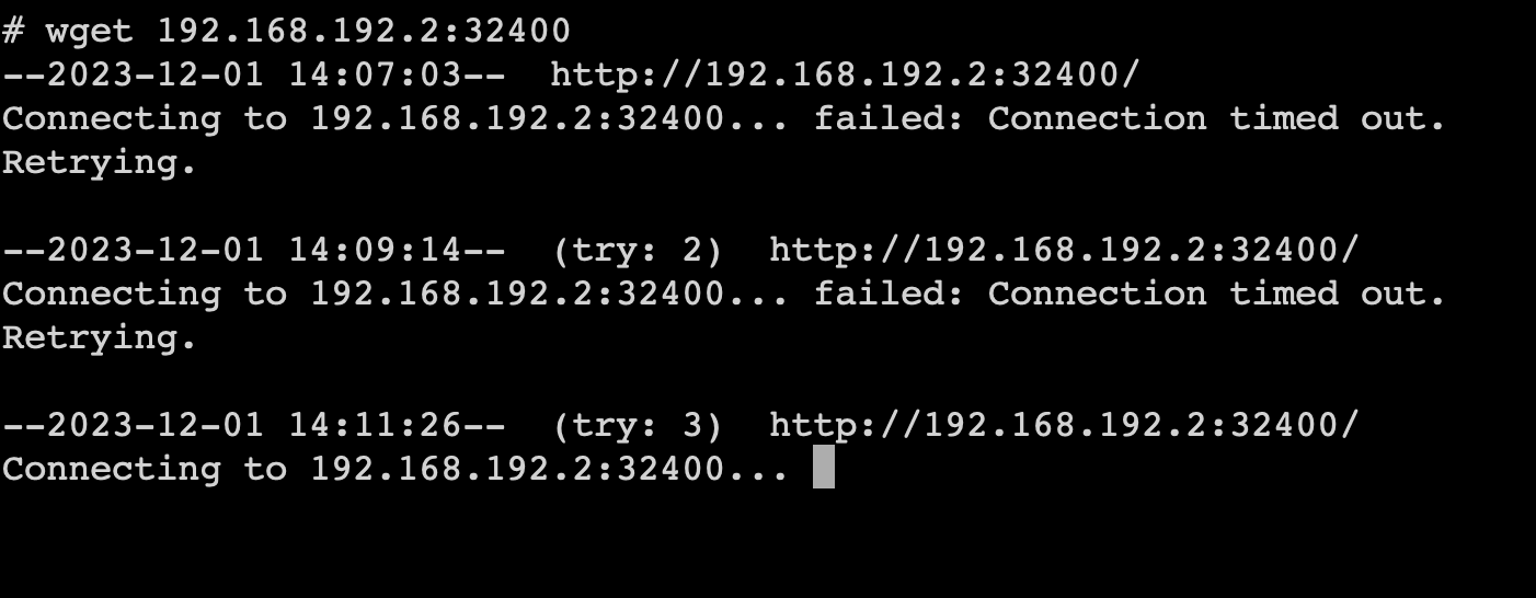

Just now, Keek Uras said:
Unfortunately no. The console opens for a few seconds and then disappears. I can resolve the FQDN from the console within unRAID but can't ping the IP. Both the server and my box are on the same network, so that makes no sense.
Oh, so you executed the commands on your PC / Laptop instead of Unraid in your first message?
If the Unraid machine can't ping the IP, it is pretty clear that something in your network is blocking access.
Since this is not related to the template, it is likely that you'll have to figure it out yourself:
- Is the IP being resolved from the FQDN the same on your Unraid as on your PC? If not that might be a problem.
- Do you have VLans / conditional routing for your devices?
- Do you have multiple subnets / DNS in your network?
It doesn't make sense that I can't reach it from unRAID but can on my local PC. They are on the same subnet, and there are no VLANs. No traffic egress is blocked on my network.
Neither the FQDN or the IP can be reached from unRAID. Both are reachable from my local PC and nslookup for the site works on both unRAID and my PC. I'm using quad 9 for primary DNS & cloudflare for backup DNS on my Firewalla.
Sorry for the delay. I finally figured out the issue. The IP was offered up as malware on my Firewall and I had blocked it, not recognizing the IP. After removing the block, I can now access it.

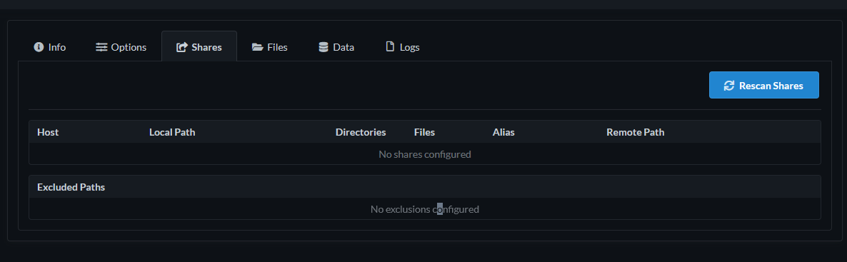

I've tried adding my folders to slskd using this info: https://github.com/slskd/slskd/blob/master/docs/docker.md and adding them as variables does not work. I've also added them as paths, that doesn't work either. When I log into the app and go into shares, I see this (screenshot):
If I rescan shares, it finds nothing. Any suggestions?
Hi, thanks for the question.
This is out of scope of the template - but I'll try to help you.
Ensure that you configured the YAML with the appropriate paths:
shares:
  directories: - /music
Note: This path must be the inner mountpoint of your container.
shares:
Thanks. I decided to go back tot he SoulseekQt docker which just works.

Hi @manrw,
Here I've attached the full log of the slskd docker in txt format.
It doesn't say much, to me, but maybe to you it is a lot clearer.
I hope you can help me out with this one, I would love to use Slsdk via Unraid.

Hey I can't get any of the plex type widgets to work as they get an SSL error.
Any idea of anything I can change in this templates settings?
Non of my locally hosted containers have authenticated SSL as running locally.
If there is a simple way to change this & keep them locally Accessed on unraid I may change it to stop the browser warnings.
wget 192.168.22.2:32400 in homarr gives this:100954942_Screenshot2023-12-01at14_13_16.thumb.png.08665e0c3997fbabf12612612b791835.png
I have plex with strict SSL on.
