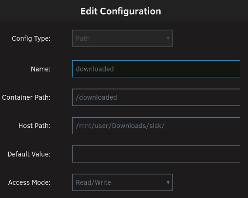

  • 4 months later...
On 5/25/2025 at 10:31 AM, Jokerigno said:
hello everyone can someone help me to undestand why my soulseek instance stopped working yesterday? I made no changes.
Below the docker run command:
docker run
  -d
  --name='slskd'
  --net='dockernet'
  --pids-limit 2048
  -e TZ="Europe/Berlin"
  -e HOST_OS="Unraid"
  -e HOST_HOSTNAME="Joshua"
  -e HOST_CONTAINERNAME="slskd"
  -e 'SLSKD_REMOTE_CONFIGURATION'='false'
  -e 'PORT'='5030'
  -e 'SLSKD_UPLOAD_SLOTS'='10'
  -e 'SLSKD_UPLOAD_SPEED_LIMIT'='1000'
  -e 'SLSKD_SLSK_USERNAME'='jokerigno'
  -e 'SLSKD_SLSK_PASSWORD'='candyman'
  -e 'SLSKD_SLSK_DESCRIPTION'='A Soulseek user'
  -e 'SLSKD_SLSK_DIAG_LEVEL'='None'
  -e 'SLSKD_USERNAME'='jokerigno'
  -e 'SLSKD_PASSWORD'='candyman'
  -e 'SLSKD_DOWNLOADS_DIR'='/downloads'
  -e 'SLSKD_INCOMPLETE_DIR'='/incomplete'
  -e 'PUID'='99'
  -e 'PGID'='100'
  -e 'SLSKD_UMASK '='000'
  -e 'CA_TS_FALLBACK_DIR'='/app'
  -l net.unraid.docker.webui='http://[IP]:[PORT:5030]/'
  -l net.unraid.docker.icon='https://raw.githubusercontent.com/manuel-rw/unraid-templates/master/templates/slskd/logo.png'
  -p '5030:5030/tcp'
  -p '5031:5031/tcp'
  -p '50300:50300/tcp'
  -v '/mnt/user/appdata/slskd/':'/app':'rw'
  -v '/mnt/user/downloads/temp/':'/incomplete':'rw'
  -v '/mnt/user/downloads/slskd':'/downloads':'rw'
  -v '/mnt/user/media/music/':'/data':'rw'
  --user 99:100 'slskd/slskd:latest'
and the error in log that stop the container at boot
Invalid configuration:
Directories:
The Incomplete field specifies a directory '/incomplete' that exists, but is not writeable.
The Downloads field specifies a directory '/downloads' that exists, but is not writeable.
I checked folders permission (/downloads/temp and /downloads/slskd) and are 0777 owner nobody group user.
I have the same issue. slskd was working fine for months, and it stopped working today. I haven't changed a thing. No idea what's the issue.

Thanks for looking into this !
Yes, I get this message : The Downloads field specifies a directory '/downloaded' that exists, but is not writeable.
Here's the configuration of "/downloaded" and PUID/GUILD in docker :
PUID 1000 refers to my main user, GUID 100 to group "users"..
I've tried "chmod -R username:users /mnt/user/Downloads/slsk" and "chmod -R nobody:users /mnt/user/Downloads/slsk".
Permissions are set to 777 by default, I didn't touch this.
Deleting the "/downloaded" path brings this error : The Downloads field specifies a non-existent directory '/downloaded'.
Adding an "/incomplete" path pointing to a folder with the same permissions as "/downloaded" doesn't do anything, no extra error in the log and slskd still fails to start.

The log just after the execution : The Downloads field specifies a directory '/downloaded' that exists, but is not writeable.
/incomplete path generates no error, while having the exact same permission :
drwxrwxrwx 1 nobody users   10 Sep 26 17:47 incomplete/
drwxrwxrwx 1 nobody users 4.0K Sep 28 01:37 slsk/
No idea where to look next.

Thanks for checking. Just to confirm, your file system is not out of space, correct?
Can you read and check the issues here?
GitHub
No image preview
slskd/slskd
A modern client-server application for the Soulseek file sharing network. - slskd/slskd
The problem is that I'm not using this template myself at the moment and cannot reproduce it either. The "app" is just a docker template of this image. If we cannot figure it out, we will need to submit an issue there. I'm not involved in the development of slskd.
Can you let me know if any of the troubleshooting steps or fixes in those issues fixed it?
Oh and what else is there to select in "Access mode"? Is there one permission level higher? Perhaps slskd needs execute too?
You found the issue, even though I already checked and missed it.
I have around 12 TB of free space available to this share, and didn't check any further, but for some reason one of the disks had just under 500 GB of available space, which is the minimum free space I set. It was enough for unraid to trigger the limit.
Everything is back to normal, thanks a lot !

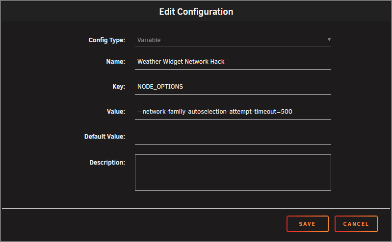

Running the Homarr default configuration the weather item can sometimes error out due to a race condition between ipv4/6 in NODE. This can be worked around by adding the custom environment variable NODE_OPTIONS=--network-family-autoselection-attempt-timeout=500 like so:
props to @vicary on the Homarr discord for the solution.
