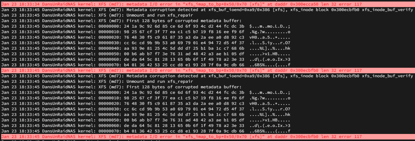

Hey everyone, I started getting I/O errors on one of my drives.
Noticed a load of my files suddenly disappear in my shares and went straight to the system log to see what was going on.
I've ran the check on all 13 drives in maintenance mode and it's just the one playing up (disk 7) from what I can see.
Any recommendations? Just run the check without -nv and see if it recovers the drive?

I think I'm going to attempt to recover the file system then replace the drive later today.
I got this when running the xfs_repair -v command.
I didn't see anything about this in the instructions so i have no idea what to do next.

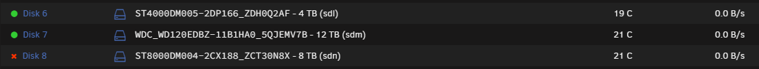

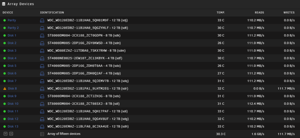

Shortly after starting recovery, disk 8 reported an I/O error too and has been disabled.
These drives are old and have a lot of uptime but seems to be a strange coincidence that they would both die together so soon.
To rule out heat issues I've pointed fans at my SAS devices.
I've also ordered some higher quality SAS cables.
Going to be keeping an eye on the SAS controller & HBA, it has been fine for months and my drives are old, so could just be a coincidence.

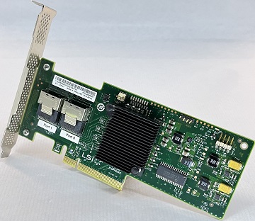

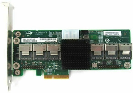

I'm currently using the following SAS devices:
IBM SAS HBA M1015 IT Mode 6Gbps PCI-e 2.0 x8 LSI 9220-8i
Intel 24 port 6 Gb/s SATA SAS RAID Expander Card PBA E91267-203 RES2SV240

I've got to replace disk 8 now as it failed during the rebuild of disk 7, lucky I had two parity drives.

I haven't replaced disk 8 yet (I replaced disk 7 first as it was the initial problem disk with filesystem corruption), I'm going to change some SAS cables and insert a new drive to replace disk 8 then start the rebuild soon. I will provide updates.

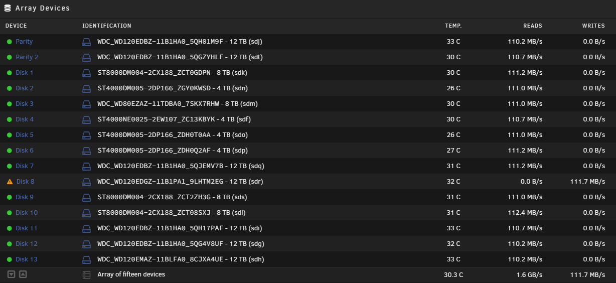

Disk 8 is rebuilding, no other issues so far.

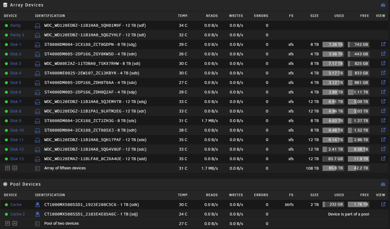

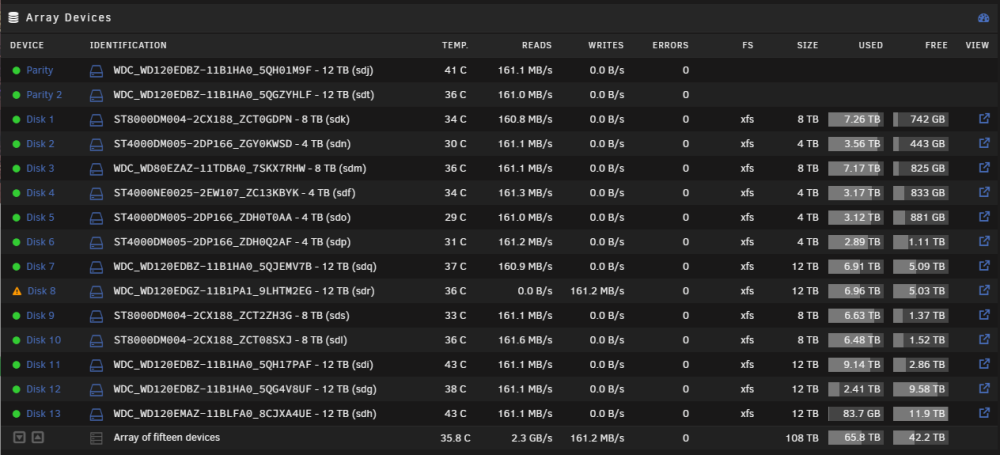

Can't really see if the data is OK or not, no new diagnostics have been posted and all screenshots are clipped on the right so can't tell if the disk is unmountable.
Apologies, please see attached.

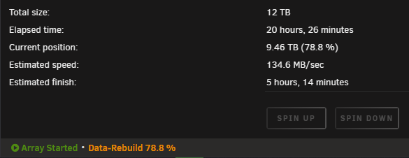

Rebuild of disk 8, the second disk to fail, is still underway.
The array is live, the data that originally disappeared (when the first error with disk 7 occurred) is back, which is really positive. Disk 8 was emulated immediately when it failed so I didn't notice any data loss the second time.

Since these diagnostics are without the array started, can't tell anything about filesystems or shares.
Start the array and post new diagnostics.

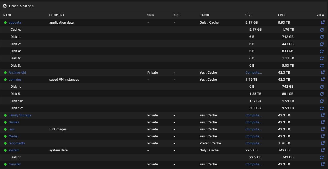

Not related to your original problems, but your appdata, domains, system shares have files on the array. In fact, domains and system shares are set to be moved to the array.
Ideally, these shares would be all on fast pool (cache) so Docker/VM performance isn't impacted by slower parity, and so array disks can spin down since these files are always open.
You have some unassigned SSDs mounted. How are you using these? Might be better as additional pools instead of unassigned.
Really good suggestions, thank you!
My appdata is set to use cache only, not sure why I have some "bytes" in the array?
Domains is just a backup of the VM vdisks I have running on the unassigned NVME drives so I dont have it in cache "only".
Unfortunately I am making use of one the unassigned SSDs right now and have plans for the other unassigned SSD.
I don't know why I had not set system to cache only, I have done this now but probably need to move the files back to cache.

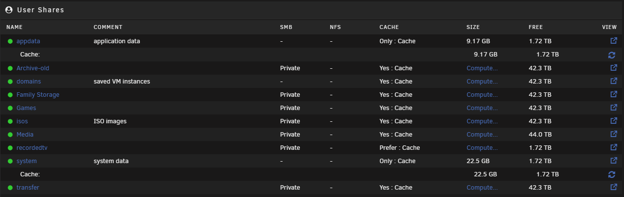

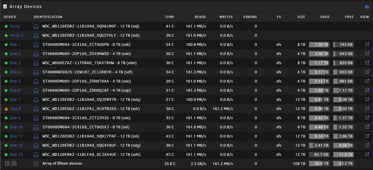

I've noticed something weird.
Seems to be stuck like this.
Edited by DanW
Ignore, was due to the changes I made to the shares I think.
Fixed 👍 thank you again :D
