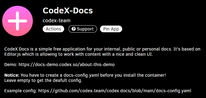

Hello,
I have a problem with Codex.docs
I created the empty docs-config.yaml but I got an error :

I think the problem is because the docker create a folder, not a file :
how can I resolve this issue ?
thank you
Edited by Alex.b
I'm having the same issue as Alex B, both on my unraid server and on a separate host deploying through portainer.
UPDATE: On my other docker host I fixed the issue, the config.yaml had been created as a directory, I'm guessing unraid is doing the same thing, though I haven't verified that yet.

Of course I read the instructions before installation but your docker keeps creating a folder instead of reading the .yaml file... or I didn't understand something.
Edited by Alex.b
Got it. My description was wrong. You have to create the file that's getting created as a folder.
So instead of creating a docs-config.yaml you have to create a docs-config.local.yaml
https://github.com/codex-team/codex.docs/blob/main/docker-compose.yml
I updated the template description.
Oh yes, I see! Grrr, it was right in front of me, thank you it works perfectly.
