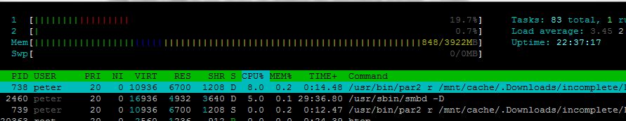

BUT I saw that when SAB should unrar files is only using ONE core! is that possible to change so all core could be used??
as far as i know, there is currently no multicore unrar available. if you know a multicore build, please let me know :)
Can p7zip replace unrar ? think this use multicore.
