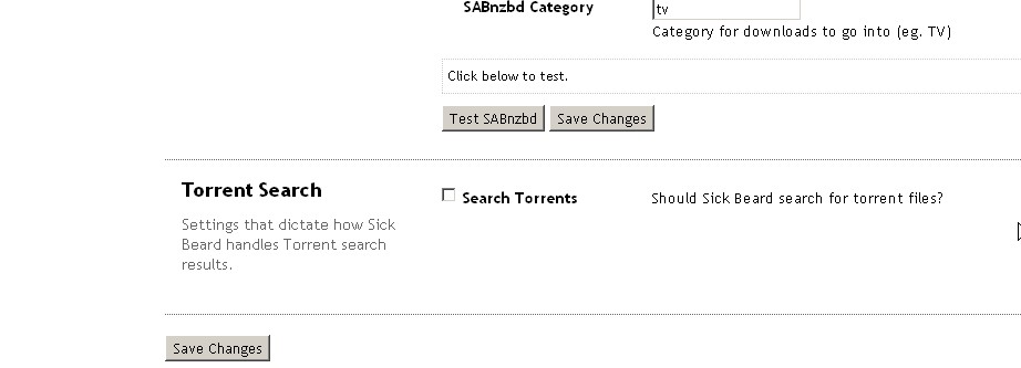

Sick Bear is SLICK..  Has any one figured out how to add the torrents branches yet?  Not much into the news groups..
Thanks

Under config...
