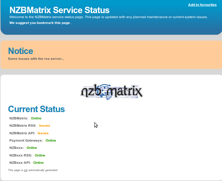

Hi All,
Finally got my setup working quite well however I've tried to update some of the shows. I keep getting these errors
2012-04-01 21:37:31.845532 SEARCHQUEUE-RSS-SEARCH :: Error while searching NZBMatrix, skipping: NZBMatrix.com RSS 2.0 en NZBMatrix.com RSS Feed - Usenet http://nzbmatrix.com Copyright 2012 NZBMatrix Sun, 01 Apr 2012 22:37:11 +0200
2012-04-01 21:37:31.851045 SEARCHQUEUE-RSS-SEARCH :: No NZB/Torrent providers found or enabled in the sickbeard config. Please check your settings.
Any ideas??
I get the same thing from time to time
NZBMatrix issue: http://nzbmatrix.info/
Screenshot-NZBMatrix_Service_Status_Page_-_Mozilla_Firefox.png.3377f6964a6355dd93cf70288f852e28.png
Hi All,
Any ideas??
I've got the same issue, there is a large thread in the Sickbeard support forum about this problem. The temporary fix is to restart sick beard however this only works for a few hours/one day. You can restart sick beard by clicking the top left icon and selecting restart from the drop down menu, hope this helps.

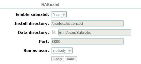

I just can't get Sab to start after rebooting my server. Sits there for ever like many in this thread.
I've attached a pic of my config. I've configured Sickbeard and Couch the same way and they start fine.
Try to find the log for sabnzbd, it should be in the data directory, hopefully there will be something in the log. Also post a syslog for after the reboot.
Here you go.
sabnzbd09042012.zip
Syslog09042012.txt
Your log shows that sabnzbd starts. When it "hangs" have you tried to access sabnzbd?
Thanks. I never actually tried it until just now as the unRAID menu just sits there for ages and never finishes loading unless I hit F5. But it does appear I can connect. Same happens with Sickbeard.
now if you go back to the plug-in setup page, does it say that sabnzbd is running?
Guess it doesn't really matter if it says it is, as long as its running.
