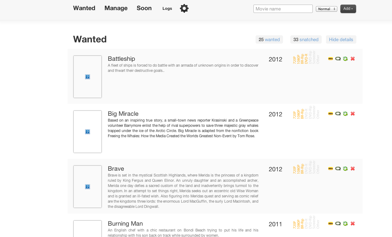

Hi all!
After a few issues, a re-build I've finally got couch potato back. One things is that the film images are no longer showing for existing or new entries!
Any ideas?

Hi all!
Any ideas?

You lost Couchpotato's image cache. You'll need to refresh each movie by hand, or delete and re-add them.
Thanks - I tried deleting them and re-adding but they added without images again - perhaps it needs a restart after deletion?
Alex

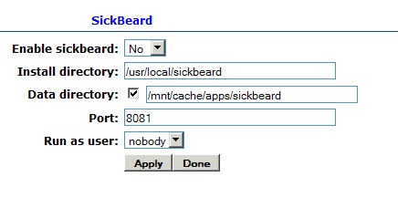

I have had this issue twice now and am reluctant to reconfigure a 3rd time without a better understanding of what I am doing wrong. I have a cache drive configured, and (thought) I set up correctly.
Install Dir:  /usr/local/sickbeard
Data dir: /mnt/cache/apps/sickbeard
Everything was working perfectly, then when I went to shut down for one reason or another, Sickbeard would not shut down successfully and hung the interface completely. I ended up rebooting and poof - nice new sickbeard. The next time I had a power outage (UPS on order) and same thing.
Thoughts? Does the plugin posted on the last page address this issue?
Thanks in advance!
The reason this most likely happens on a power outage is because the config.ini for sickbeard is corrupted becuase of the unclean shutdown.  There is nothing that can be done about that.
