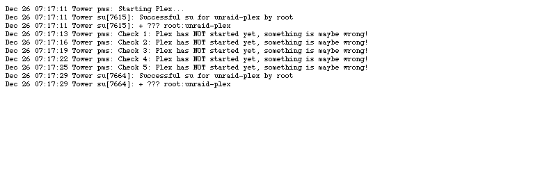

Running 5.0rc5, and am having trouble getting it to start.  (your plugin as well as the server installed as expected).
Syslog just has just shows it trying to start and saying something might be wrong... nothing super helpful though.

Starting plex stuff.. your plugin installed fine, and installed the server fine.  Just when starting the server it fails.
It appears to be an issue many have faced in the past now that I have done some more testing (manually trying to start it) and reading through this thread.
Its getting stuck with "cannot change locale UTF-8 blah blah blah" stuff.  Recommendation is to remove gcc package (unmenu) package and reboot.

I been trying to make this plex media server to work but without success so far. I upgraded to the 5.0rc version of unraid.  I can now see the plex configuration option under settings but still can't get it to start.
Also i can mount the disk but can't aces the shares.  I'm using a MAC to acces via CMD+K on finder as usual.
Any idea??
as always, a syslog would help...

without a syslog i can't really say, what could be wrong...
as a first test, you should disable any addon, you have installed (plugins, unmenu, etc.) and reboot. see, if this clean unraid works...
