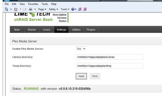

Ok, started from scratch again using this walkthrough
https://www.dropbox.com/s/ezouj1sttx0e93s/Screenshot%202013-12-02%2022.51.55.png
plex media setting are as below
https://www.dropbox.com/s/f00g8gq8f4w4l2i/Screenshot%202013-12-02%2022.53.37.png

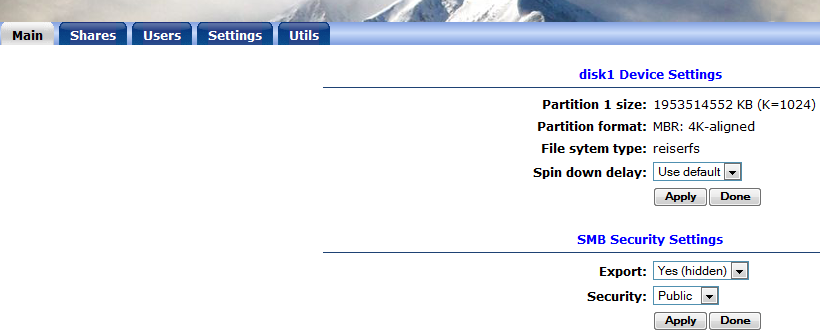

share made called apps as per instructions and is listed as disk1 only
https://www.dropbox.com/s/dzqty7lay750bz2/Screenshot%202013-12-02%2022.54.59.png
https://www.dropbox.com/s/pvhh7p103j1sqd7/Screenshot%202013-12-02%2022.56.49.png

Russ,
I'm not familiar with the web interface you're using, so I"m not quite sure how to read it.
I'm looking at your screenshot here: https://www.dropbox.com/s/dzqty7lay750bz2/Screenshot%202013-12-02%2022.54.59.png
Did you define and setup a SHARE named 'disk1'?
Put another way, do you have both  a logical share named 'disk1' as well as the physical harddrive automatically named 'disk1' by unRAID?
Russ,
I didn't set up disk1 as a share it was set up by unraid.
https://www.dropbox.com/s/42qrq3g6bf69zri/Screenshot%202013-12-03%2022.28.24.png
I did set up the share "apps" and told it to run from disk1 only.
is this info of any use ?
russ

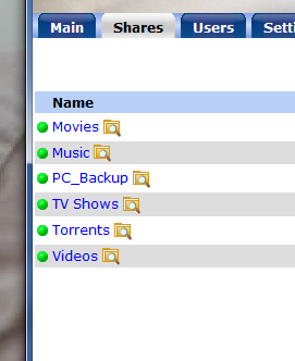

ok this is all very confused now because in the shares tab of unraid you should not be seeing disk1 and disk2 listed.  At least mine isn't shown even after i have exported a disk unhidden. see attached for my example.
What is the result of
ls -al /mnt/user
  Mine looks like this
root@Tower:~# ls -al /mnt/user
total 16
drwxrwxrwx 1 nobody users    80 2013-12-03 04:15 ./
drwxr-xr-x 9 root  root      0 2013-12-01 09:52 ../
drwxrwxrwx 1 nobody users  1872 2013-11-30 22:52 Movies/
drwxr-xr-x 1 nobody users 14200 2013-11-26 04:00 Music/
drwxrwxrwx 1 nobody users  120 2013-11-30 20:46 PC_Backup/
drwxrwxrwx 1 nobody users  560 2013-11-26 04:45 TV\ Shows/
drwxrwxrwx 1 nobody users  728 2013-12-01 04:00 Torrents/
drwxrwxrwx 1 nobody users  336 2013-10-30 19:58 Videos/

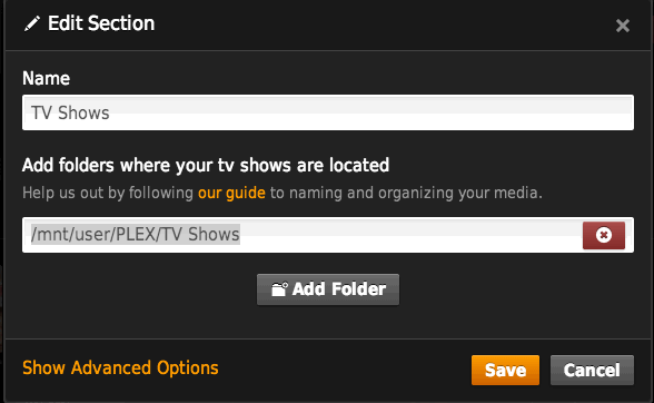

Its not important that your media directory looks like mine...its just that I don't show 'disk1' anywhere.
And when I run the Plex program, the corresponding version of the TV library section looks like the attached:

never had simple features installed and  the web interface is the newest of the unraid & plex websites
I do have separate shares set up for tv, movies, music, photos etc and these are set to high water. could this be the problem ??
https://www.dropbox.com/s/wb0cdcal0sj4cdn/Screenshot%202013-12-04%2021.50.33.png
but in the past I have pointed PMS to /mnt/user/tv and it still makes no difference.
there is nothing in the shares for disk1 or disk2. weird
1 step forward or 1 step back. What do you all think ??
thanks
russ
No the problem is possibly that you seem to have shares actually called disk1 and disk2.  Unraid did not create those.  You did.  You had to.  The nuance i think you've missed is that unraid can EXPORT your disks (see attached) but doesn't do it by default.  Which is not the same as creating shares called diskX which it seems you have done.
Before you go through trying to do what I say below, what is the output of:
ls -al /mnt/user/tv
and
ls -al /mnt/user/disk1
and
ls -al /mnt/user/disk2
Post those here, but i'm betting you're got data in one "disk1" but are pointing your plex gui at another "disk1" ... at this point it is the only thing that makes sense, especially since your permissions seem to be correct as well.
Assuming I'm right you'll need to move you tv shows folders:
out of /mnt/user/diskX into /mnt/user/tv
and
out of /mnt/diskX/tv to /mnt/user/tv
Then delete your plex library locations (from the plex gui) and re-add them pointing towards /mnt/user/tv
ok just looked closer at your screen shot.  All your data is in:
/mnt/user/tv (252 GB)
and is stored physically on
/mnt/disk1/tv (208GB)
and
/mnt/disk2/tv (43.7Gb)
HOWEVER, you are pointing plexgui at:
/mnt/disk1/tv (0 GB)
See the difference?
You need to point it at:
/mnt/user/tv
I'm not going to address the fact yet that technically plex SHOULD be seeing at least the data I can tell is in /mnt/disk1/tv because lets get everything right.  That means, you also need to use the Unraid Share's tab to delete your "disk1" and "disk2" SHARE that i can clearly see in your screen shot and from the results of the last "ls" command.
