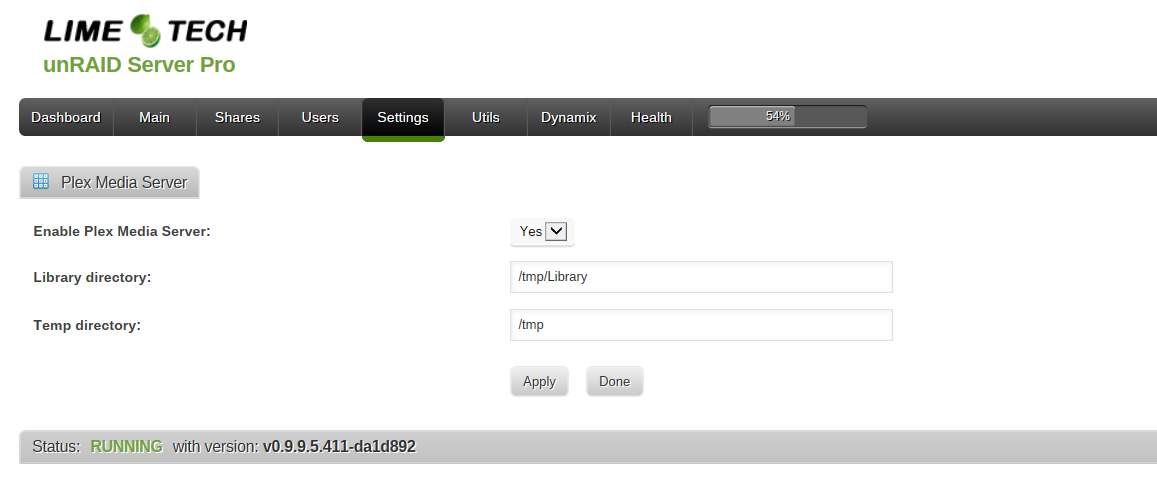

After rebooting plex was there, but all Settings are lost... What happened?
Syslog attached...
syslog.txt
damn.
Syslog attached...
Post a screenshot of your plex setting page
here you go
Your library is in a temporary location and I belive is only stored in ram. Set the library location to /mnt/cache/anyfolderyoulike if you have a cache drive. If not use a disk share like /mnt/user/diskx/anyfolderyoulike
/tmp is in RAMfs. The only locations that will survive a reboot are folders in /boot and /mnt. You should use some location in /mnt/user or /mnt/diskx for your library. If you have a cache disk the preferred method is to have a cache-only share, name it apps or whatever, and put your library in /mnt/user/apps/plex, for example. If you don't have a cache disk you can put your apps share on some other disk, so you would have /mnt/disk1/apps/plex, for example.
I changed the Library dir to "/boot/config/plugins/plexmediaserver/Library"
