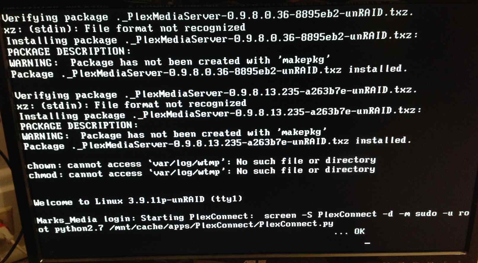

Are you supposed to see multiple instances of the plex server install?
I'm using 0.9.9.2. there is only one PMS package in the extra folder in the boot dir.
My server works just fine.
during the boot up sequence I see it install the 0.9.9.2 then after that installs I get a bunch of small lines of code that show multiple older versions apparently installed or at least says it's installed.
I'll attach my log but the readout I'm seeing doesn't appear to be in the log file so I'll include a pic too.
The ._ files are created when you copy the file from a Mac. They are used to stored information that normally goes into extended attributes on HFS+ volumes. You can safely delete the ._ files.
