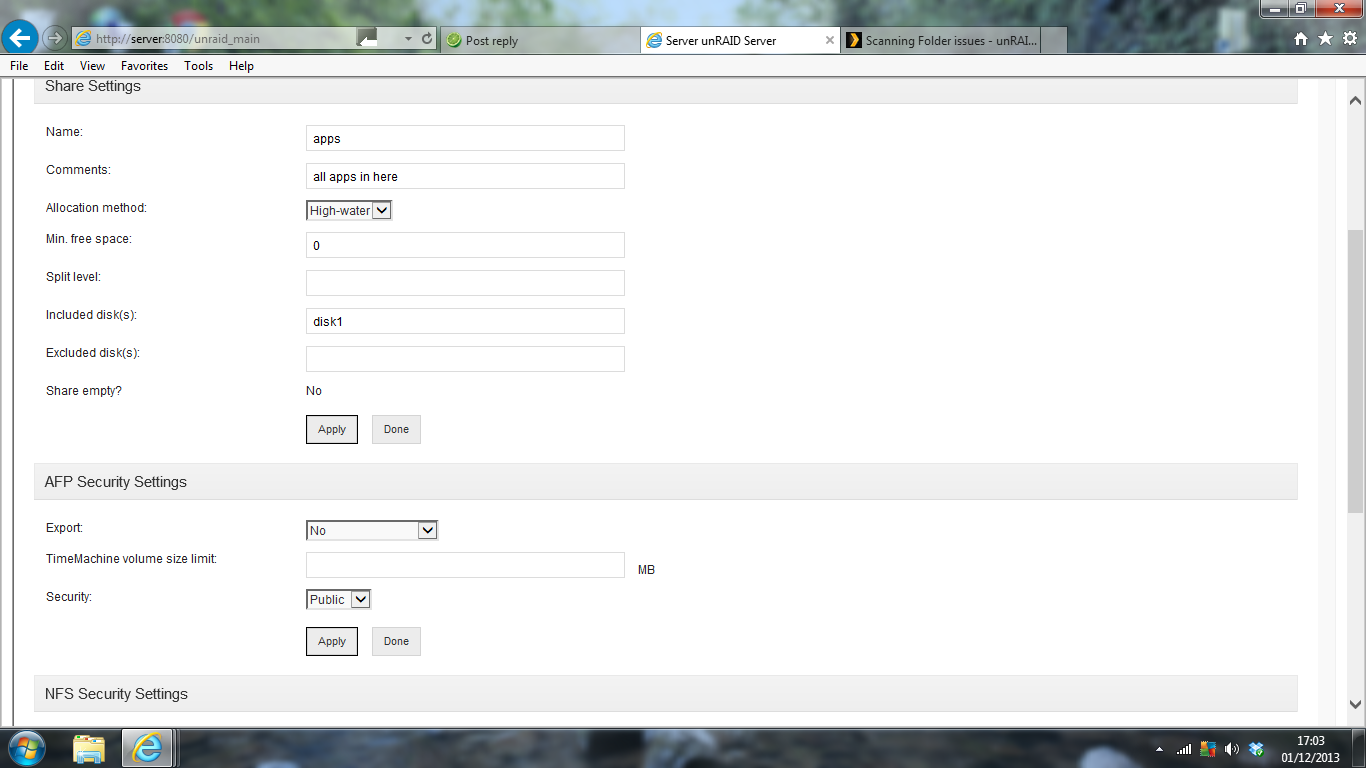

Hi all. I hope somebody might be able to help me. I have posted this also in the Plex / Unraid forum but have hit a blank wall.
I have installed PMS on the newest version of Unraid.
I have all the naming conventions for the files correct.
I have ran the permissions
re-booted many times and the problem remains the same
the plex gui shows the sections I have added, i.e movies, music etc but there is nothing contained in them.
when I choose to refresh, scan or deep scan a message instantly comes up on the bottom of the screen saying library scan complete. but still there is nothing in the sections.
it must be something I am doing which is so simple but I am missing the problem here.
any help by anyone would be much appreciated.
thanks

thanks for that DaleWilliams but my problem remains the same.

It shouldn't if you had installed the Plex according to the only "official" guide. It's of course far from official but it simply works and I've been trying to recommend it when ever I have a chance. Just don't deviate one bit and you should be safe. To be clear, it's trivial to install Plex if you know what you are doing. If you don't know just follow the guide to the letter ;)
I think I am in the right area..
https://www.dropbox.com/s/pq9ns2bsvajtxe6/Screenshot%202013-12-01%2017.06.54.png
https://www.dropbox.com/s/0dvlpleveuui1mz/Screenshot%202013-12-01%2017.11.18.png
but after adding the folders by the correct manner, the library scan still shows nothing.
also there is no scan logs.
First make sure you have installed Plex according to the steps in the guide I mentioned above. If not, just start all over, it is faster to start from scratch than to try to debug unknown situation.
Once you have a working Plex installation then you should define the folders in the Plex Web gui like I showed in my previous post. The screenshots you posted are from the unRAID web gui (http://tower), not from the Plex web gui (http://tower:32400/web). Since you mentioned that you had a Plex library section I thought you were already in the right place. I don't have a chance right now to take screenshots of a working library section definition but if needed I can post them later.

Maybe also an unRAID screenshot of the shares you're trying to get Plex to see. Is your tv share really named tv and not TV or Tv? Linux is case sensitive.
