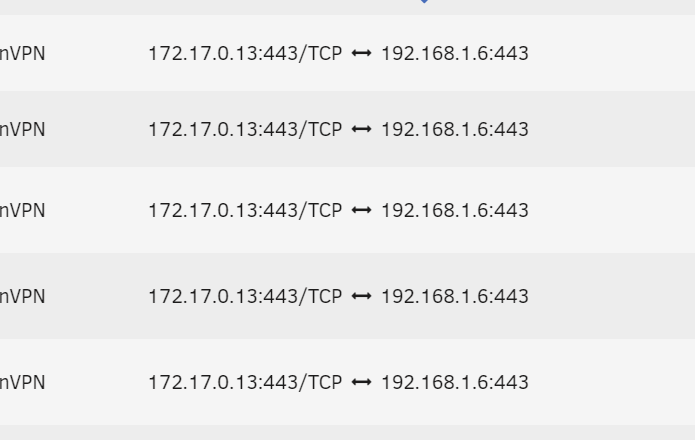

Why is Unraid mapping port 443 to dockers that uses a container network
I am using an OpenVPN client and are directing another docker via that container. (--net=container:OpenVPN-Client)
When I look in the port mapping column in the docker view it shows "172.18.0.5:443/TCP192.168.1.130:443", the container is not configured to use that port and docker is not mapping it to it.
Why is this happening?
This leads to me not being able to start NextCloud because port 443 is already in use.

I changed the port on NextClod to 2443 and now thay are listed as used by the container I mantioned above. How are this connected?

Same thing here, i just found the problem as well.
i tried 2443, and yepp, all the other ones change also.

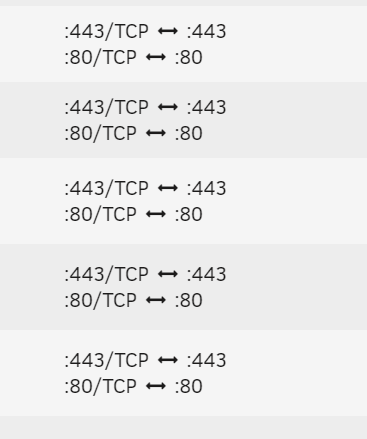

I checked each and one, i removed the mgmt port on them and added to the vpn docker...
Did you find any fix ? or someone else who knows ?
I believe i had this problem on 6.12.1
and now also on 6.12.2 (just found the prob) 🙂

Hey, i opened one of the dockers that were showing 443.
changed something, and back again
then apply
Then it disappeared.
I will go through them one by one tomorrow and see...
Hehe, nope.
I changed on everyone, it looked good.
Then i changed back nextcloud to 443.
Then it came back again, on all the other ones 🙂
docker: Error response from daemon: driver failed programming external connectivity on endpoint nextcloud (9cdfd6bc3bdee7f96c511936e8d3bfc1969751557b02261333d90db0c44b5dfe): Error starting userland proxy: listen tcp4 0.0.0.0:443: bind: address already in use.
i changed Nextcloud to Host Network.
Then this happened on the other containers with problem
Changed back to Bridge
then problem back again

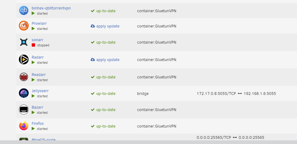

I had similar issues on my containers, where the port configurations in the template were not being applied. Most of them were targeting a custom network (proxynet).... for me it was finally resolved by changing each and every container (one-by-one) to use a different network (changed most to Bridge) and then back again, however for CrashPlan PRO I had to change it to Host to get the VNC Gui to work again, where previously it always worked on Bridge (🤷‍♂️)....

It doesnt show anything on those i have specified gluetun for now...
Its totally messed up 🙂
I dont believe its specific to any specific container.
