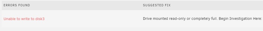

"Drive mounted read-only or completely full. "

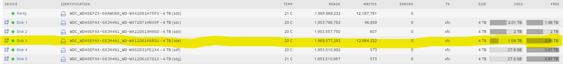

Getting this error msg. in Fix Common Problems, however the drive in question (3) looks fine . Status is green, not close to being full, and there are reads and writes.  Note however, I recently had to replace that drives Sata cable due to a separate issue (Parity checks were taking forever). Perhaps that issue corrupted the file system?
In any event, I have included a Diag. file and screen cap.
Any assistance would be greatly appreciated.
