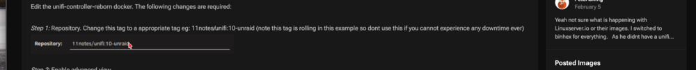

Just updated using method 1 but ran into a few issues. They were completely my own fault but could be avoided with a small edit.
When reconfiguring I copy/pasted the repo field shown below.
This resulted in some invalid spaces and several failed installs.
Perhaps you could edit the post to add a code line that will paste without errors?
1 hour ago, wgstarks said:
@PeteAsking
Ok! i just edited it for you.
