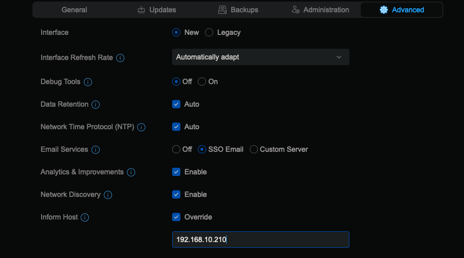

Hi, have you tried to putting the inform host?
I have not done the set inform. I will try that.
I did the set inform host but when I use custom:bro it shows up like this and I cannot access the webui

I tested this and was able to get brx networks to work. For some reason the docker displays no IPs like you saw on your screenshot from Saturday 18th/11 - however you can connect to the web interface no problem and so long as an inform URL is set with the correct IP then it works. I dont see any issue my side with this setup.
100% you should get the web login when using brx networking, this is tested and working for me so please troubleshoot why that did not work for you (must be something your side).
P
Ok that worked! when i click webui it shows  blocked? but when I type it in manually it works! thank you
very odd
