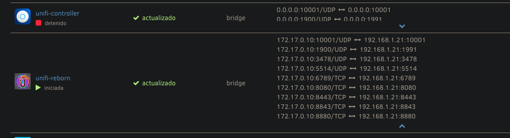

I installed it this afternoon and so far it works without problems. I had the same version 7.5.187 on unifi-controller which I restored from a 60 day backup.
Great work!
