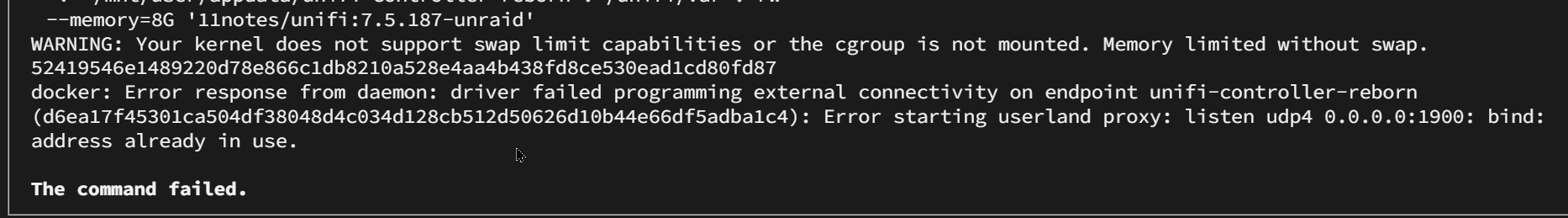

I am having a conflict with port 1900. Plex is also using that port and I do not see an option in the Plex Template to change it. I changed on the unifi reborn but then it wasn't adopting my unifi devices. So I turned plex off and tried using port 1900 on Unifi Reborn and it is still saying it can't bind to 1900 as plex is using it though it is powered off.
What do you have set for “network type”? Should be bridge.

Here is the Unifi Reborn error
I agree this appears like something is already using this port but if what you are saying is accurate and nothing is because everything else is stopped then its an issue one layer up with unraid itself and not something I can address. I cant say why unraid would claim the ports in use if that is in fact untrue.

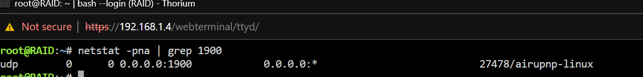

yes you are right it is not Plex. It is something else using port 1900 but I have no idea what or how to figure it out
Found this command and figured out it was my docker container airconnect once I turned that off it worked. and again ports are not listed in that docker template
