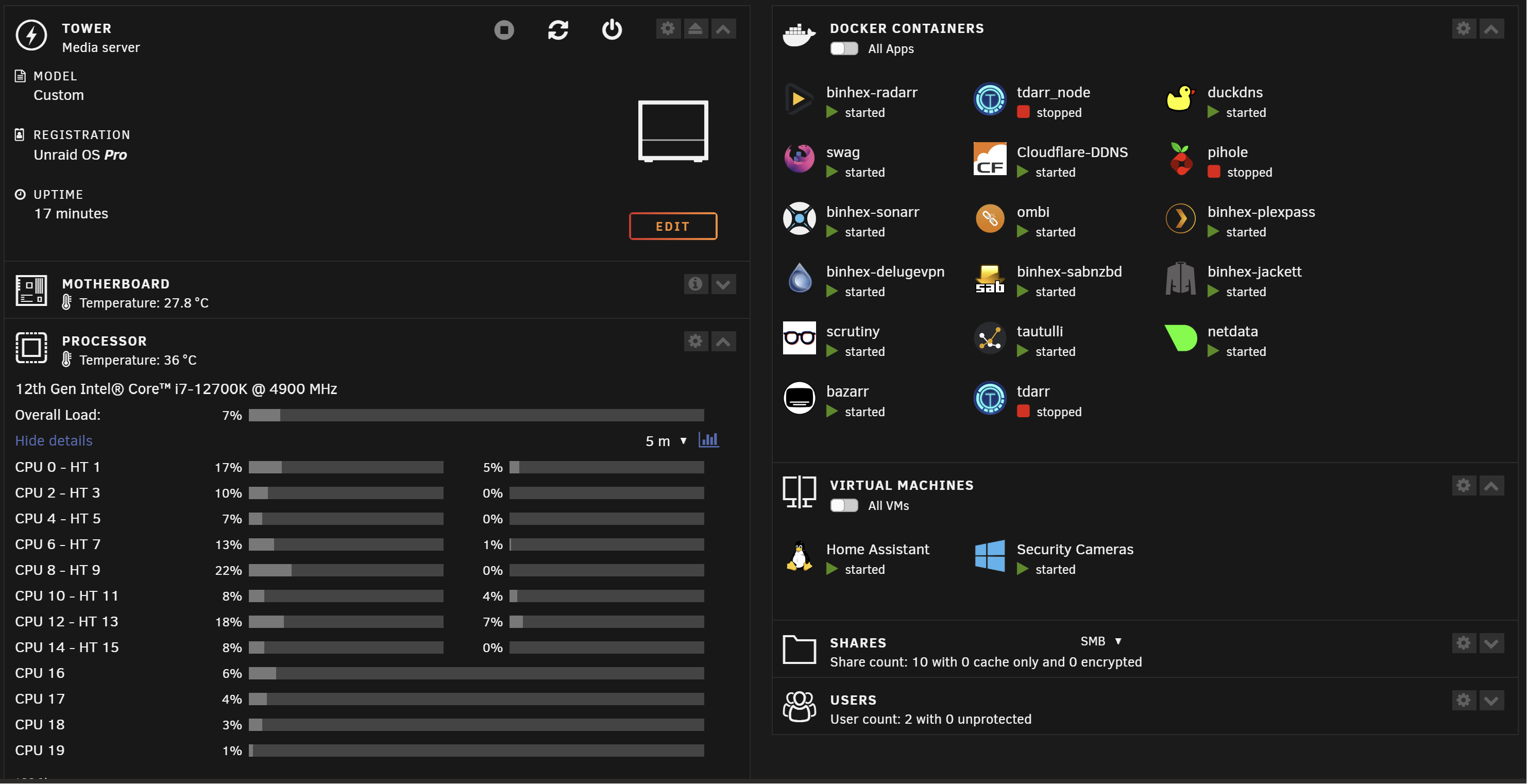

As the topic states my unraid server becomes unresponsive after a few days and I do not know what is causing it to crash. Im unable to log into the webui and if i go to the actual computer the shell is also unresponsive. Just started having the logs mirrored to the flash. running unraid 12.6
In the past weeks ive had 5 crashes. The only change i made to the server is adding a homeassistant VM and removing 2 cores from a windows VM.
My setup i have a homeassistant VM, a windows VM running blue iris with a NVIDIA gpu passed thru to the VM, and I have 14 dockers running. Normal operation the server only runs at 8% utilization I can give more details anywhere needed. I will post logs if it happens again. Any advice that i can start looking into in the mean time would be greatly be appreciated
Rig details
Intel Core i7-12700K | ASUS ROG Strix Z690-G Gaming WiFi | CORSAIR Vengeance 64GB (2 x 32GB) RAM DDR5 5200 | 5 - Seagate IronWolf Pro 12TB | SAMSUNG 980 PRO M.2 2TB (cache drive) | SAMSUNG 970 EVO PLUS m.2 250GB (VM drive) | Gigabyte NVIDIA 3050 (VM GPU) | WD Purple Pro 14 TB (VM Passthrough) | Sandisk Ultra Dual -64 GB (boot device)
