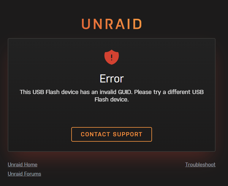

Since today the unraid dashboard shows no more uptime in the top bar and says 'Unraid OS Stale'. Underneath, where the name of the server should actually be, it says 'Fix Error'. When I click on it I get a button 'Check for OS Updates'. This takes me to a page with the error 'This USB Flash device has an invalid GUID'.
Does this mean that my flash drive is broken?

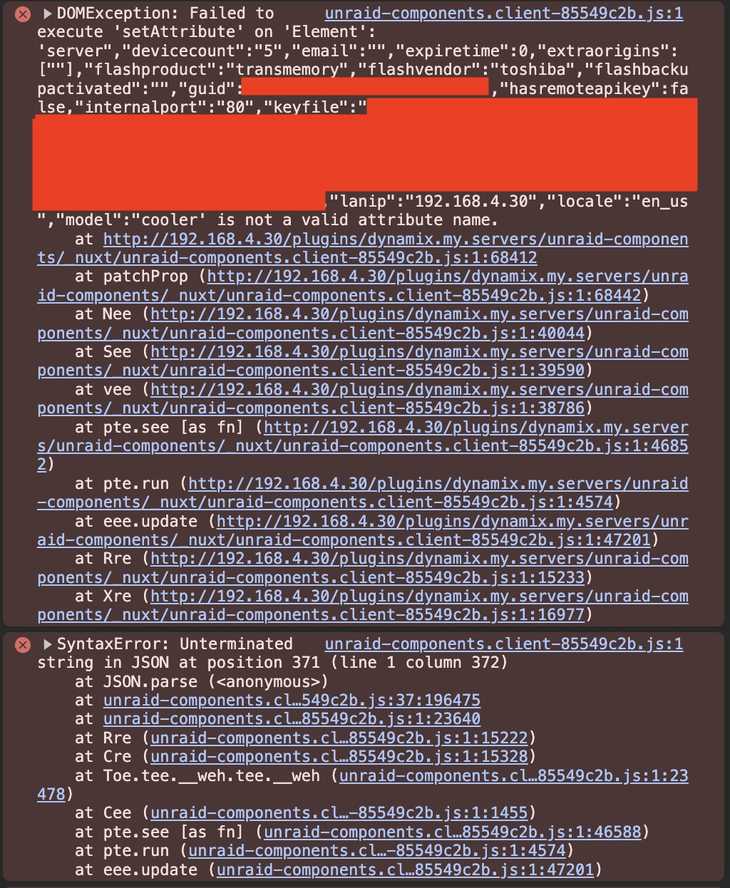

Navigating between pages in the Web UI is also noticably slower. Took a peek into the browser console and found a hideous amount of errors being thrown. I've redacted potentially sensitive info:

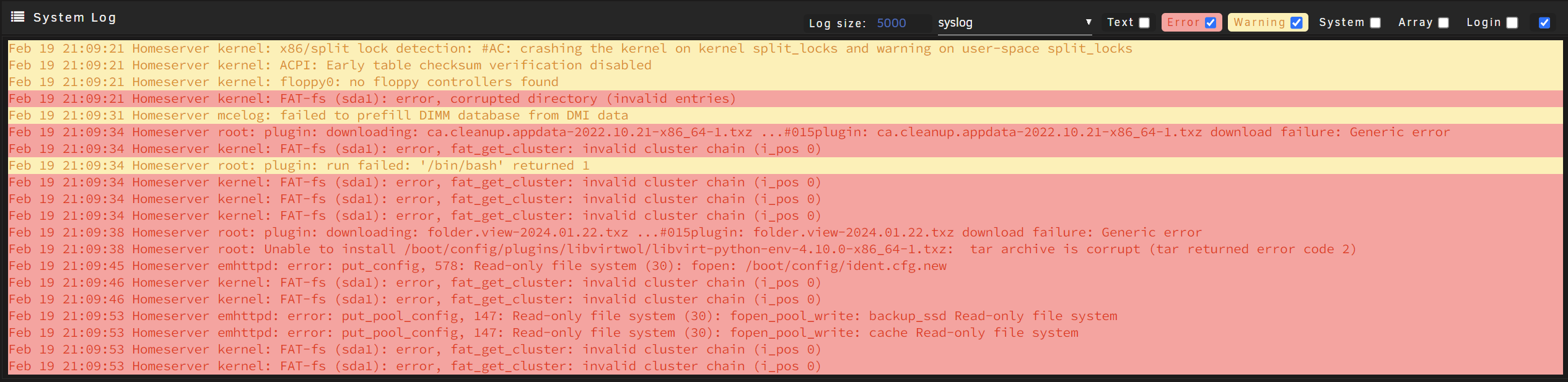

After I tried to start normally I got the status mail that my USB drive is not read-write. Do you think this is related to the original problem?
These are the Errors and Warnings I got after this.

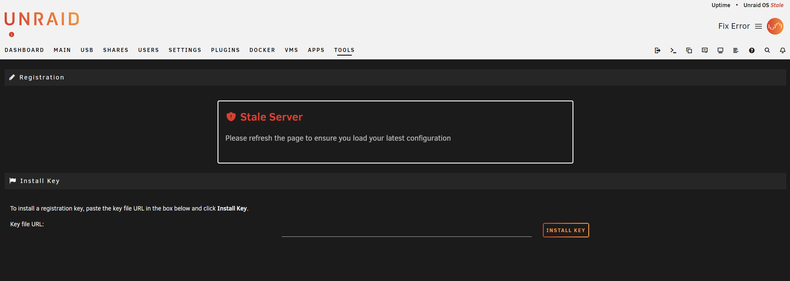

I switched to a new USB stick today. The problem with "Stale" still remains. I also see it now at the place where I should register my license. Refreshing the page doesn't help.1940885589_Screenshot2024-02-24225442.thumb.png.36a1a8bfde762a01b9f5dac6f3f5a700.png
