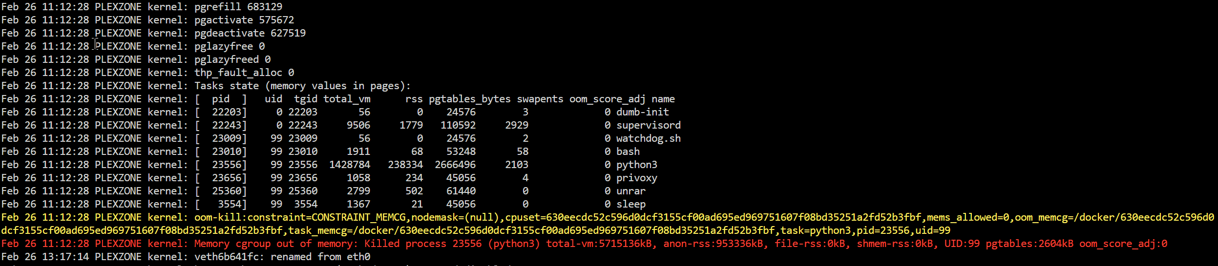

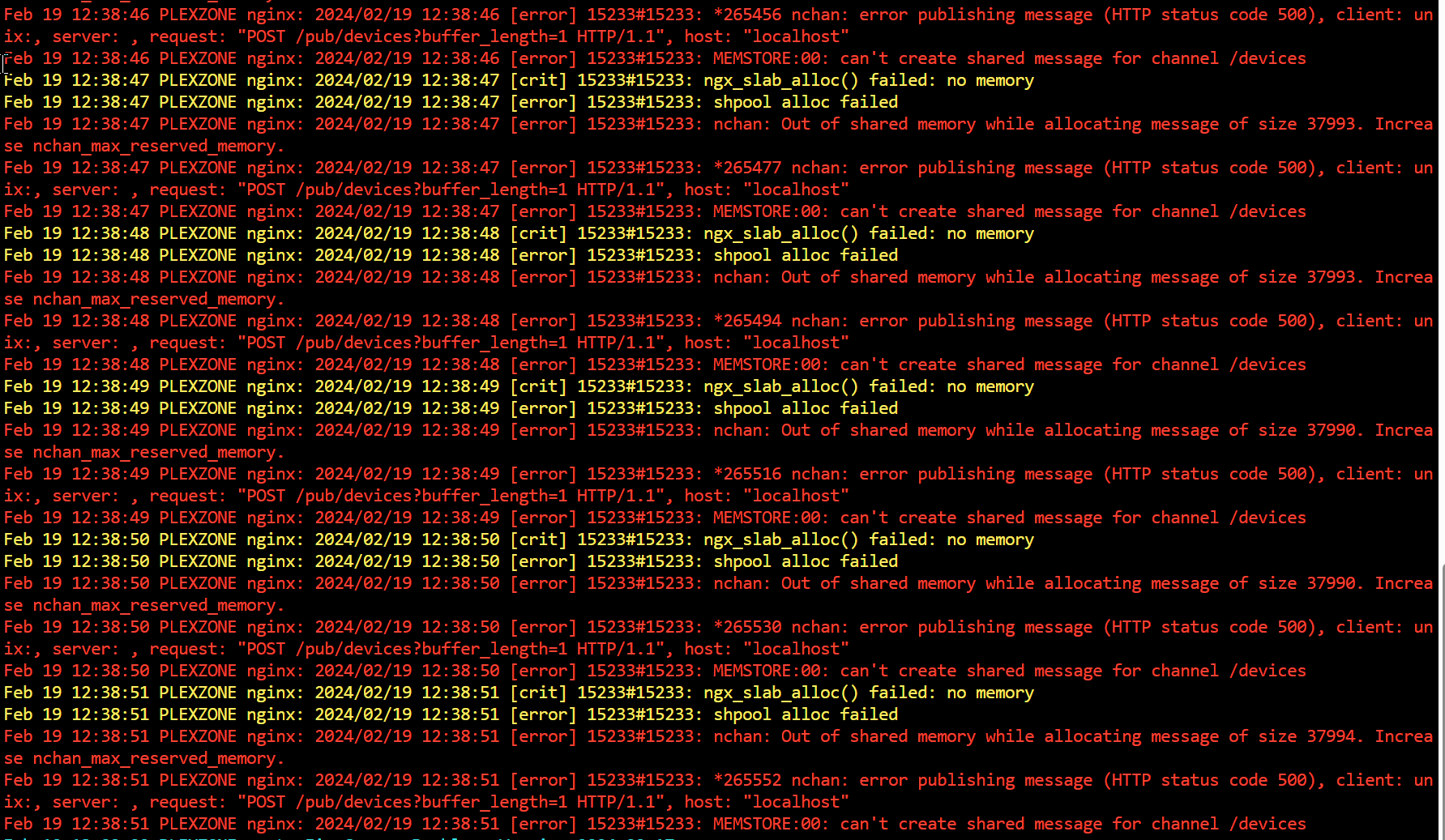

Also got a new error, I havent seen before but resulting in the same memory error message?
I have not installed any new dockers? (Just moved everything to the new server now with ZFS cache?)
That looks like Plex getting killed because the server was running low on RAM, you can try limiting the RAM for that container, also make sure Plex is up to data since I believe at some point it had a memory leak, possibly still has.

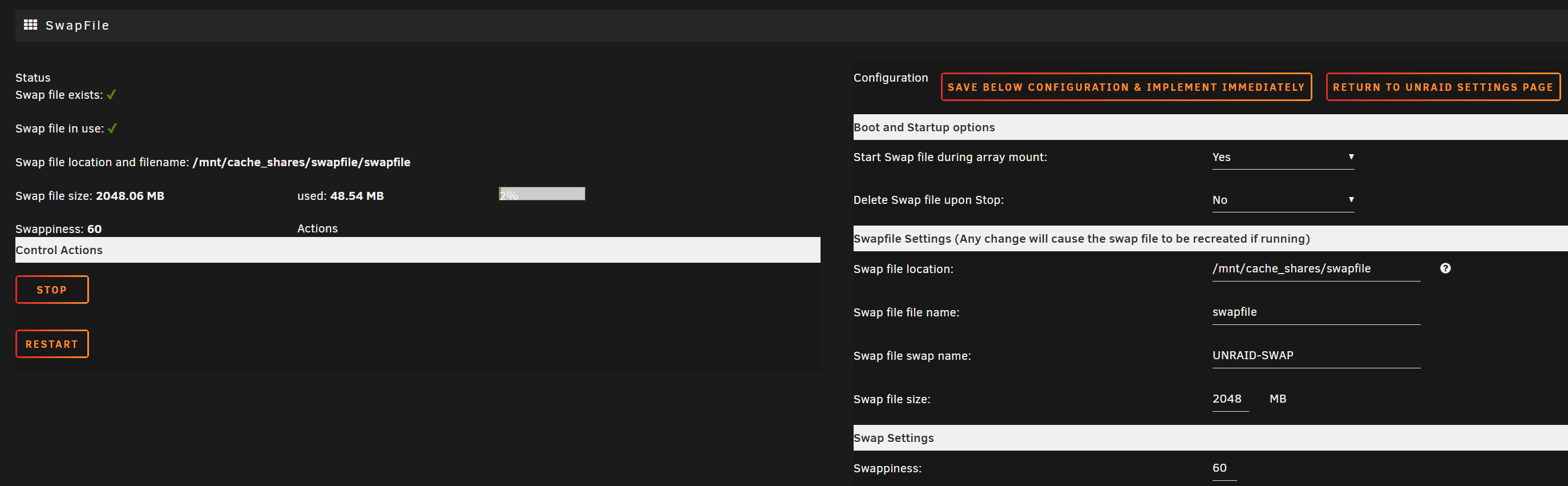

I did install the swapfile plugin and created it on a single U3 cache drive with btrfs - any recommendation on the size?
I went with the default values (Size: 20G)

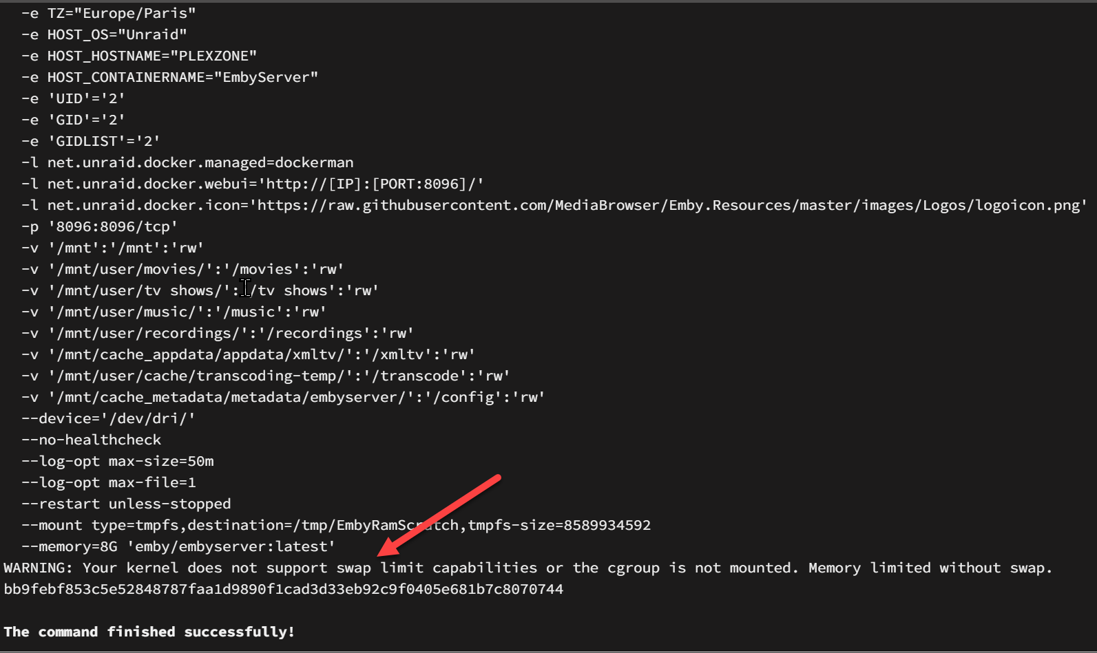

Ok so my trouble shooting continues 🙂
  • I Have installed the swapfile plugin (You recommended above) successfully (Standard size setting is around 2G)
  • I have moved the RamScratch settings to each of the dockers and also set memory limits
    • (PLEX) --no-healthcheck --log-opt max-size=50m --log-opt max-file=1 --restart unless-stopped --mount type=tmpfs,destination=/tmp/PlexRamScratch,tmpfs-size=68719476736 --memory=64G
    • (EMBY) --no-healthcheck --log-opt max-size=50m --log-opt max-file=1 --restart unless-stopped --mount type=tmpfs,destination=/tmp/EmbyRamScratch,tmpfs-size=8589934592 --memory=8G
    • (JELLYFIN) --no-healthcheck --log-opt max-size=50m --log-opt max-file=1 --restart unless-stopped --mount type=tmpfs,destination=/tmp/JellyRamScratch,tmpfs-size=8589934592 --memory=8G
After doing this I get a docker Warning: Your kernel does not support swap limit capabilities?
(Running the RamScratch as a script I never saw any warnings like below, did I do something wrong?)

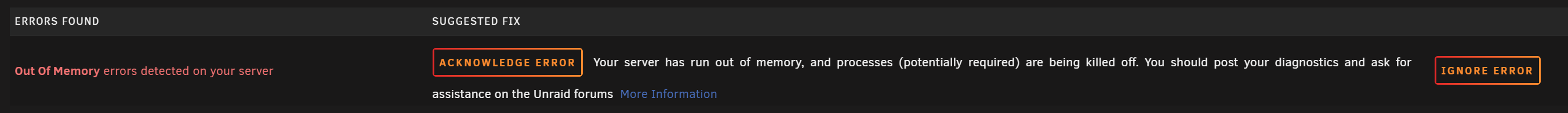

I can see that the memory limit is implemented on the docker webpage:
But I still see this:

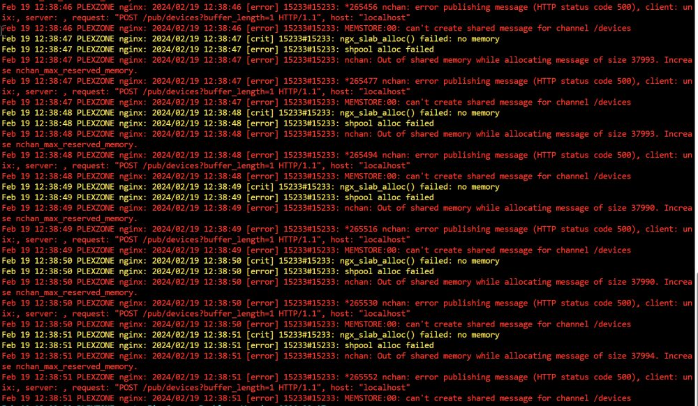

And again today:
If these are to be just ignored then it would be nice not to have them in RED letters 🙂
Edited by casperse
You may have other apps causing the server to run OOM, you can disable everything and start enabling one by one, then retest.

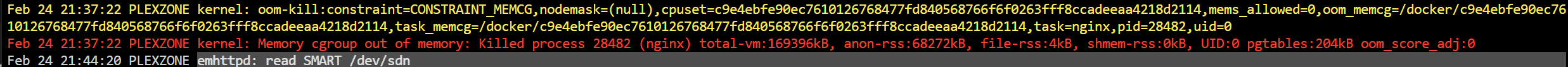

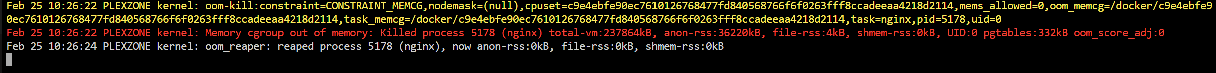

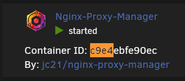

Yes, from the above error I can see a docker ID starting with c9e4ebfe searching for this I get the culprit? :
But I can see that this docker already have a limit of 1G:
--memory=1G --no-healthcheck --log-opt max-size=50m

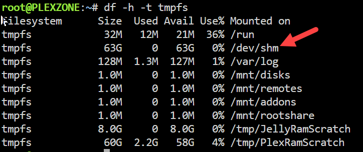

The dev/shm will always be set to 50% of the available memory right?
