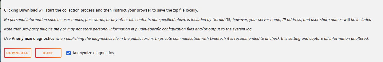

When you say "attach the diagnostics" are you referring to the entire zip file? Isn't there sensitive info in there that shouldn't be uploaded to the internet for the world to have access to? Or is there a specific file in that zip file you need? If you need the entire zip file, could I send it to you privately? Or can I first be assured there is no sensitive info in that zip file that "hackers" could use? Please forgive my ignorance but I'm sure you can understand my caution as well.
Thank you ConnerVT, I did read that on that page prior. But it seems the anonymized diagnostics still include things like IP addresses and such that I don't believe should be advertised for the world to see. I'm not a cyber security expert, though. Don't a lot of attacks start with someone figuring out what your IP address is? I have no qualms about posting up diagnostic files that don't have vulnerable info in them. Just let me know which ones are needed.
