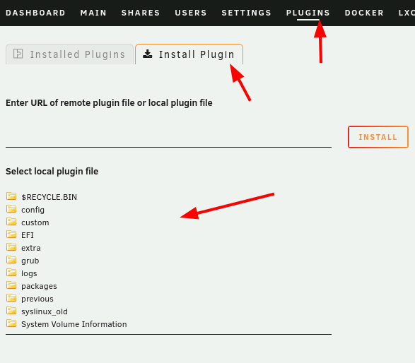

BTW, you don't have to reboot to install a plugin, simply put the plg file somewhere on your server and then install it through the build int plugin installer:
With that you will see what is happening, or in this case not. I suspect a formatting error or something similar.

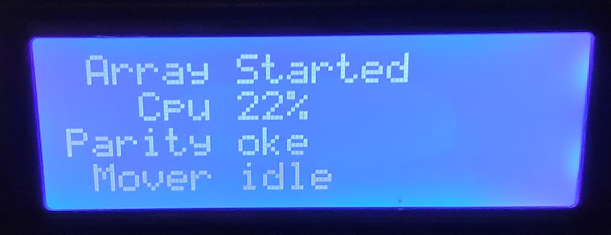

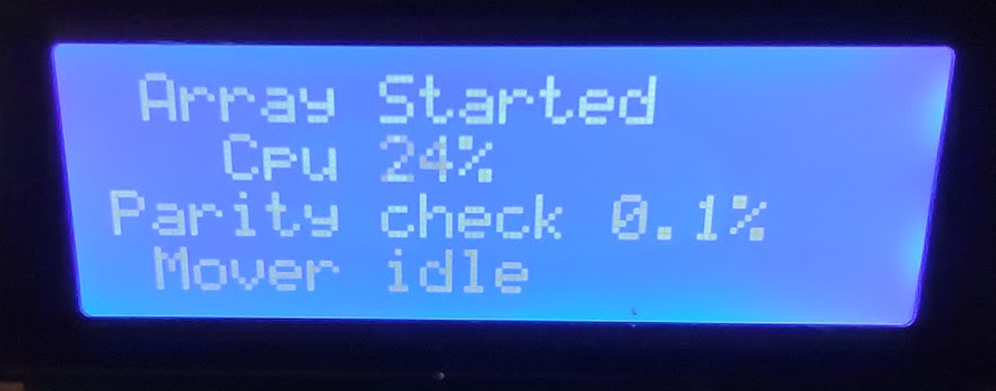

I got two goals here. The first one is obviously to learn more about unraid, slack and how to make unraid plugins. Second goal is more practical: I'm trying to create put a netdev_stats.ini (just a name I came up with) along with al the other ini's in /var/local/emhttp/state that gathers the current bandwidth from various interfaces. As far as I can tell it's not available. Well, third goal is to actually use that ini for a 4x20 lcd display I'm working on to display cpu, parity status, bandwidth maybe how much space is left.

That cool's - I was not aware about that, still - I want to understand the plg thingy and I already made a couple of classes in python that gather data from the ini-files, and sends them to the lcd using a uart. I usually want to try it myself, if I think its doable with the knowledge I got, before I get "ready-to-go" plugins 🙂.
Been tinkering with atmeg and esp for quite some time and thought this would be cool (but as always - whatever you come up with, you are not the first one :)
