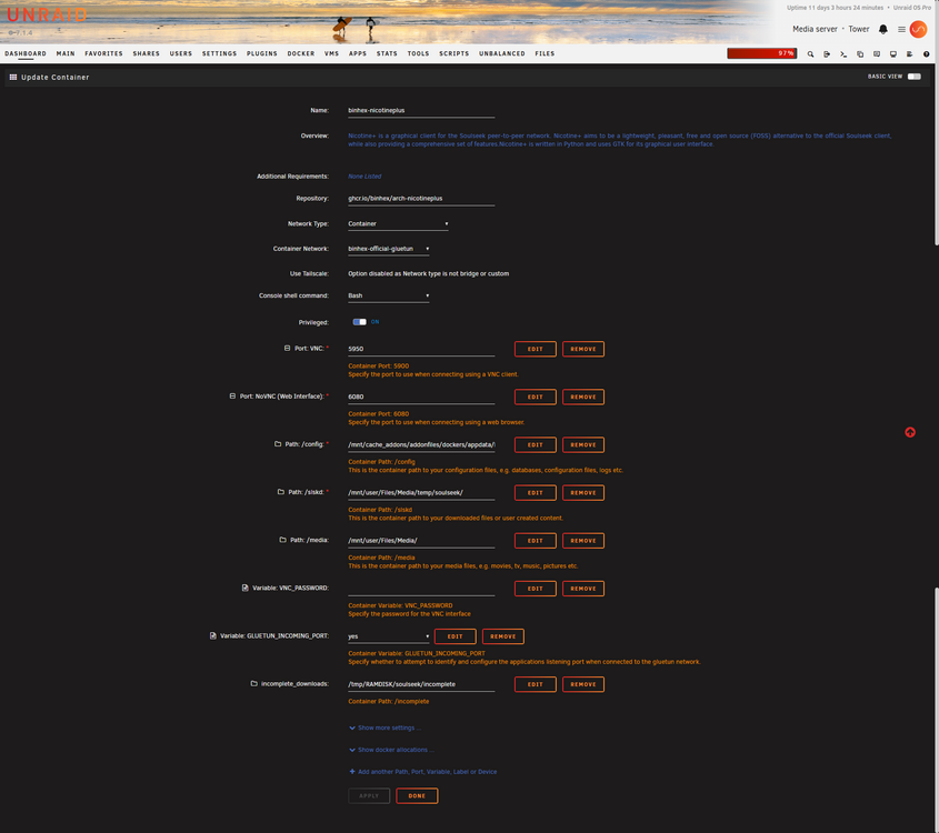

MrSliff Posted August 28 Share Posted August 28 (edited) On 8/26/2024 at 7:06 PM, binhex said: Please see Q24 from the following link:- https://github.com/binhex/documentation/blob/master/docker/faq/vpn.md Question about routing other containers related to VPN ports: So i am running the qbittorrenvpn docker which automatically assigns a VPN port to qbittorrent. So i can not use this port anymore for nicotine. The same should apply for PrivoxyVPN. If i already use that port for one application, i can not use it for a second one, right? So in this case, i would need to spin up another VPN container? Or would it be possible to run 2 different VPN connections inside a VPN container? Edited August 28 by MrSliff Quote Link to comment

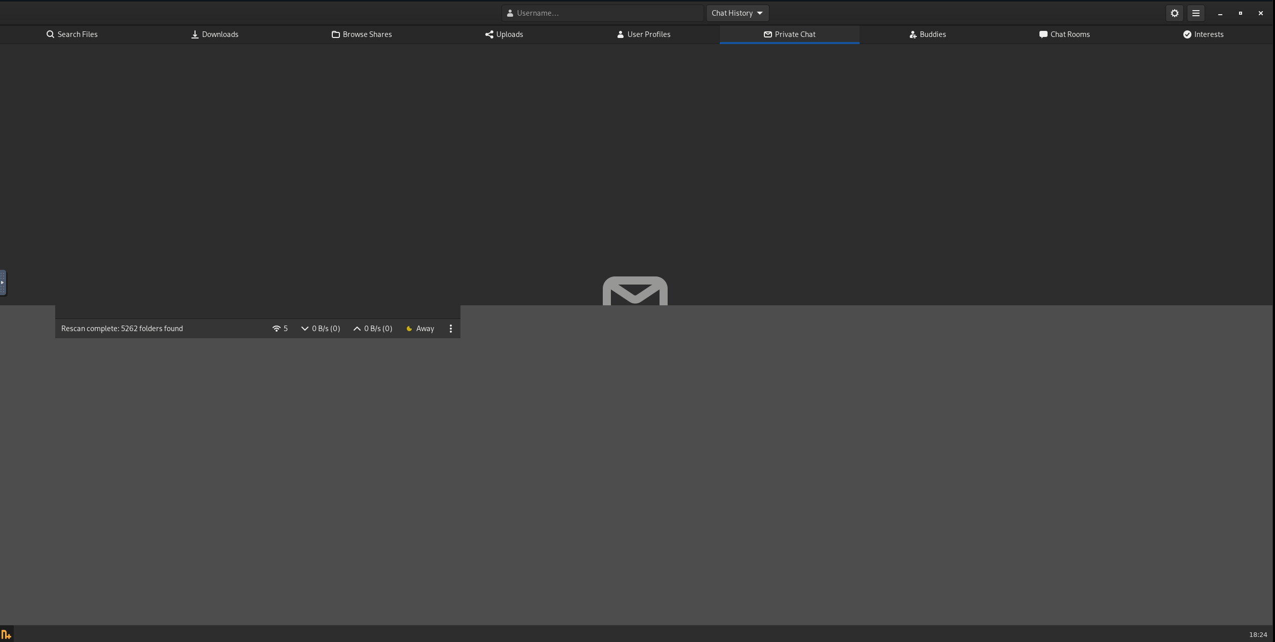

Keek Uras Posted August 28 Share Posted August 28 (edited) Hello. Since the last update, I can rarely access the web interface anymore. I've tried Chrome, Edge & Opera GX. They all open the same (see pic). I have restart the docker several times to get it to load correctly. Today, I can't get it to do it anymore. I've removed the docker, deleted the folder and reinstalled with no luck. Any suggestions? repository-diagnostics-20240828-1833.zip Edited August 28 by Keek Uras strange red line on original image Quote Link to comment
binhex Posted August 31 Author Share Posted August 31 On 8/29/2024 at 12:34 AM, Keek Uras said: Hello. Since the last update, I can rarely access the web interface anymore. I've tried Chrome, Edge & Opera GX. They all open the same (see pic). I have restart the docker several times to get it to load correctly. Today, I can't get it to do it anymore. I've removed the docker, deleted the folder and reinstalled with no luck. Any suggestions? repository-diagnostics-20240828-1833.zip 306.04 kB · 0 downloads This is a bug in tigervnc, for now I've rolled it back to the previous version and rebuilt the image, so please do a pull to pick up the fixed image Quote Link to comment
Keek Uras Posted August 31 Share Posted August 31 4 hours ago, binhex said: This is a bug in tigervnc, for now I've rolled it back to the previous version and rebuilt the image, so please do a pull to pick up the fixed image Thank you so much. That fixed the issue! Quote Link to comment
